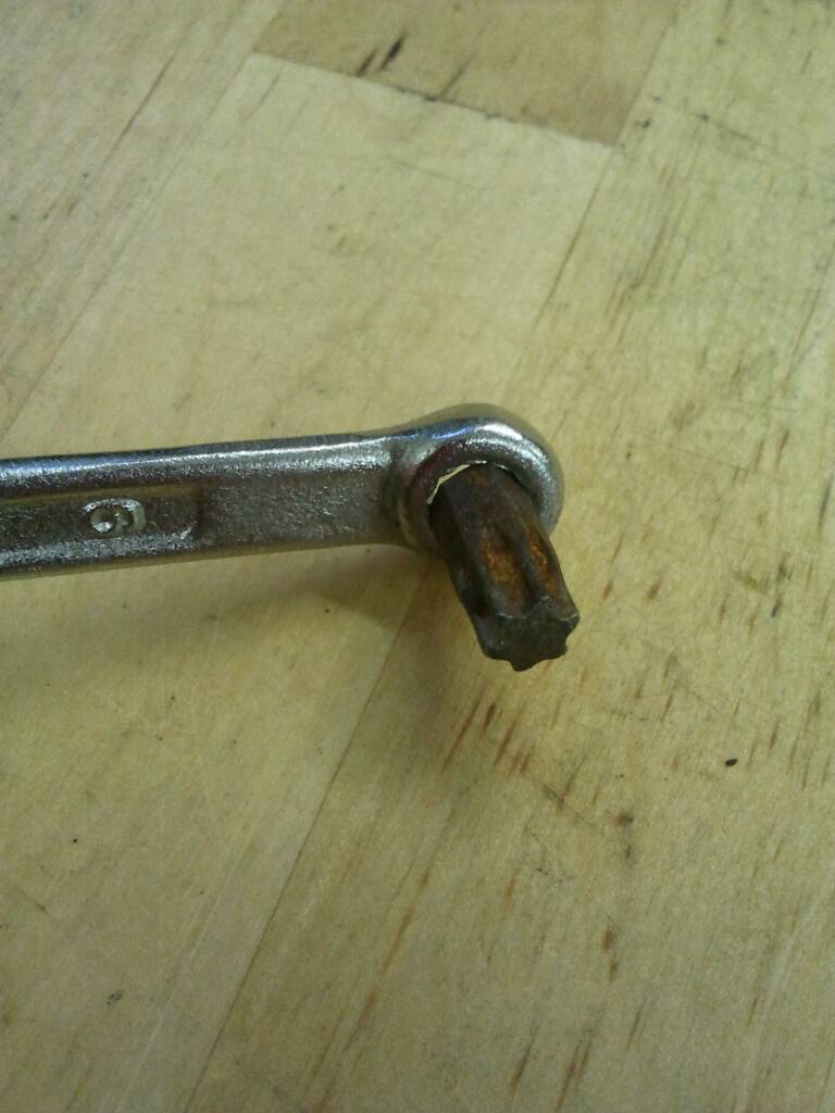

My 2002 multipla diesel has a star drive I had to make a tool from a 6mm ring spanner and a star bit but I had to cut the bit in half with a grinder then hammered the bit into the ring end hey presto I had the map off and replaced in ten minutes, hopefully a photo will attached, a tip how I found out what but it was by wrapping a bit of duck tape round a finger with the sticky side out pressed the hidden but and made a copy in grease ...great forum best I've been on, cheers Bert.
