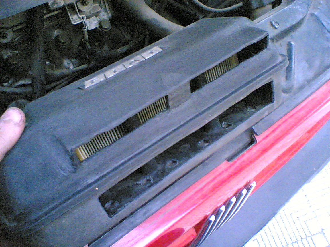

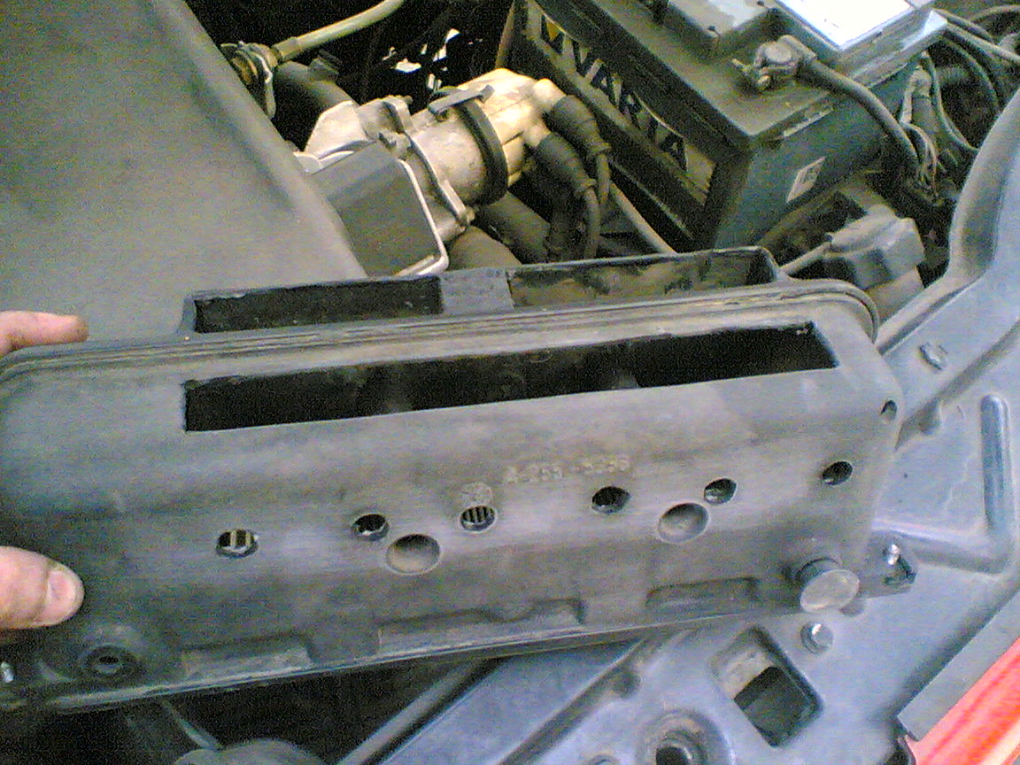

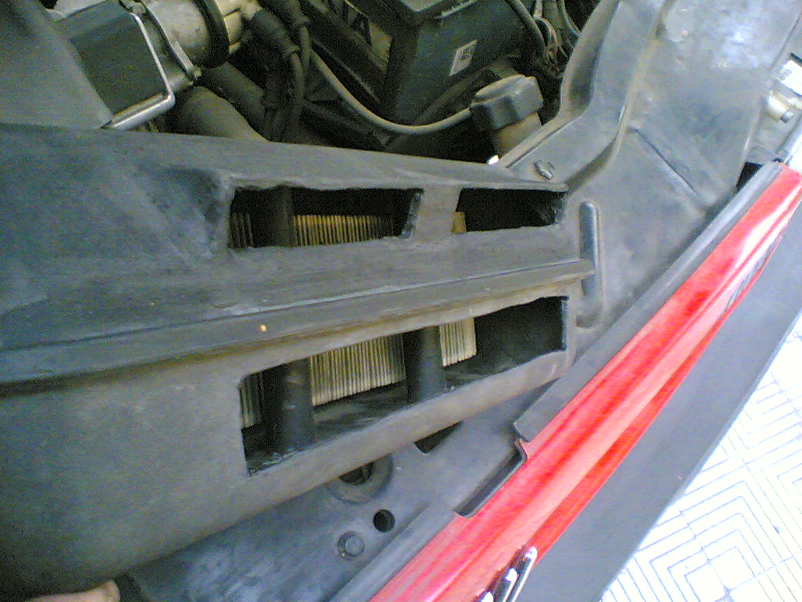

hello
actually i got bored and decided to follow andy`s idea of drilling and cutting the standard airbox until i buy a decent kit+sport filter
and here it is
best regards

sorry for the very late reply, i forgot all about this topic :)
as for cutting and drilling the standard air box, yes it worked, the sound was good and the air suction was ok, but i thought that the standard panel filter was somehow small, it couldn`t provide all the air the engine needed
so i did this
as i said before, i got the carburettor cab from a Tempra engine, it fits perfectly
now the sound is amazing and the air flow is more than great
