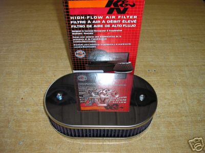

It is a K&N Filter (dont know much about them) . i am attaching a photo (if a manage to do it) so you can tell me what your thoughts are about it...Is it what i am looking for or do i look for something different. I can get it for around 51 pounds UK ... is this a good price ???

The air filter seems ok pricewise - but I haven't checked in ages as to what the correct fitting would cost...
