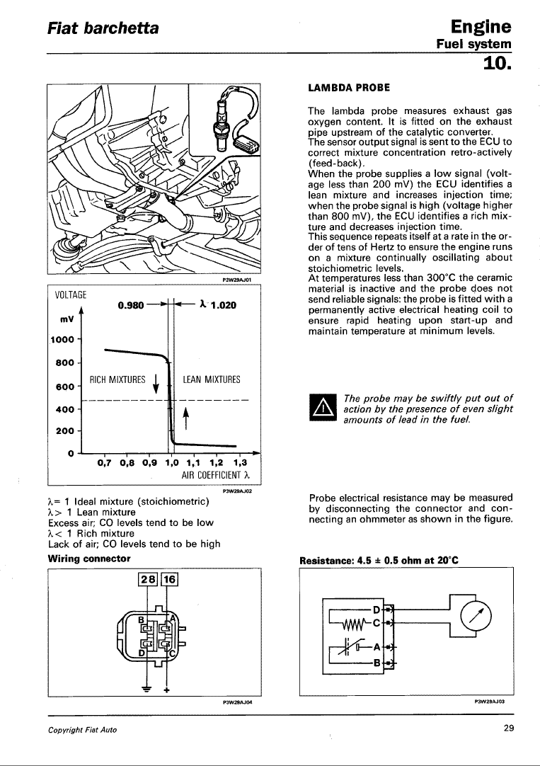

Have you also checked your Spark plugs? Injectors? Lamba sensor?
If the MAF is playing up I would expect it to drive badly, not go over 3000 revs. I think you have a fuel issue.
Check your spark plugs 1st, re-set the ECU - Take of the negitive for 60 sec's, then put back, start the car and idle for 5 mins. Then drive like you normally to.
If this does nothing try fuel cleaner to see if the injectors are dirty.
Let us know how you get on. (y)
Spark plugs are new, and engine is very happy over 3000RPM. How do I check lambda sensor or injectors? I've run Forté fule and inujector cleaner in it twice.
Really appreciate the help!
