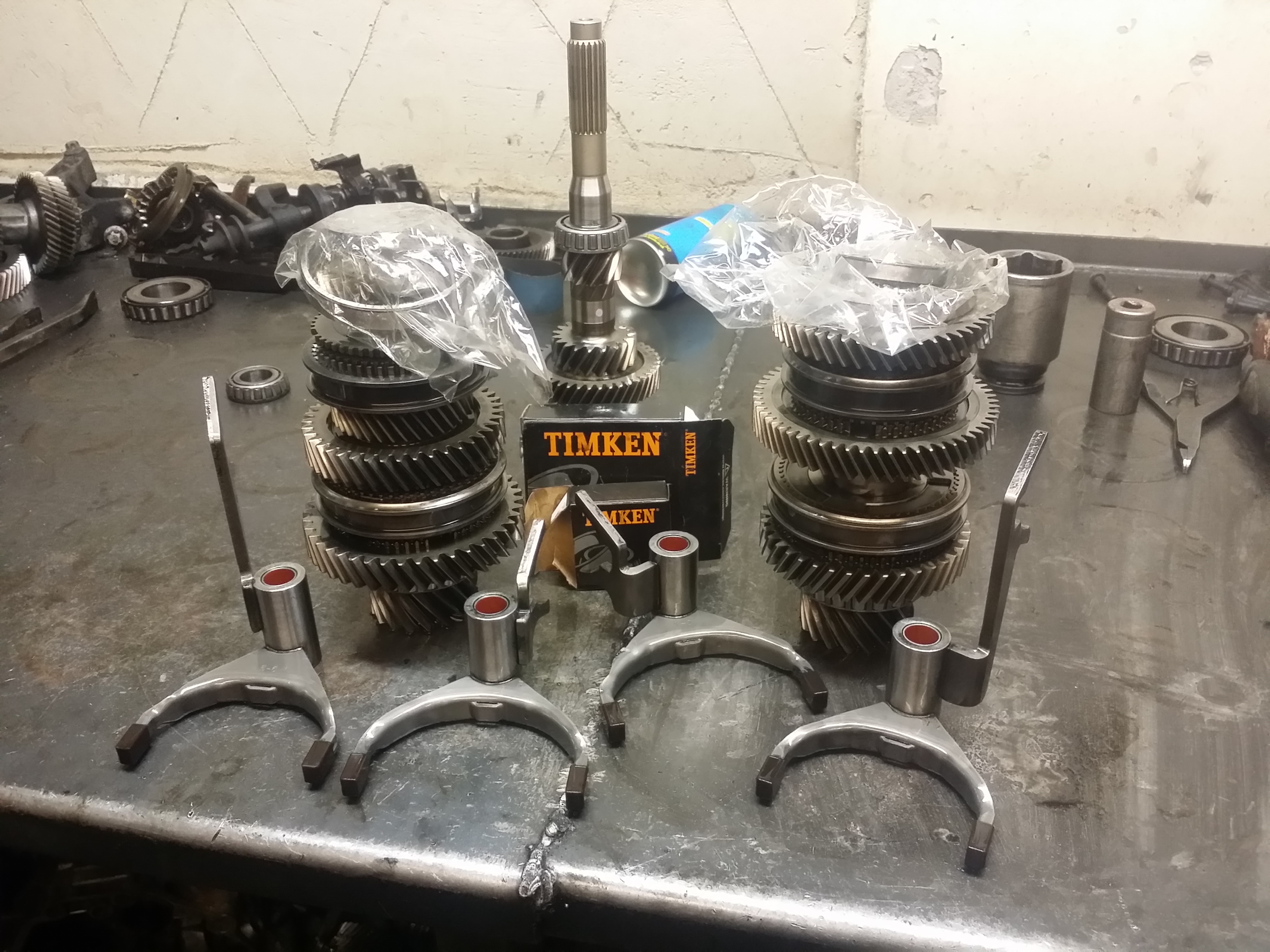

Well finally had my gearbox bearing's replaced today here:
http://halifaxgearboxnclutchcenter.co.uk/
https://www.facebook.com/HalifaxGearboxes?fref=ts
Cost: £480
They replaced all the bearings and then cleaned gearbox and filled with new different grade oil, they also put more oil in than what is specified. They have repaired a lot M32 gearbox's and said that it is overheating that is causing the early failure of the bearing, they also don't use the "upgraded" bearing you see advertised as they have seen them fail after only 11k miles.
They remove the casing cover and then remove input shafts.
Then fit new bearings:
I had an hour drive home on mixed roads and speeds, and the difference is very noticeable! with very smooth gear changes and no more whine in second & sixth gear, so very happy.
