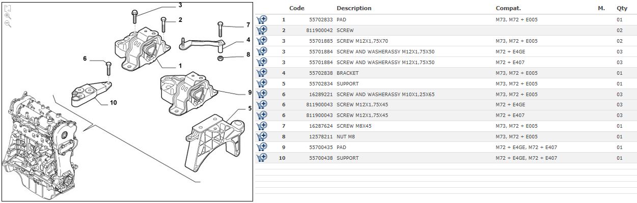

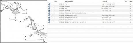

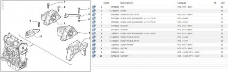

Hi Daniel,
here is what you asked, be aware there are also suspensions at the back of the engine ...
For the GB side You'll need the item #9 since your car is a M72 (90hp) with E4GE option (manual 6 speeds). C510.5 GB would need item #1 ...
BRs, Bernie

Thank You, Thank You, Thank You so much for getting this info for me Bernie, as I've said before I really do appreciate your help!
I'll go and order the parts I need now.
Cheers,
Daniel
