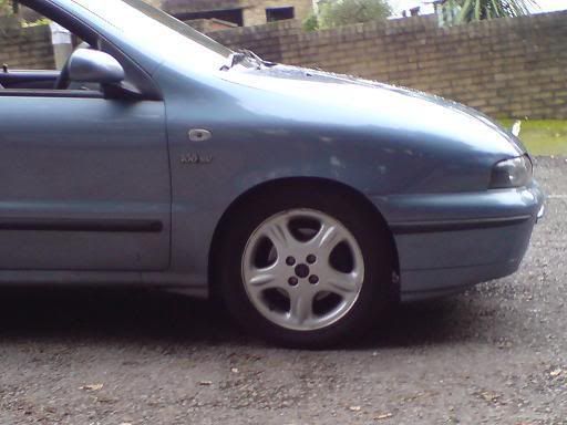

I have an Interalloy kit on my 1.6 (lowered 35mm), seems ok so far, the ride is quite harsh though. I only have standard HLX alloys on aswell.
Is it from Evolution R? Did you get them to fit it? Any pics of how it sits?
Sorry for all the questions but obviously I want to make sure it's going to be a good way to blow my cash.

No, they didn't fit it, I got a local mechanic to do it. Here's a pic:
