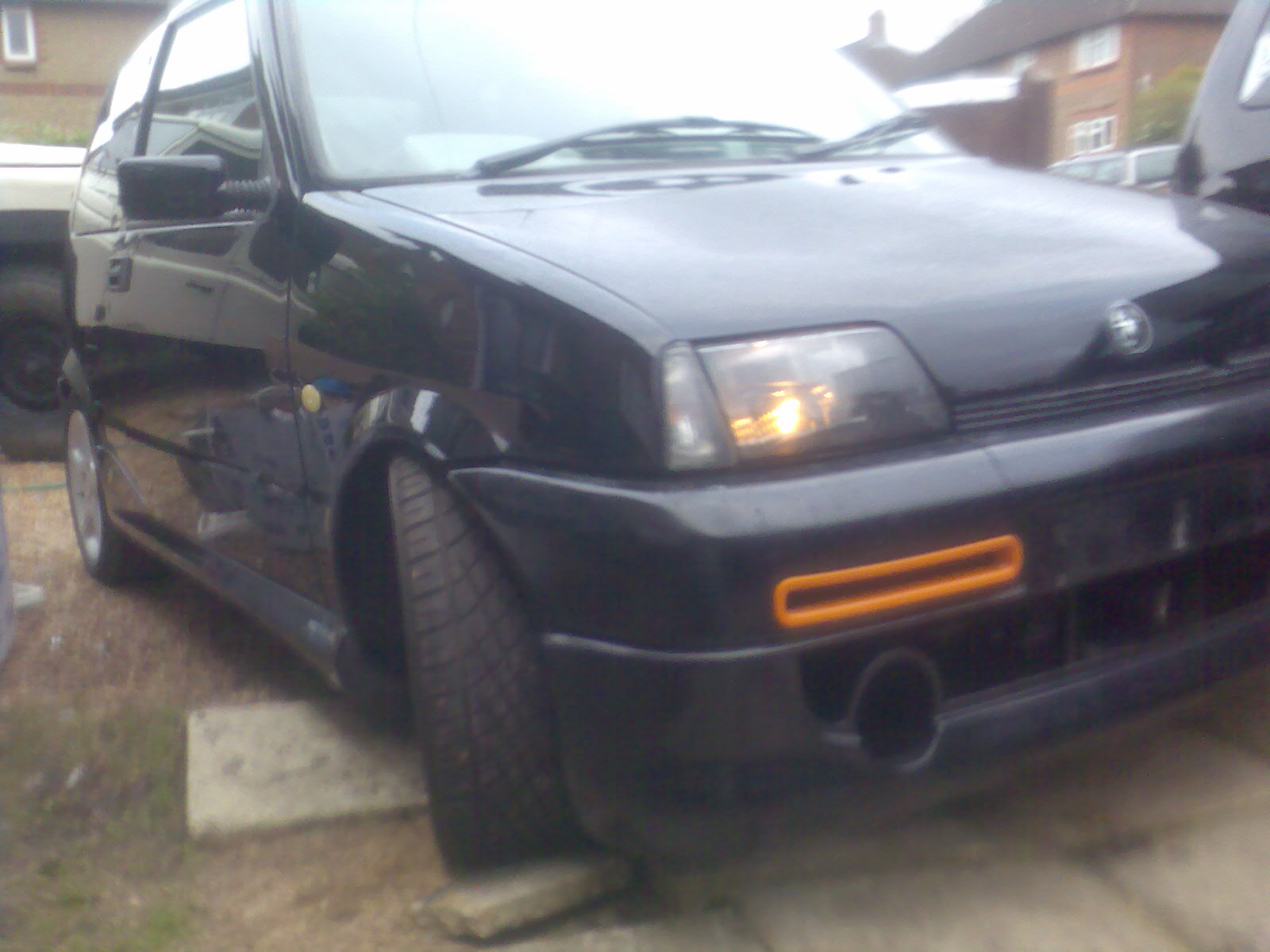

60mm ftw:yum: do the arb, the shocks and dampers if you go that low though......this is a suposed 60mm, scrapes just getting out the drive:eek:
