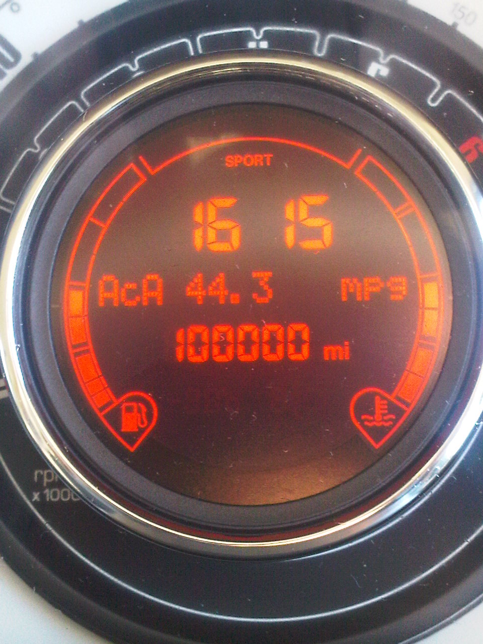

I have attached a picture of 'Nigels' 'test' 1.4 500. To get to this figure and to stay performing with a 'decent' average mpg I'd imagine he changed his oil a bit more than you planned to do.;)
I don't know what you are doing to your 1.4, but I have done 100,000 miles in mine with an open cone air filter that last got cleaned about 40,000 miles ago as I keep forgetting to do it! I get an average of 40.1 mpg and well over 45 on a run, but mine has been tuned as well as exhaust and induction, but it also has huge tyres which means a lot more rolling resistance. And believe me, this car gets driven with enthusiasm!!!
You know i get around 35 mpg but i think what kills it is that i am in traffic all day long in Athens! I took it for a sunday thrash out of town and the consumption was around 40+. Its traffic that kills the consumption = ( So far the engine is fine after around 22k, but it makes a grumble between 2750rpm and 3000 rpm, and i dont know why. It has been doing that since almost new basically but the engine pulls fine and happily revs to the rev limiter! No S/S on my one = (
