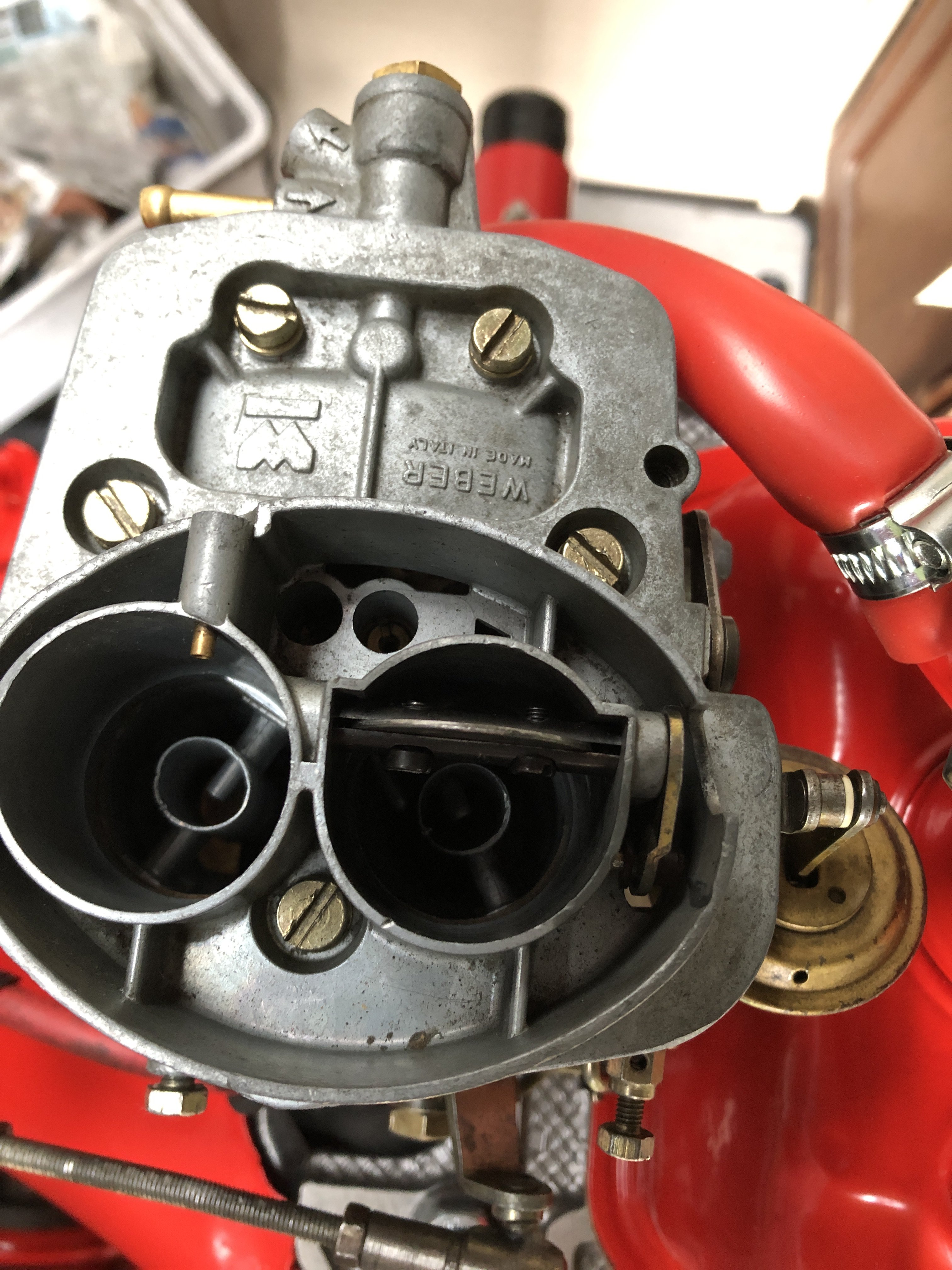

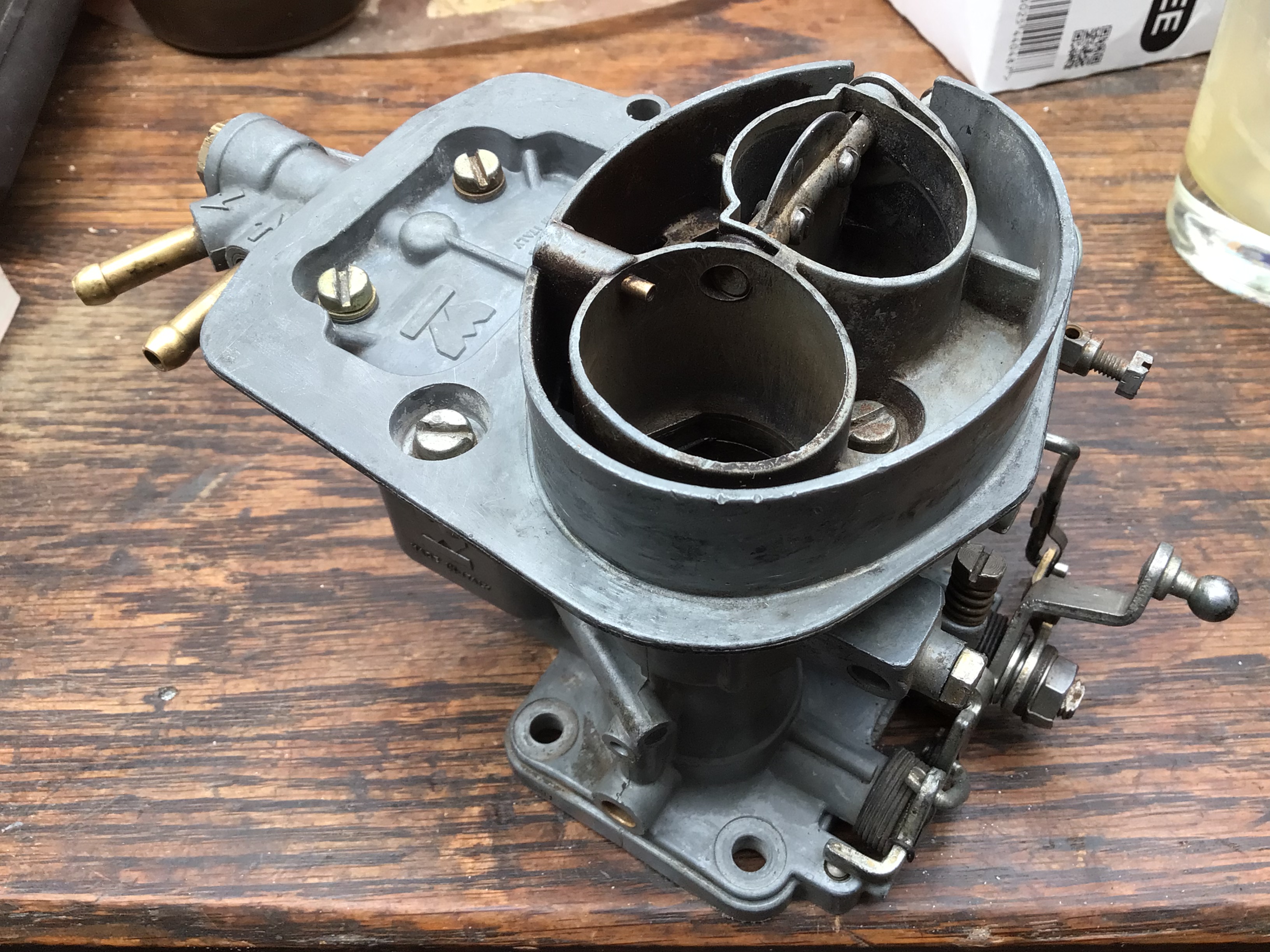

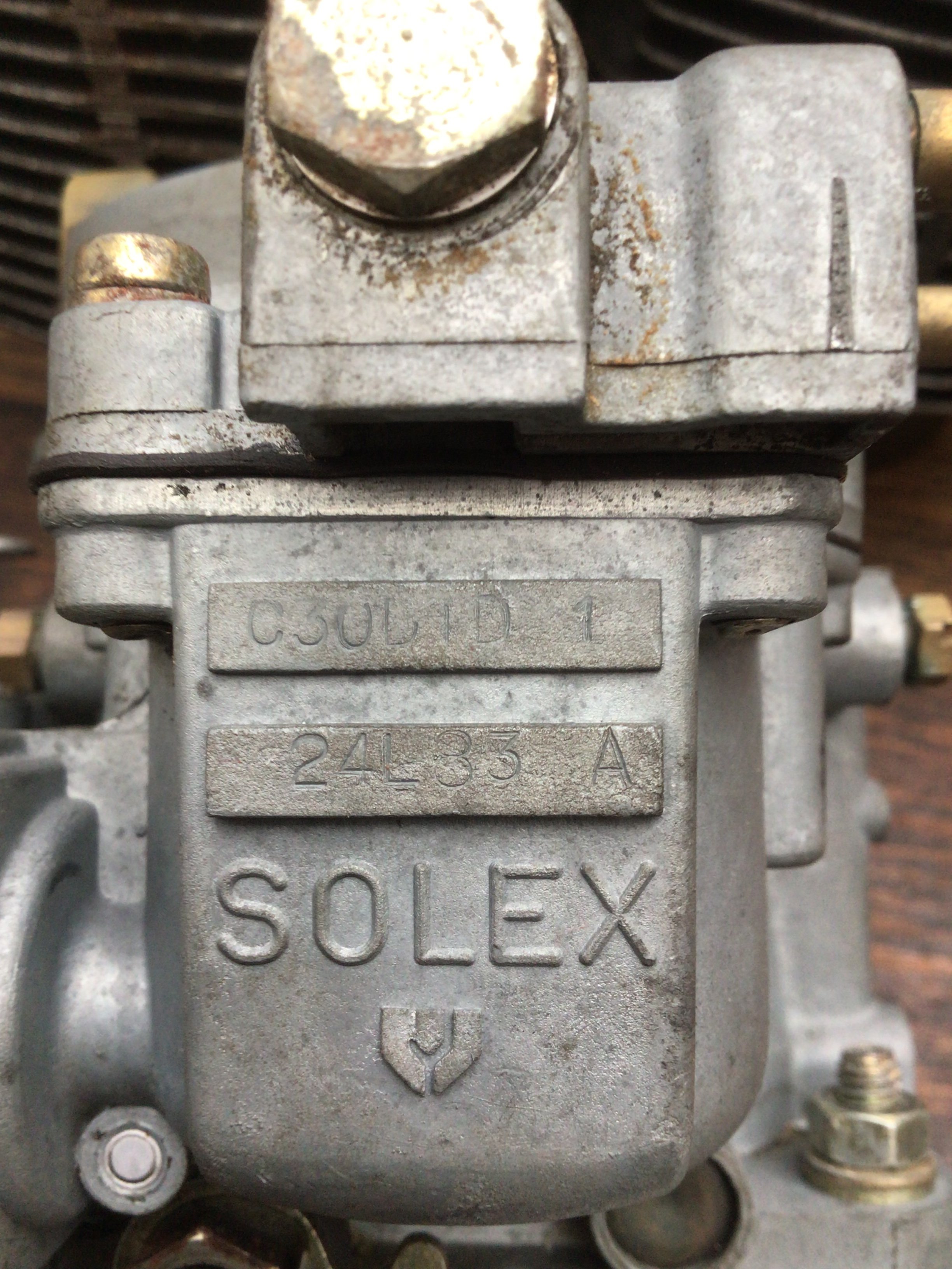

Yes as you say the ones fitted to the Bis had restricted 19mm venturis. I have examples of both the carbs, Weber & Solex, that were fitted to the Panda 30 plus a couple of the Weber 30DIC carbs if you need any pictures or information. C5642494-5743-4D28-810A-CDD3178E27F6.jpeg30F4687D-A350-4692-AA2A-DC4C7AF41C46.jpeg

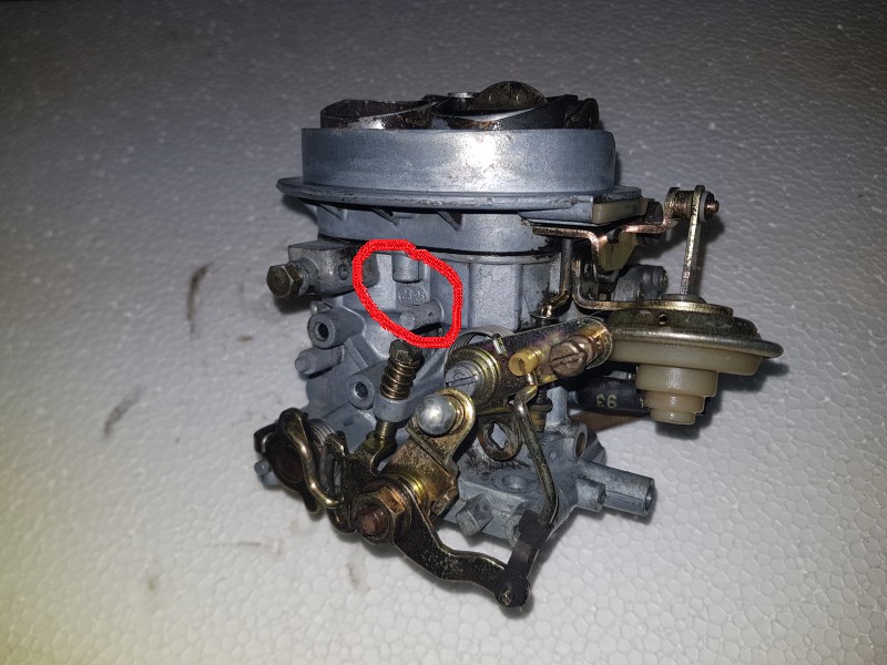

Ok but how i can tell because they look identical, i have noticed at the body of those carbs a number 23 23, is this the venturi size from Panda?
Yes that is correct. The Panda 30 carbs have the 23mm venturis. On the early Weber 30DIC carbs they are 21/23 and then 23/23 on later carbs. Considering the 30DIC carbs were only fitted to the Sport Coupe and Spyder they had many revisions from 1 to 11 then there was a Weber 30DICA which was fitted to the American versions. These were a bit of a nightmare to me as they had all the whistles and bells demanded by the US emission rules. Of the DIC range I prefer the simplicity of the early models.
Problem is that BIS weber 30 carb also has 23 23 stamped on so i am not sure if this number has to do with venturi size or not. Anyway i have asked a couple of sellers if their carbs come from Panda or not.

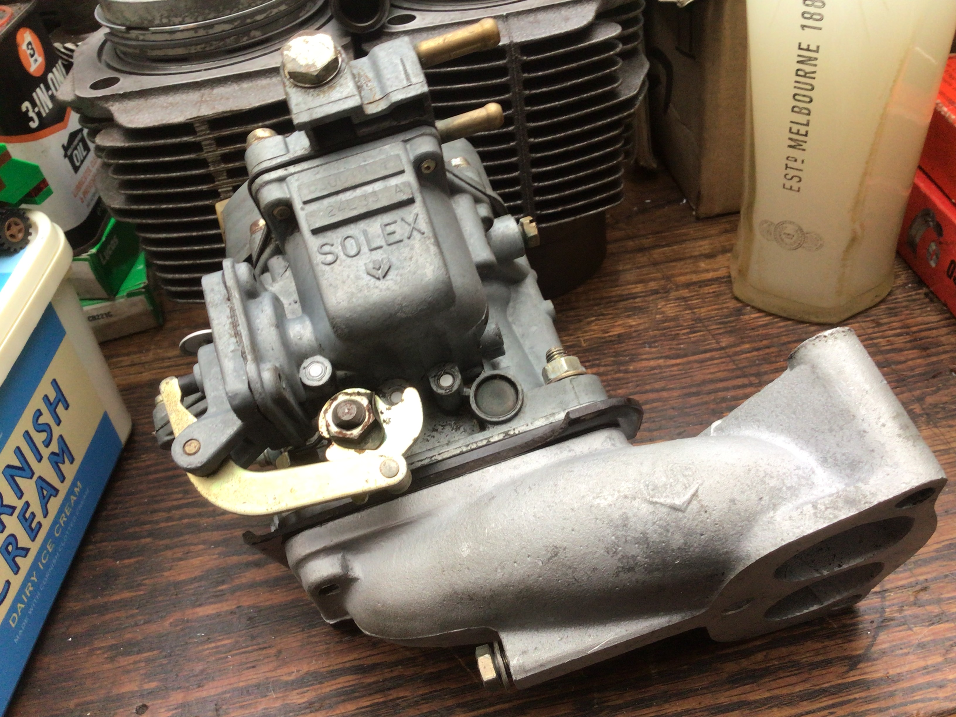

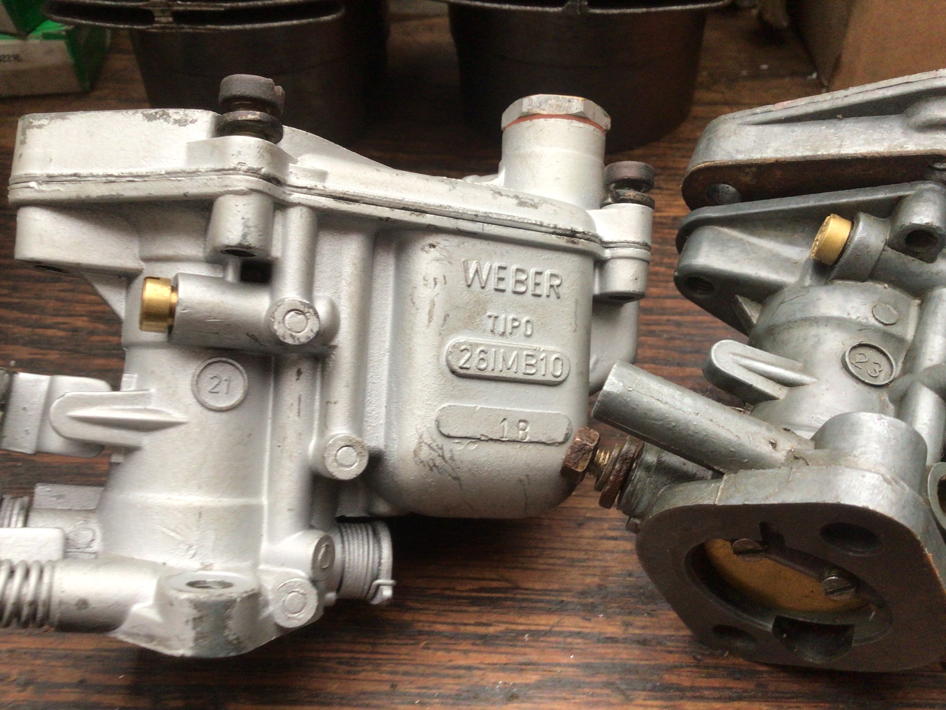

I am wondering if they just used the same main body casting for the Bis. The Weber Venturi sizes are quoted in the relevant Haynes manuals then shown on the carb bodies as you highlighted. Shown below are a 500 and a 126 carb as well as a Solex which is still bolted to the Panda 30 manifold. I noticed that there are three Solex carbs on Italian eBay not badly priced.C96BD4E6-E05B-48E7-B739-5AA952B665C4.jpeg052ABBC1-4F12-47F5-A54D-45779FEE5A75.jpeg56703093-3647-4563-9BBB-92CBCF4070BB.jpeg
If it is as you said, then panda and bis have the same Venturis at 23 mm, but in the real world they don't! I think that number 23 is stamped either if it is 23 or 19mm and differences can only be seen by eye if someone has both carbs in hand. I might ask Axel Gerstl about it.
No because on some of these carbs the Venturi is removable like the 40DCOE. I do not have a Bis manual or carb to hand to check such things.
