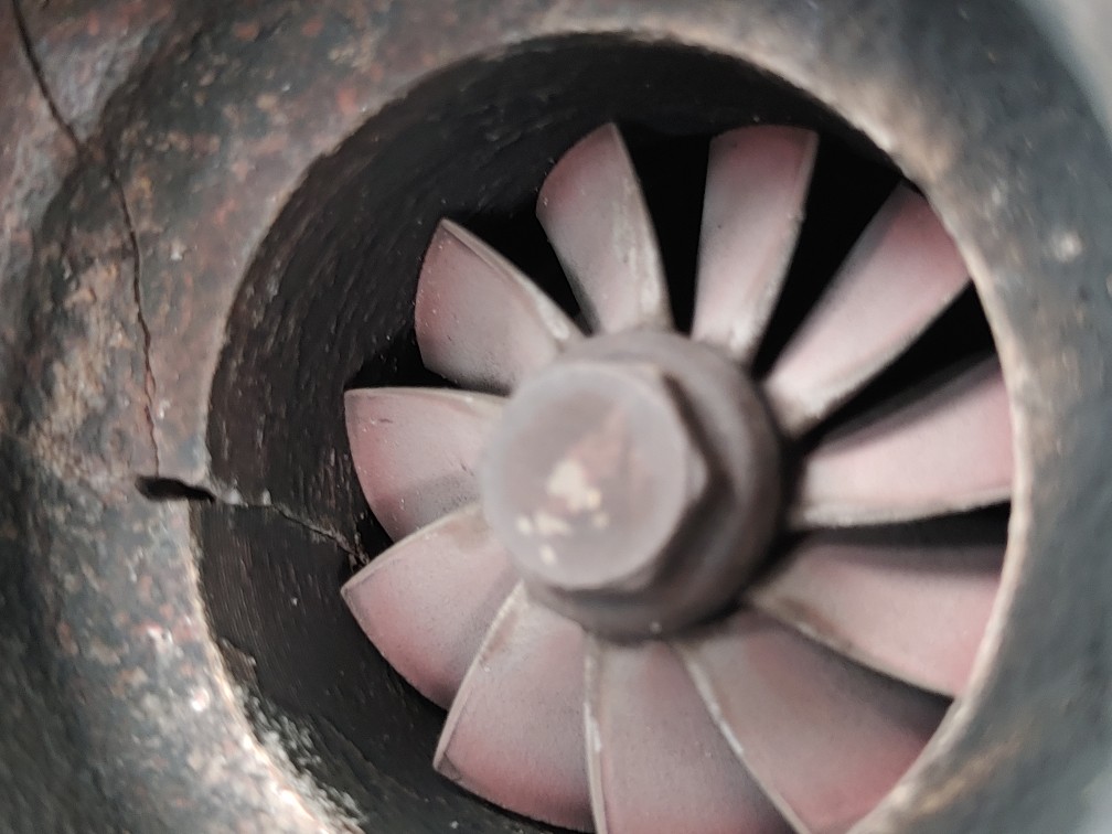

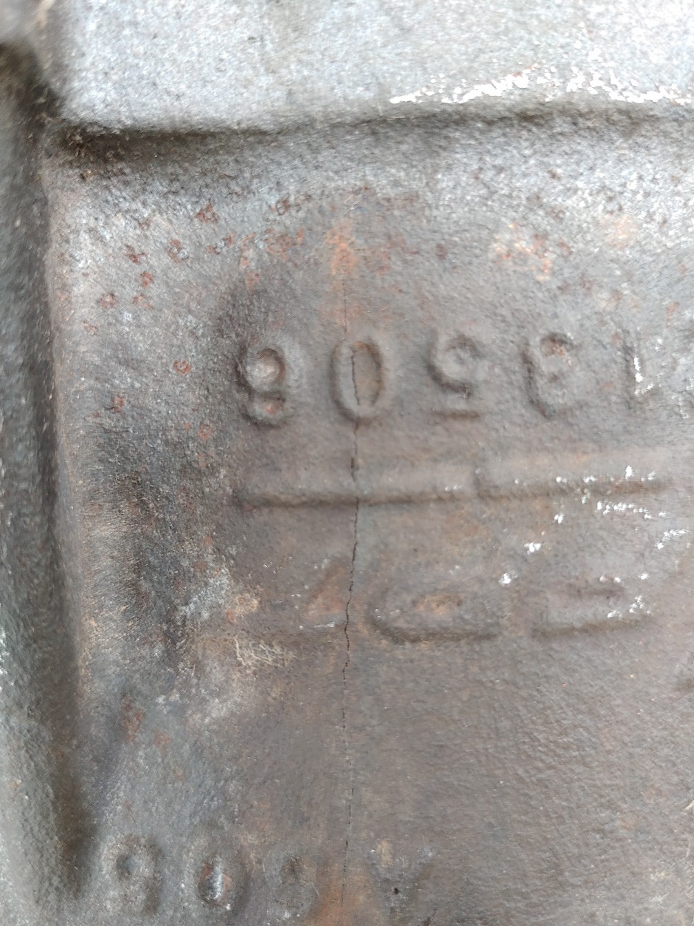

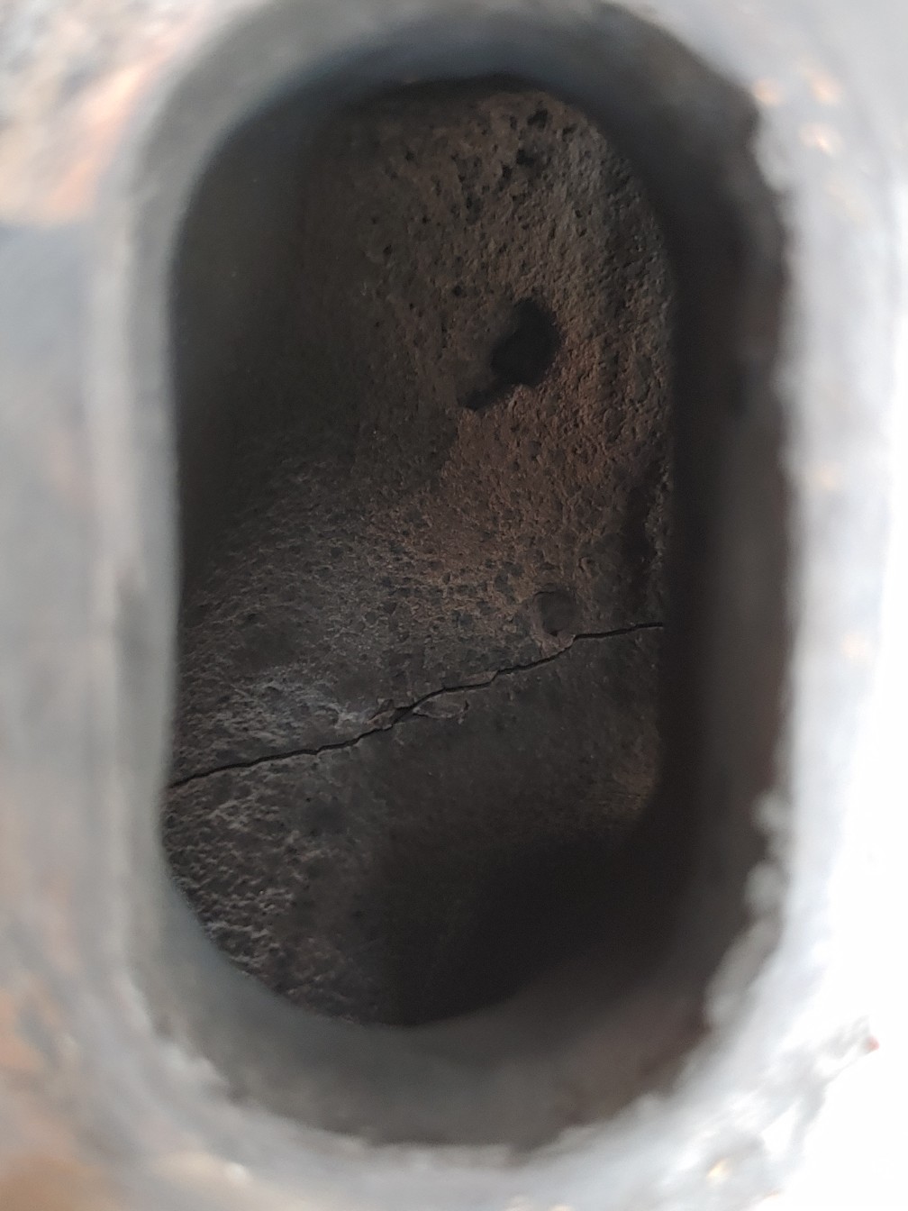

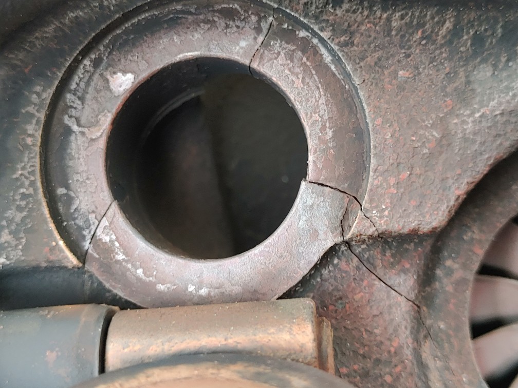

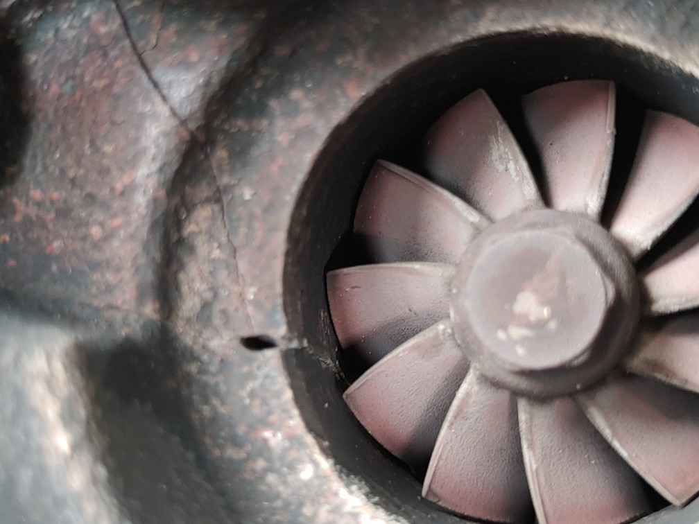

Unfortuantely i've already swapped the turbo and it was right on time. The turbine housing was cracked so much that it almost touched the turbine wheel!
I've swapped it for a used (55.000 km's) VL38 from a Abarth 595. That one also already had some tiny cracks around the wastegate so i've bought a new Armac Turbine housing for it.
See pictures for how right on time I was! In a worse case scenario the housing could touch the wheel and be sucked inside the eninge. Happily this didn't happen.
