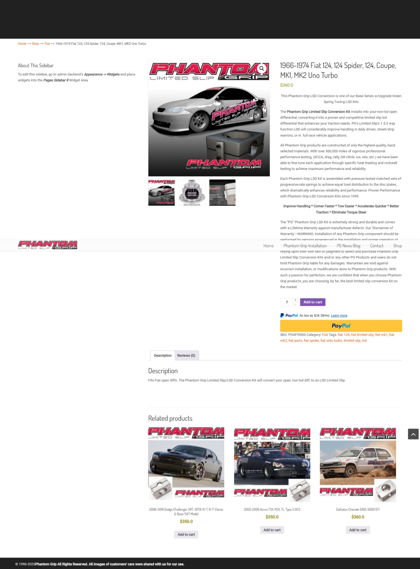

Here's an alternative to a conventional LSD :-
The company's website is www.phantomgrip.com - I've no idea if this alternative to a normal lsd is worth considering.
Personally, if I really needed a lsd, I'd be looking to swap in a rear axle from some other car that had a lsd as standard or for which an lsd is available (e.g. rally version of Ford Escort).
Interesting. I have no idea how that turns your diff into LSD maybe by clamping the pinion shafts? I could see a lot of swarf being generated!
