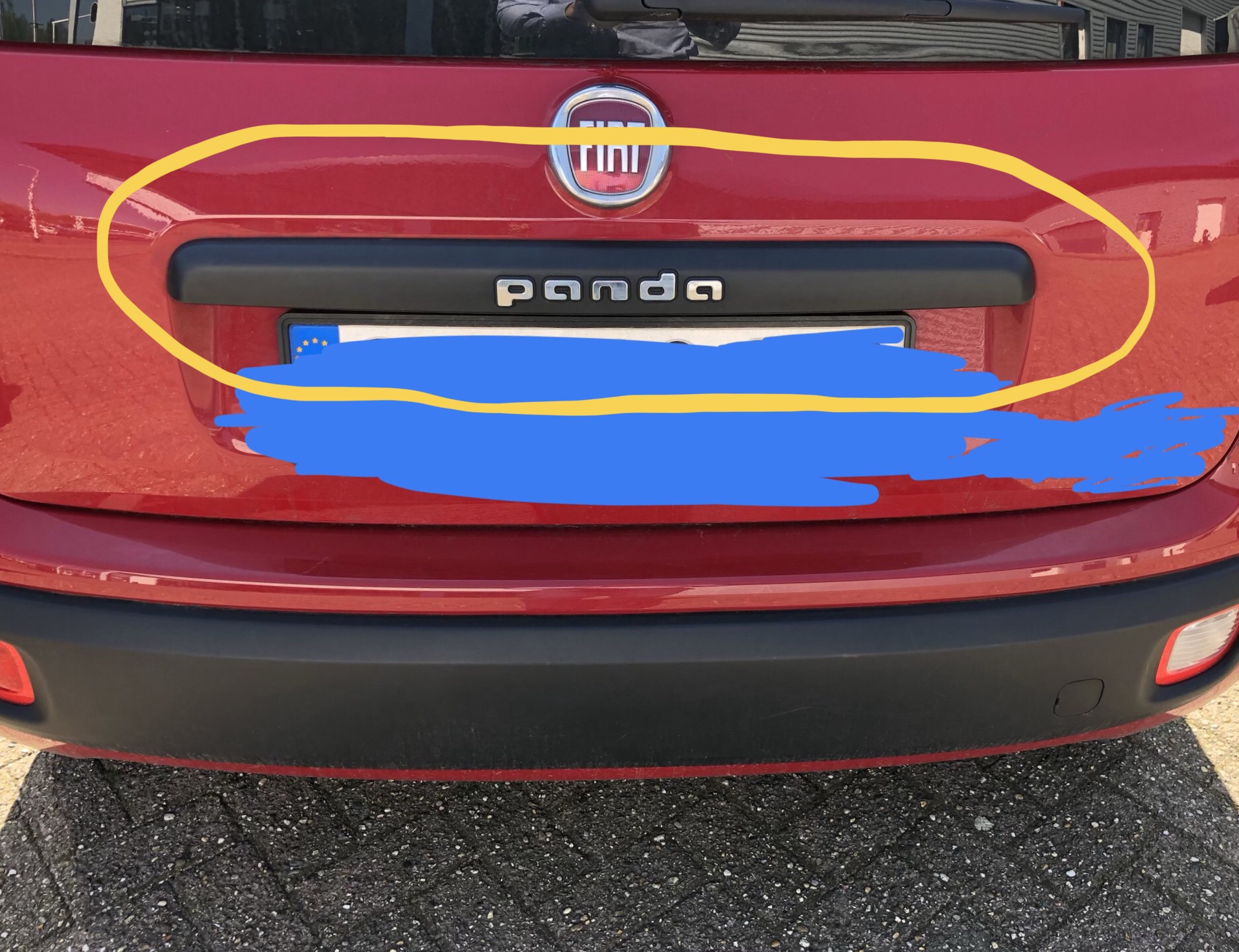

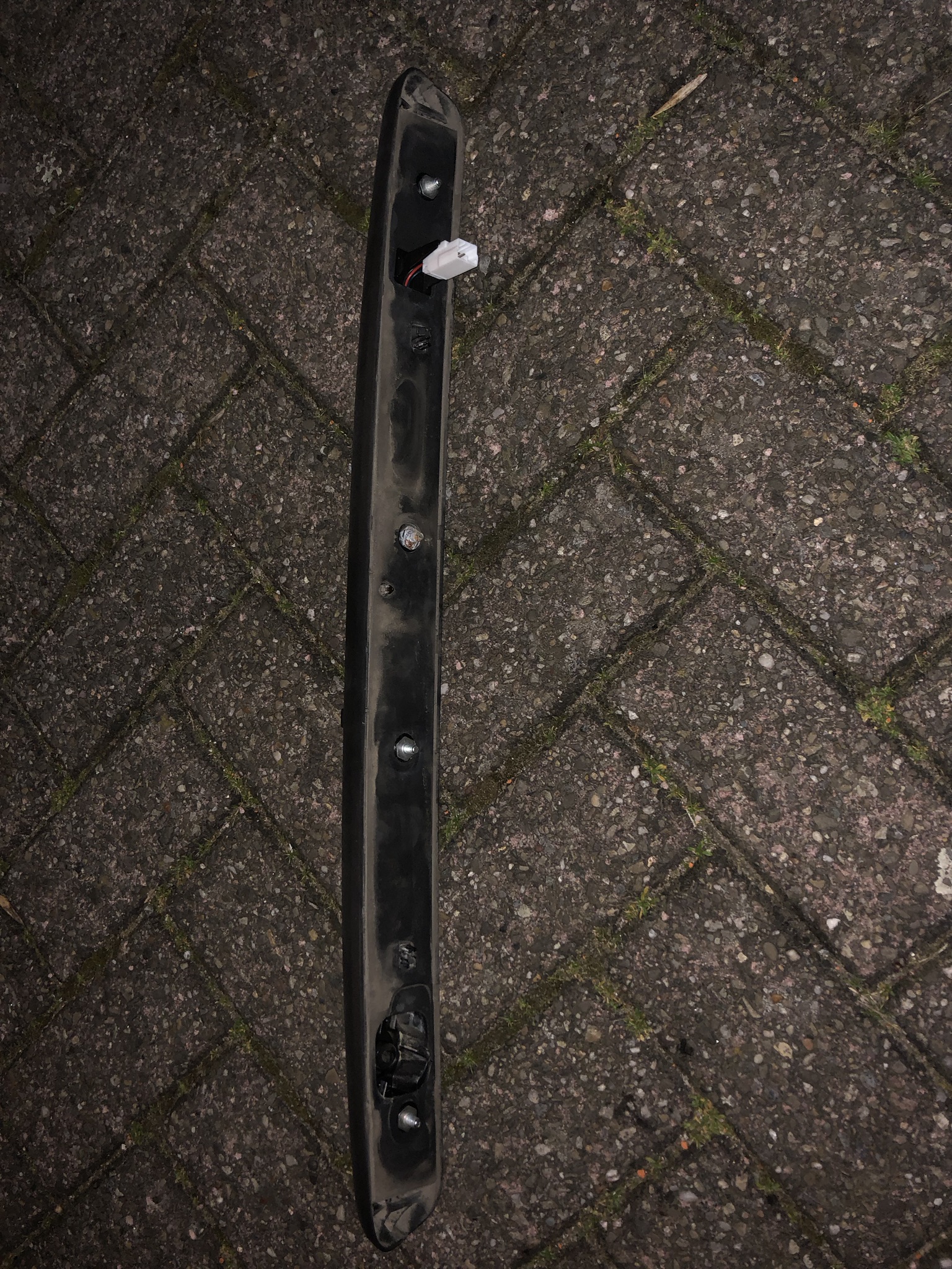

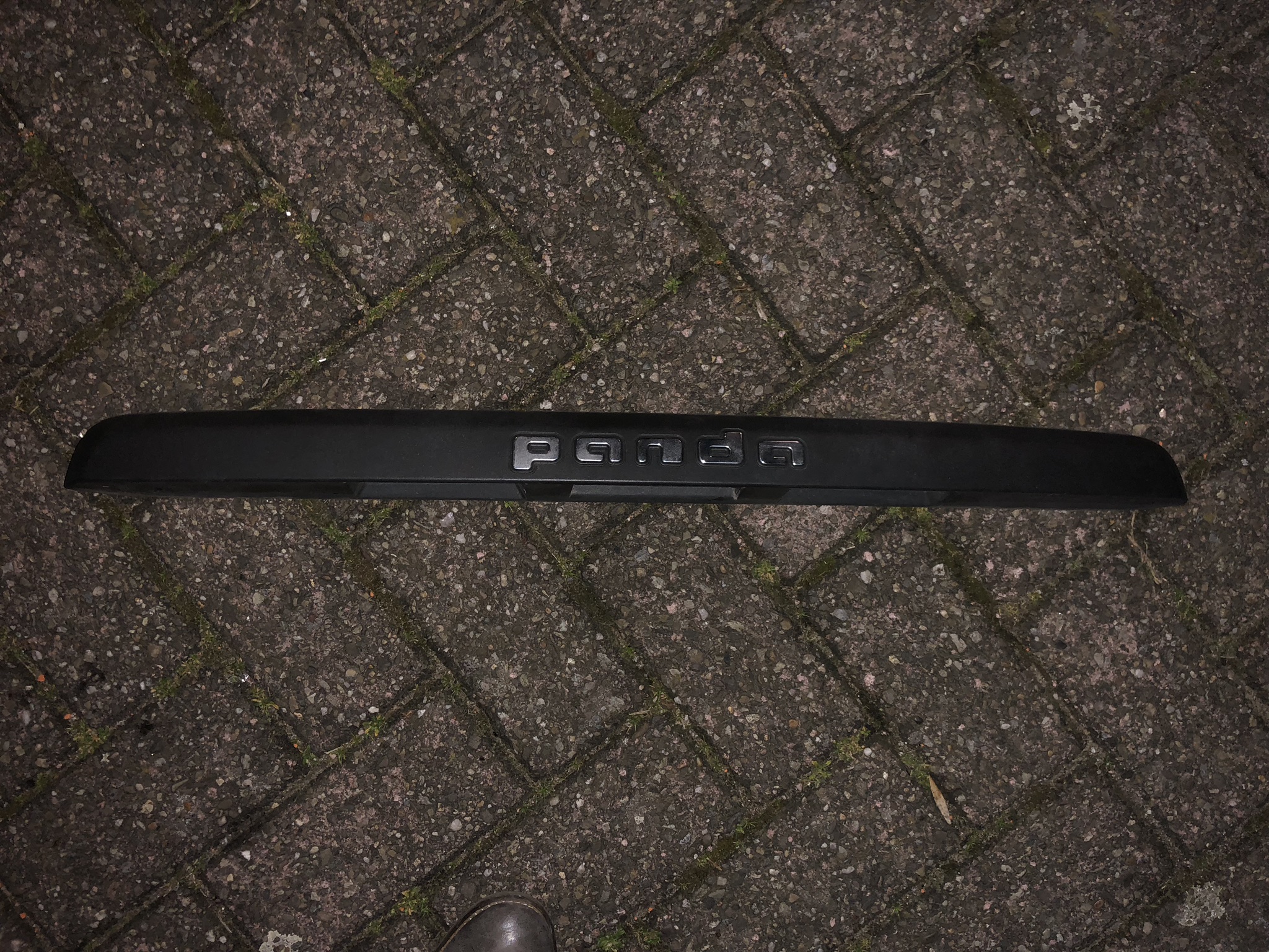

Firstly, I'm new here...so hello to you all :)
I am having an issue with the wiring inside the tailgate trim part where one of the rear licence plate lamps flickers when I go over a bump which causes a persistent warning on the dashboard. I believe it to be a wiring problem inside the sealed unit as I have swapped the bulb and cleaned the contacts for the bulb which didn't help. I'm talking about the part with PANDA lettering on it.
Does anybody have any experience opening this sealed plastic part up to repair it? I took it off and gave it a good look over and couldn't see a part number. Anybody know how I can get the part number/replacement?
Any help would be appreciated :)

I was able to have a look at this today. The issue was definitely inside the light module as it was only one of the license plate lamps having an issue. Turns out taking it apart was possible and then I just cleaned some of the contacts which had a fair amount of corrosion and it seems have fixed everything. I had to cut away some of the foam. I just hope the way I taped it back in place will not allow any water inside.
