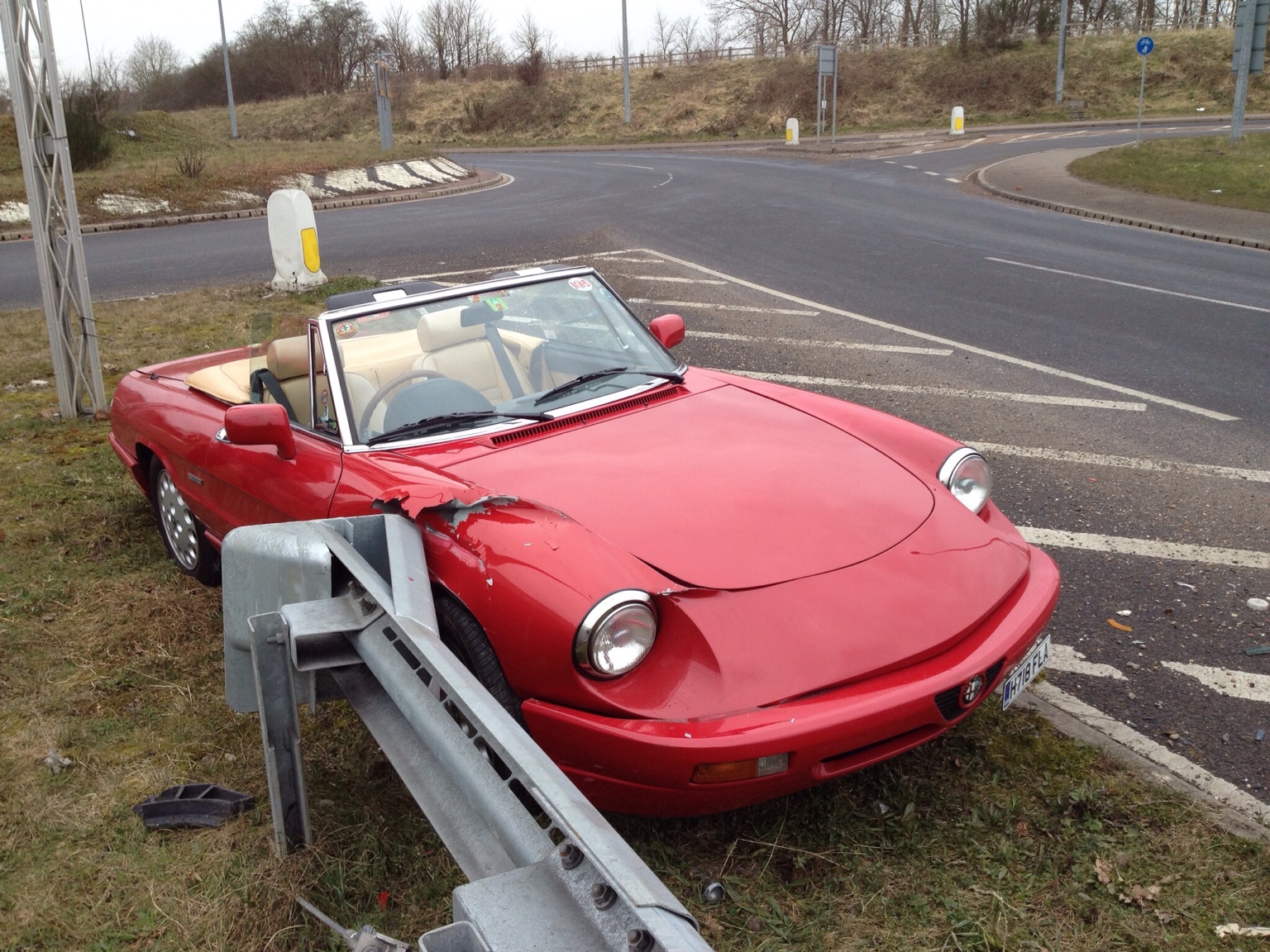

Could avoid me doing this again:-
Ouch!!!!! The Goodyears are fantastic imho - great grip, and surprisingly quiet for an all seasons tyre. They are wearing well too - lots of life left in the fronts, after 18k miles, and the rears look like new.
Nasty! Did you lose the back end? I did a 360 in mine once on a wet roundabout but fortunately no damage bar a dented sump. Not sure GY V4's would have helped you there though.
