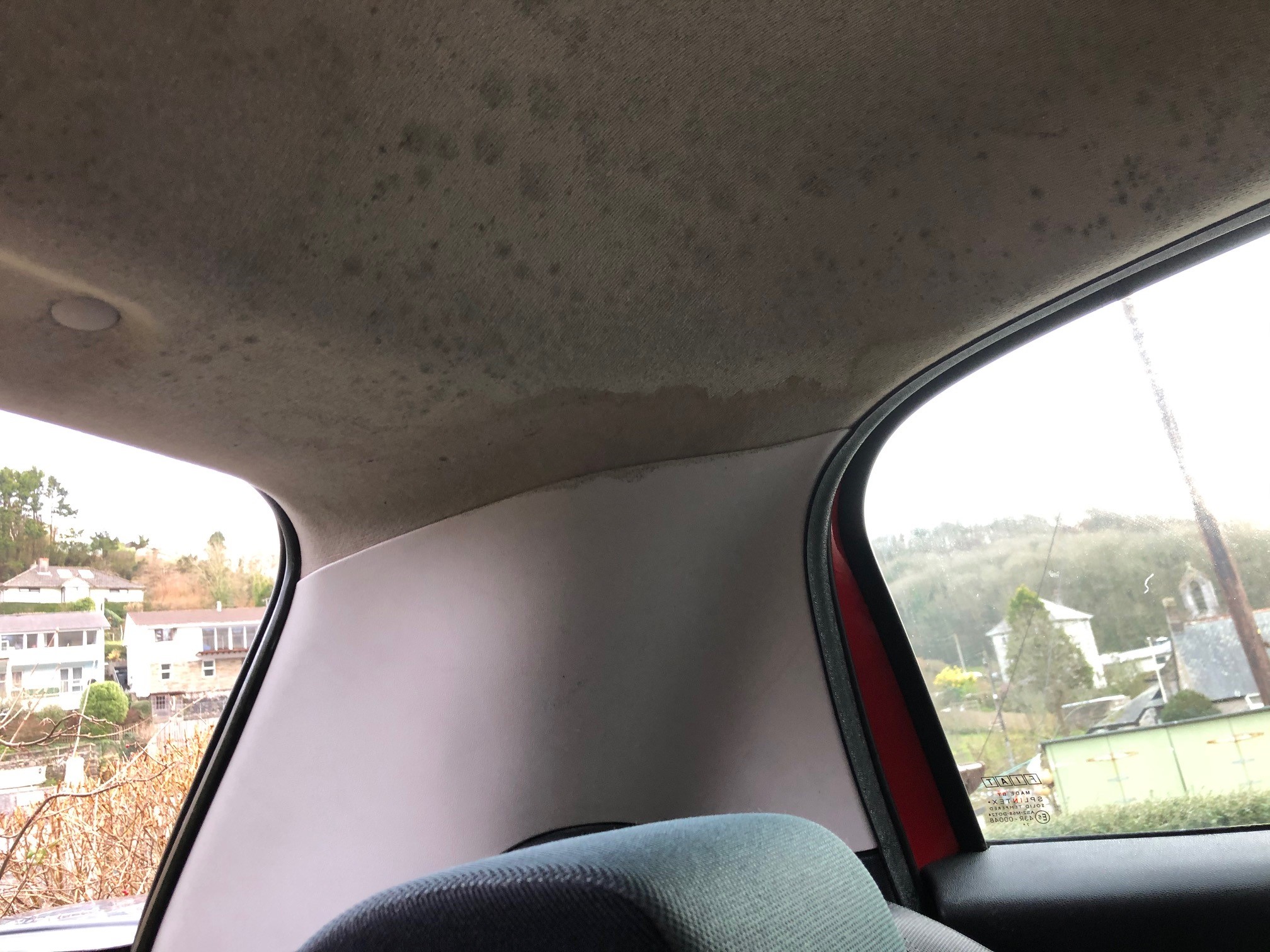

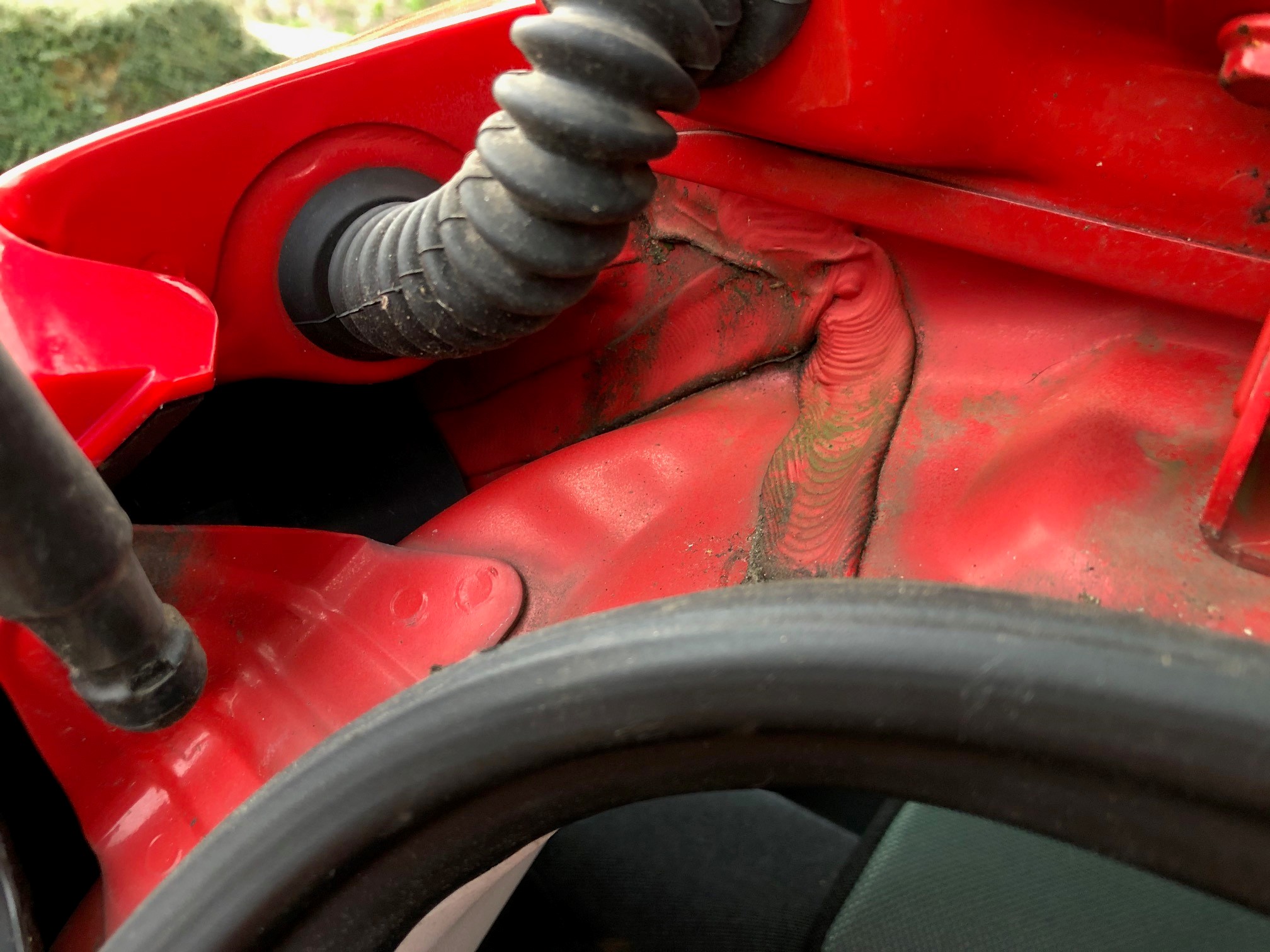

Hi All,
I've had a good look on this forum but struggled to actually find an answer, and some of the topics were a good 5 years old and any photos had disappeared.
Basically, the rear pillars are both soaking wet, and now the dampness/mould is spreading (as you can see by the photos).
I don't think its the door seals as they seem tight and in v good condition.
I've checked around the boot seal, and again, looks good.
It's a normal roof and has no sunroof.
I've ripped half the black strips off the top but looked ok from what I could tell (now I need to re mastic those down, just waiting for the Granville Black Instant Gasket & Silicone Sealer Sealant stuff to turn up any day now).
I've ordered a new aerial seal/gasket (this was in poor condition), but there was no water on the ceiling under the aerial, so I don't think this is the cause.
I've attached some photos, but I'm baffled as to where it is coming from... Any pointers would be much appreciated.
Cheers
