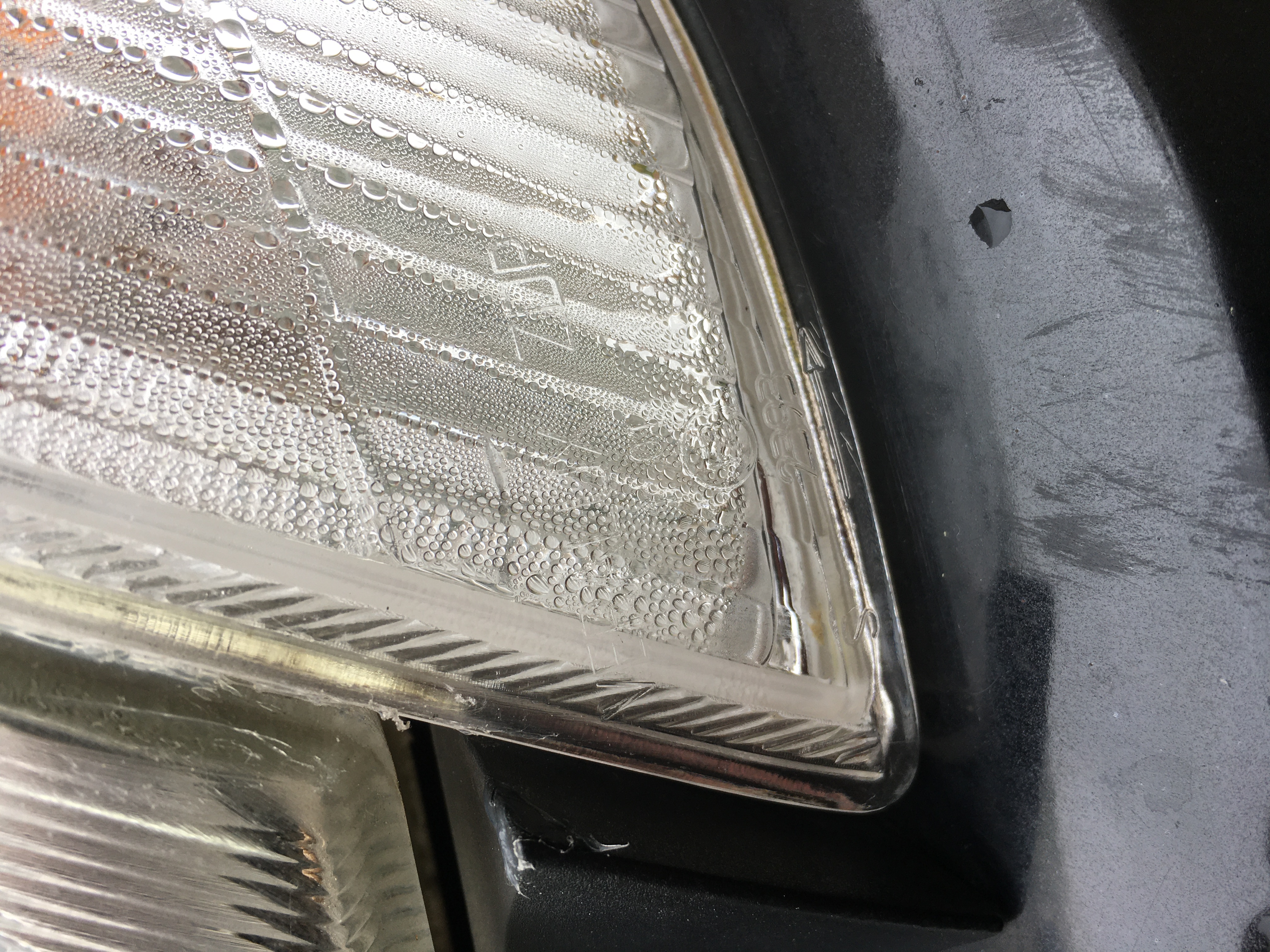

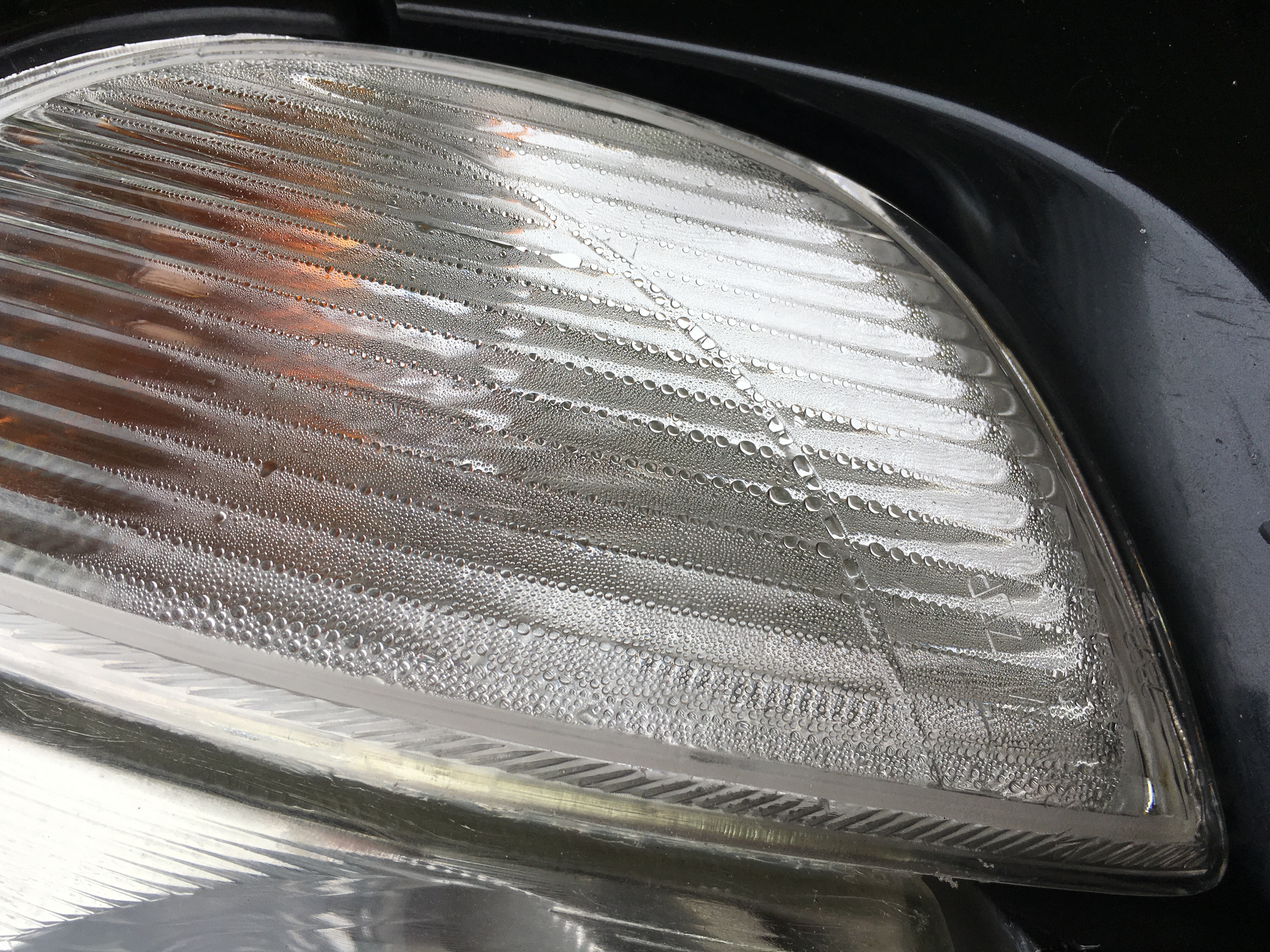

I tried to seal the old indicator lens with limited success. So I did a Google search and bought two new ones for around £20. Having fitted them during the dry period the rain has returned and now the OS one is leaking, despite being brand new - see photo. I will return and ask for my money back as I have to say when fitting them they didn’t fit particularly well and left a smallish gap between the headlight and the indicator.

Do you mean there is water collecting inside the indicator lens at the bottom?
If so I remember seeing a video on the Miller Corner youtube channel where he said that this was a common problem with the Seicento. He drilled a small hole at the bottom to let the water escape.
Yes, I saw the same video. I did that with the old ones, but as I bought some brand-new ones expected them to be watertight. Now it might be the seal but I don’t see how its getting in as that’s brand-new too....
