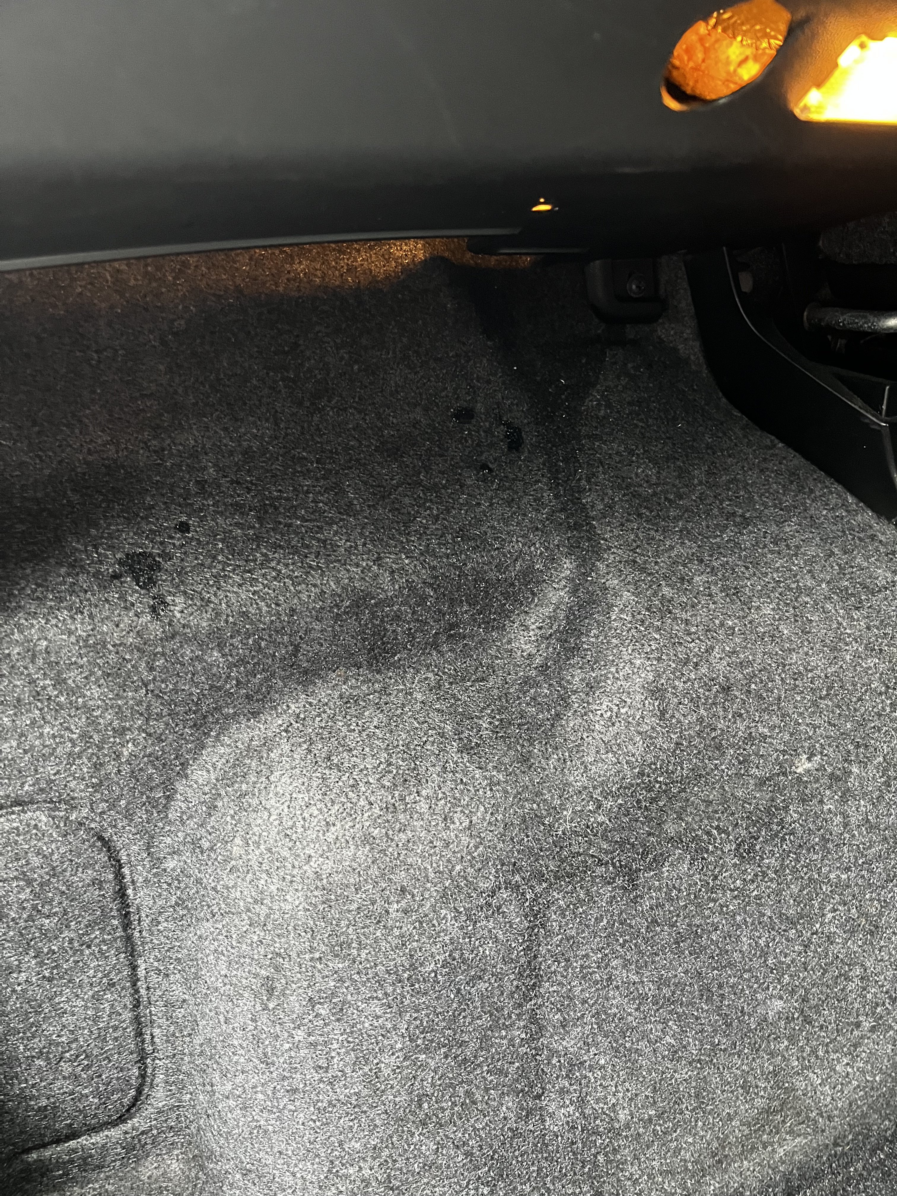

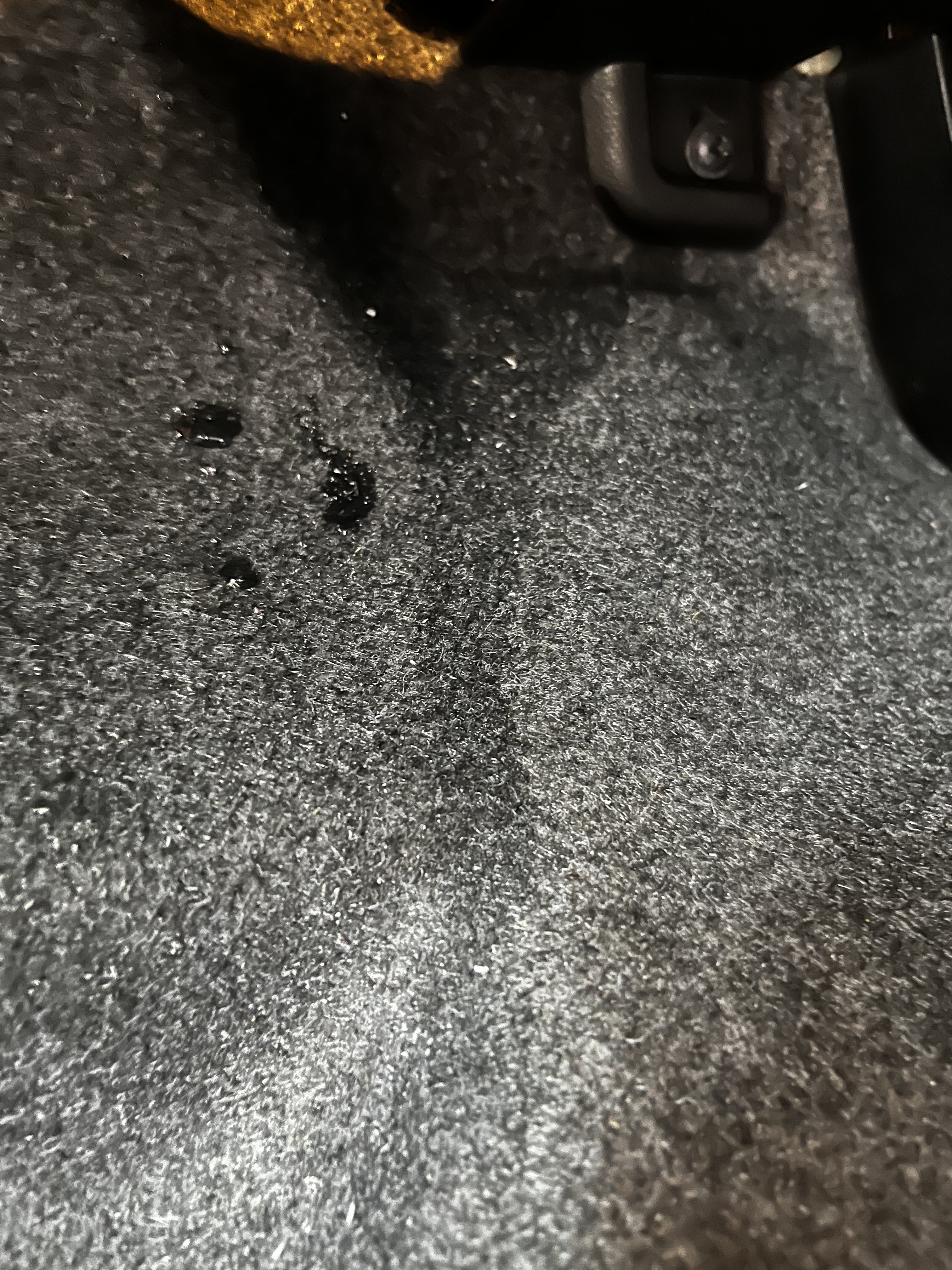

I seem to be having a leak by the left passenger side light, took the light off and there is a slight pinch in the foam, also leaking down where I’ve shown in the photos any ideas would be much appreciated
How is your antenna gasket holding up? If good, check your weather strips if they are all pushed in and holding in tight, I have a 2009 Evo and I've also noticed these failure points, so I've ordered a new antenna gasket as it's nearly completely decomposed and it's 1 euro with shipping on aliexp.
I have a fiat punto evo 2010, I had a terrible leak, i'm talking more than a liter of water in the footwell of the the passenger seat behind the driver seat. It turns out the rear break light bulbs were replaced but the compartment was loosely screwed back on. So maybe open the boot and tighten some screws. This might help.
View attachment 440089View attachment 440090I seem to be having a leak by the left passenger side light, took the light off and there is a slight pinch in the foam, also leaking down where I’ve shown in the photos any ideas would be much appreciated
Had the same in my recently bought Punto Evo 2010. Think it is fixed now. Was the rear light cluster seals that had deteriorated and dirty. Cleaned everything up and added extra foam layer to increase thickness of the seal before putting light units back on.
