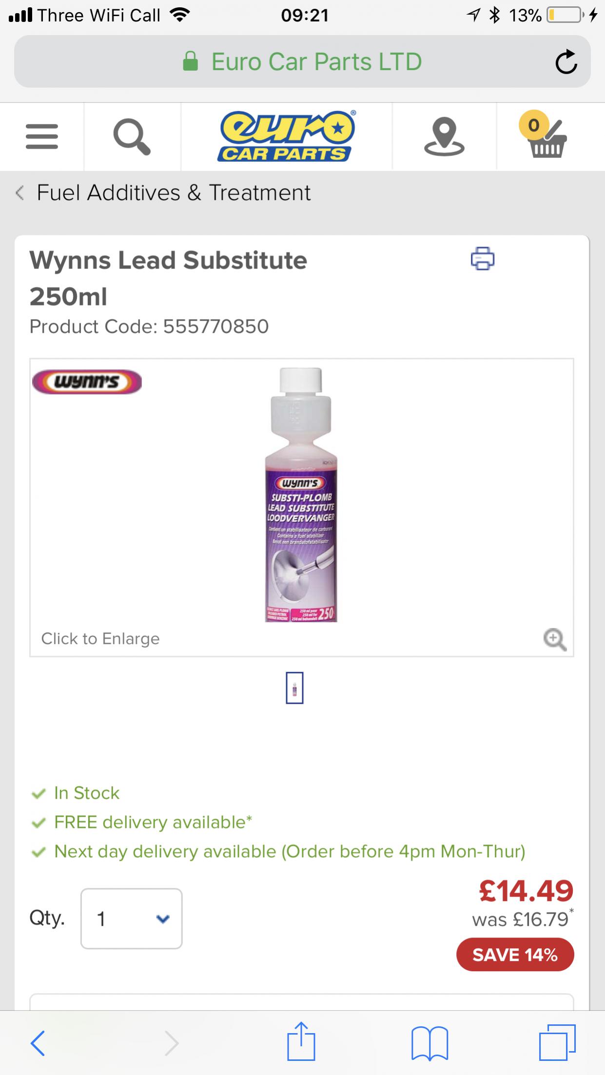

Any recommendations on what additives to use in unleaded petrol? Is this stuff any good? Many thanks

I've used Wynn's for a few years in my 500, nothing to report.
Then I've used nothing for the last two years, same difference but cheaper.
I used a lead-replacement fluid and all it did was to leave lots of deposits on the valves and cylinder-head. The valve seat problem that followed couldn't have been worse if I had used fine sand as an upper cylinder lubricant.
