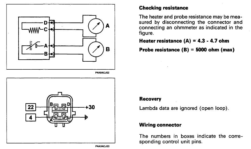

Thats what a lambda sensor should do so its not your problem.
check the heater and probe resistance with a multimeter. remove the black plastic cover at the back centre of the engine bay. there are 2 knobs you need to loosen to remove it. behind that cover you will find the lambda sensor wiring connector. disconnect it, and then use the connector to test the lambda sensor. make sure you use the correct side of the connector, you need to use the side that has the wires surrounded in a white sheath, this is the side that goes down to the lambda sensor.
the following pic gives more detail.
Jug,
I tested the heater resistance and is correct. If I connect the lambda to ECU the lambda tester show a movement of led from 1 to 5 constantly.
