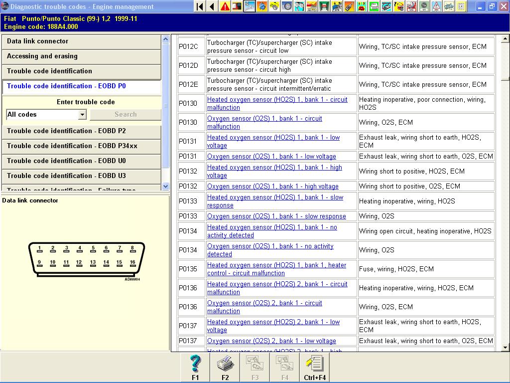

switch them and check if it will show other error code

I forgot to mention that I already tried this. First it only gave the p0135 when I switched them. After awhile it started to give again only p0130. I also started to take the battery cable off to "reprogram" them. First it really sailed on the idle but then it went back to normal after I had driven awhile. However it still feels that it doesn't have the full power always and the error code P0130 comes to the memory every time I run the engine. However it doesn't light up the engine light. It also seems that when I change speeds it always takes a moment to get to good fuel economy (if the Computer on fiat shows it right). This could probably mean that the lambdas doesn't react so fast anymore?
attachment.php
Hi mate, could you use your fancy bit of software to tell me what the code P0420 relates to?
