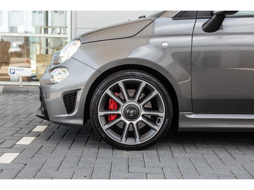

What is the General assessment of the KONI FSD shocks.
My Turismo has them and i already change the Eibach springs to H&R.
What in my opinion has improved the ride quality somewhat.
But so far i think the KONI FSD shocks are only OK on perfect roads.
Everything else and i think the ride quality is terrible, nothing get absorbed at all.

The Turismo does not have Koni's fitted in the front, they are Cofap shocks with a Koni FSD valve. People see the Koni FSD valve sticker and assume they have Koni's. I did the same with my 695 XSR but on changing the springs front and back I confirmed it and after emailing the manager at Koni U.K he also confirmed their Turismo demo car has Koni's on the rear and Cofap with Koni FSD on the front. [emoji6]
