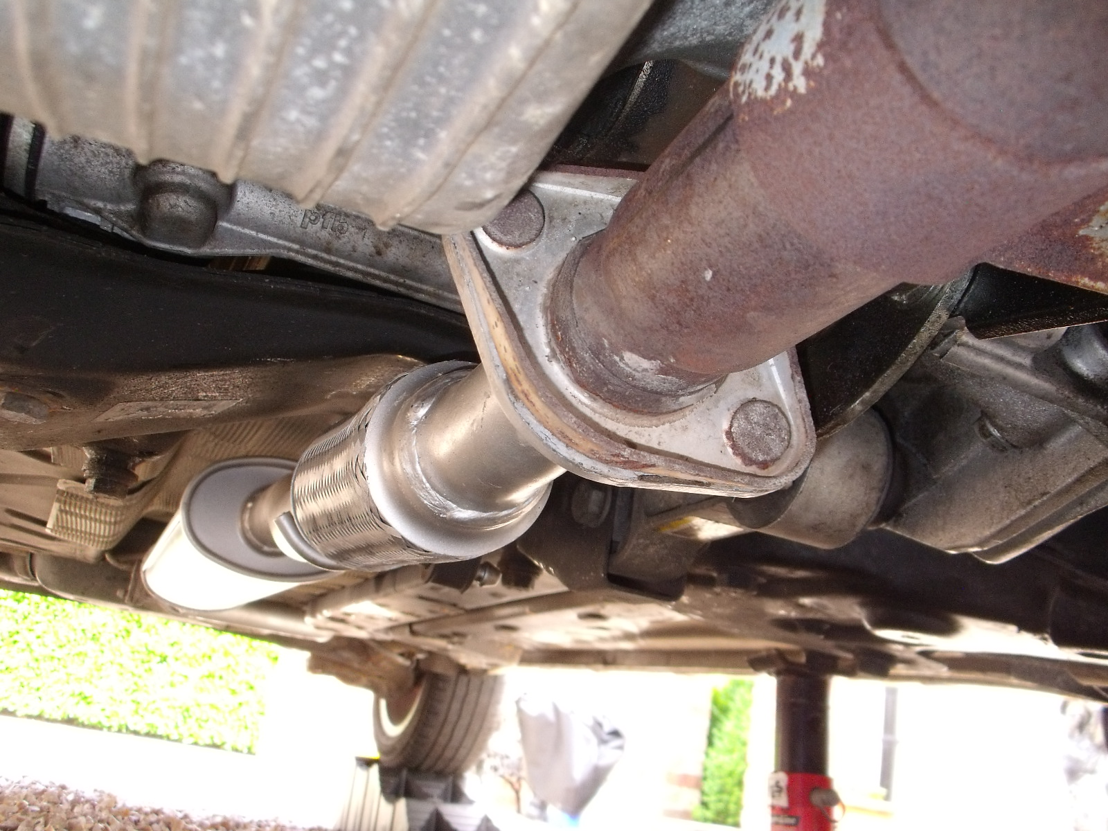

Picture of mine but is a 1.4s but lots of room around centre pipe area even with intermediate box. That's why I say look closely at the rear end around where pipe of rear box sits near rear beam

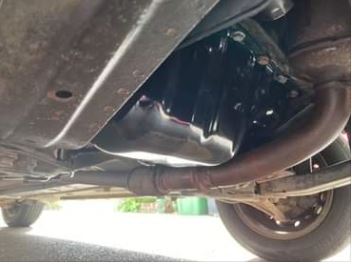

Raputin, the Younger Mrs S' 1.2 Pop has a pipe that fits into the tunnel quite well.. as below... but that seems to have been achieved by putting a crease in the pipe which you can just about see in the photo of the sump. A new pipe I bought for it (waiting for that flexi to fail) is straighter and has no "crease" so it'll likely hang quite low compared to where it is now.. but as long as it's higher than the bottom of the front bumper, it's out of the way enough.
