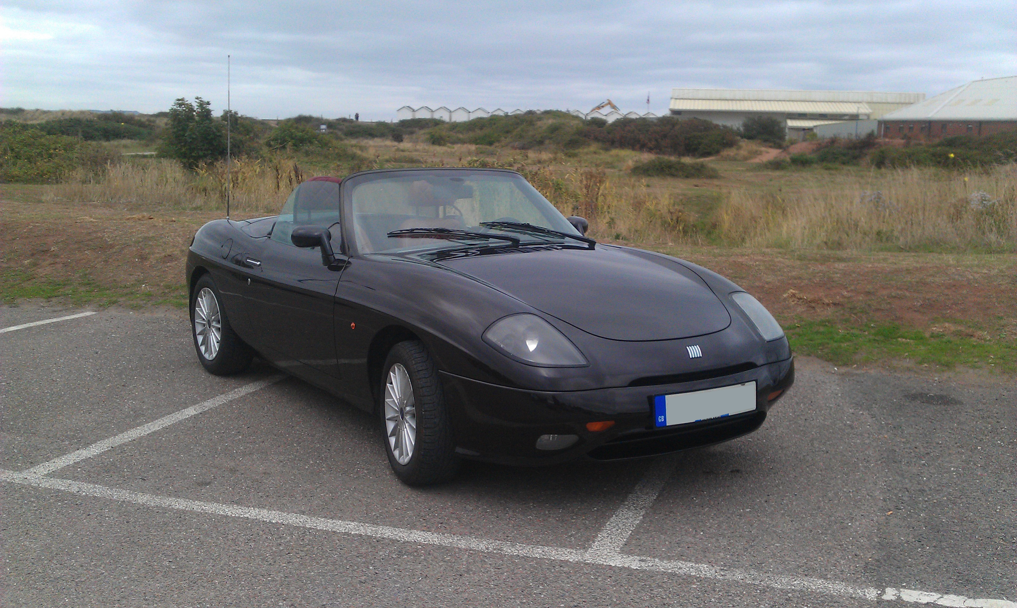

After installing the new clutch I've been out and about and felt confident enough to take a photo down at Dawlish Warren today to post up.
It drives nicely and having worked on the front end it feels much better than it did when I picked him up over a month ago, air in the tyres helps.
Gave it a good wash this morning, polished the front end but couldn't wait to get out so even though the hood was still a bit damp I was off!
Its great zipping around Exeter and brilliant out in the country lanes although I was caught behind a caravan so I had to turn around and start again at one point. What a child!
