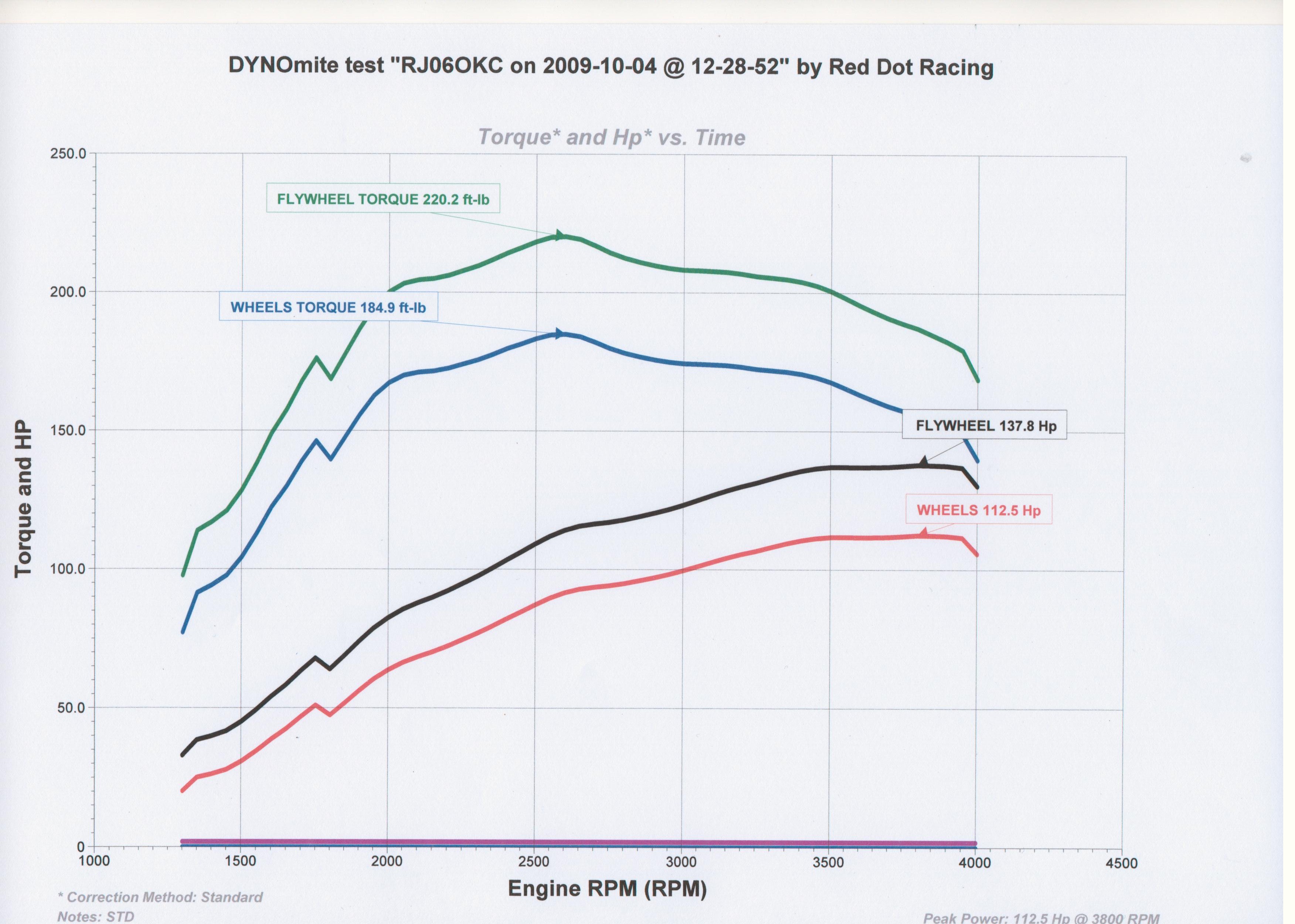

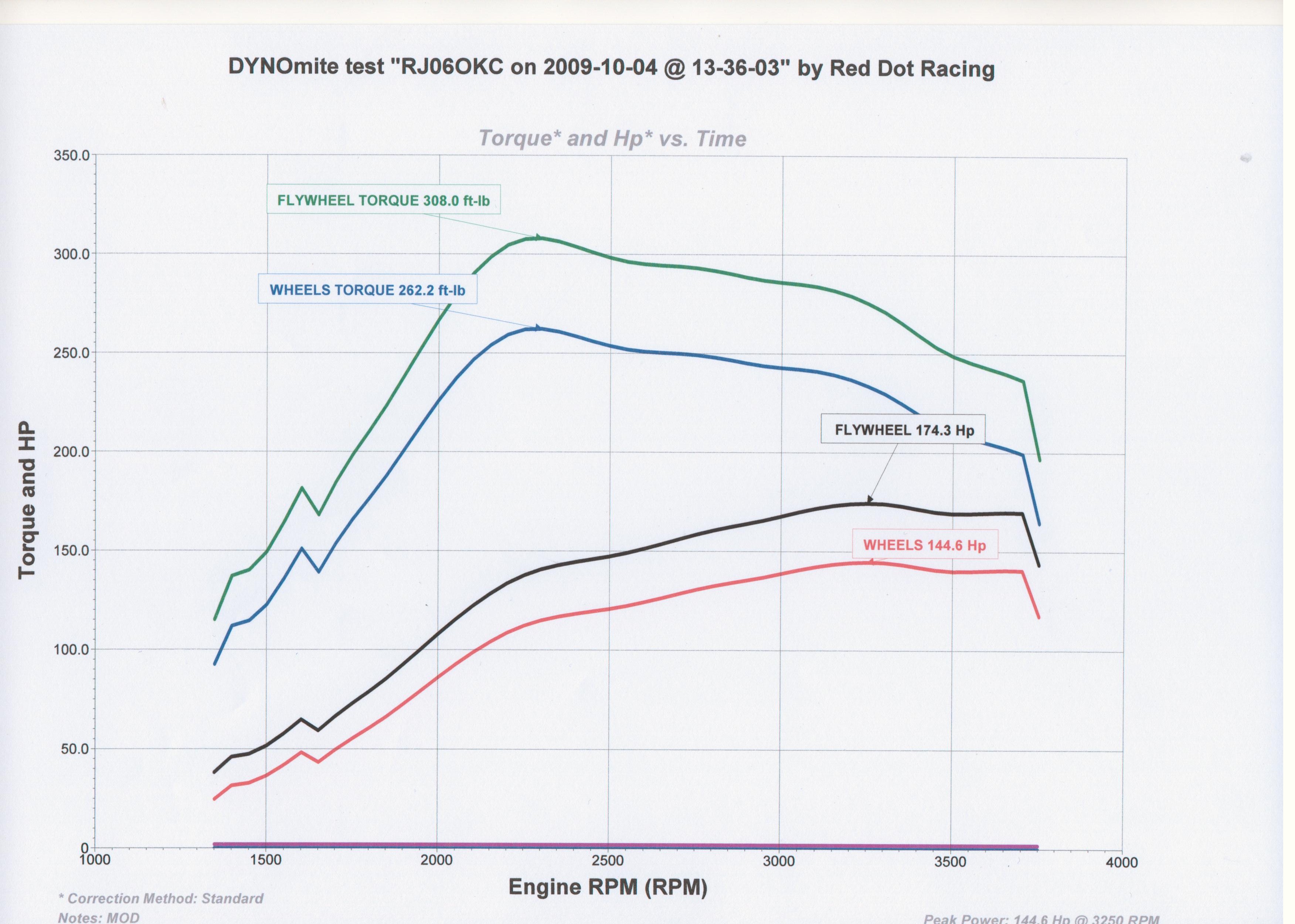

Seems a good job mate, peace of mind with a pro remap, calibrated to yours and your vans needs, as long as engine and the bits bolted on are in good health then all should be good :)
Glad all has gone well for you I know my motorhome is running a lot better after having it remapped by Quantum
John ?
I just dug out an original file for that ecu, the drivers wish map limits the IQ to 74.28mm3 so unless hes changed that there was no point in increasing the torque limiter to 82 or whatever. But if you're happy with the extra power I'd leave it alone.
