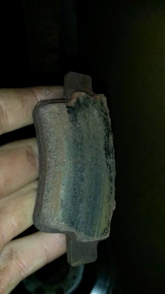

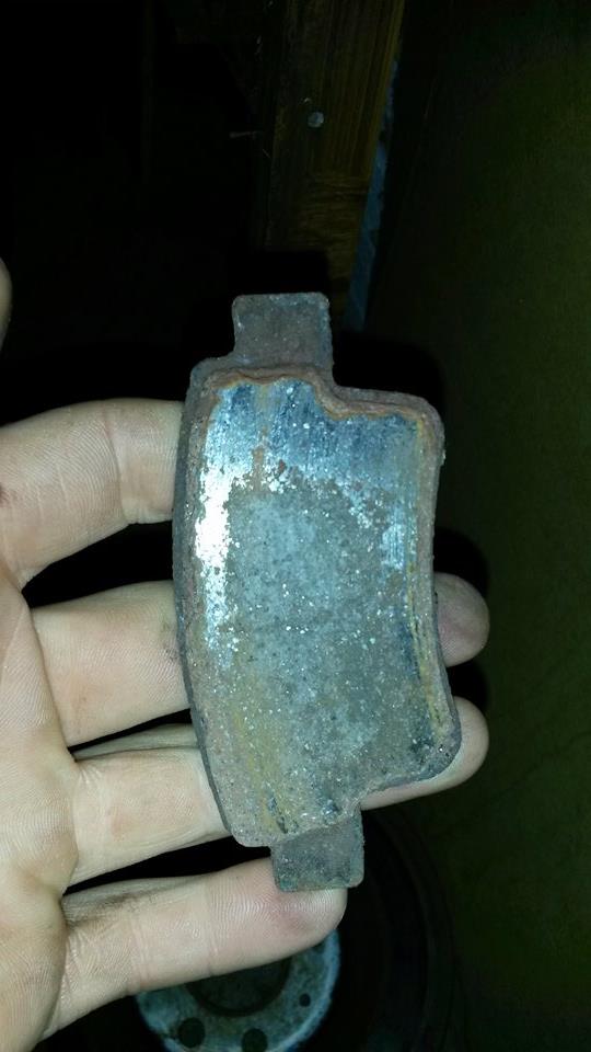

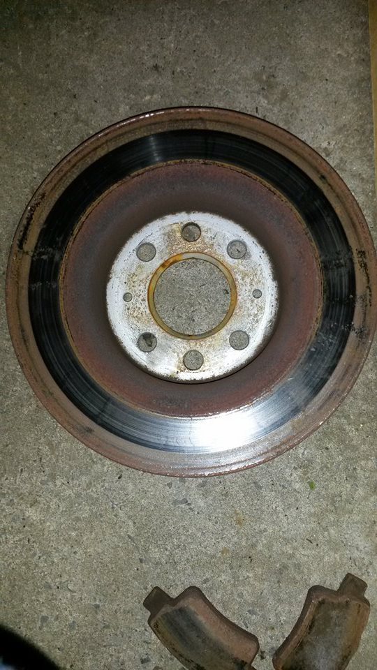

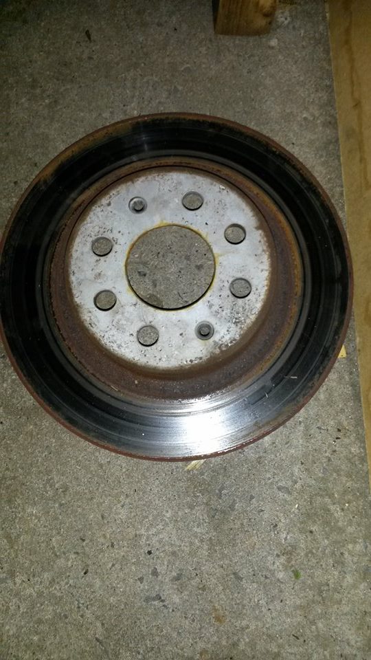

Been working with my neighbour on the car this weekend, been a lot more to it that what was first thought to be a straightforward fix, aswell as the Eibach springs i've had to go out and buy new front shocks aswell as the ones that where on were slightly curved, so spent most of yesterday evening sorting that out and the agp feels a lot better now, so today we've started at 11am with the rear disc's and brakes,started on the nearside rear caliper at 11am and we've not long got it all cleaned up and unseized and got the new discs and pads on only to find that the discwon't move at all now with the handbrake off,so looking at a new caliper for that side and we're just about to start the offside caliper in a few mins,also took some photo's of the condition of the nearside pads and disc...
