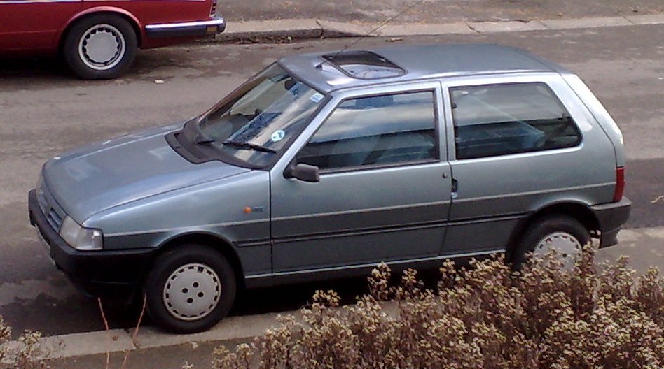

Heres a pic:
Cheers!

Hi:)
nice looker by the way
I would check the nozzles in the carb before replacing the carb, it's not very difficult, it's just to open the airfilter box, and there you should see 2 golden screws, check if they are clean, if they need cleaning count how many times the screws goes round, clean it with some petrole and pressure air, maybe a good idea to check the sparkplugs, airfilter.... see how the sparkplugs look, wet, black, white, they should have a very light brown colour. let us know how it goes
good luck :D

Cheers mate! I recently got 1 of my dream cars, a Jaguar XJR V8 which I`m happy with but I`m even more happy to have an Uno again!
