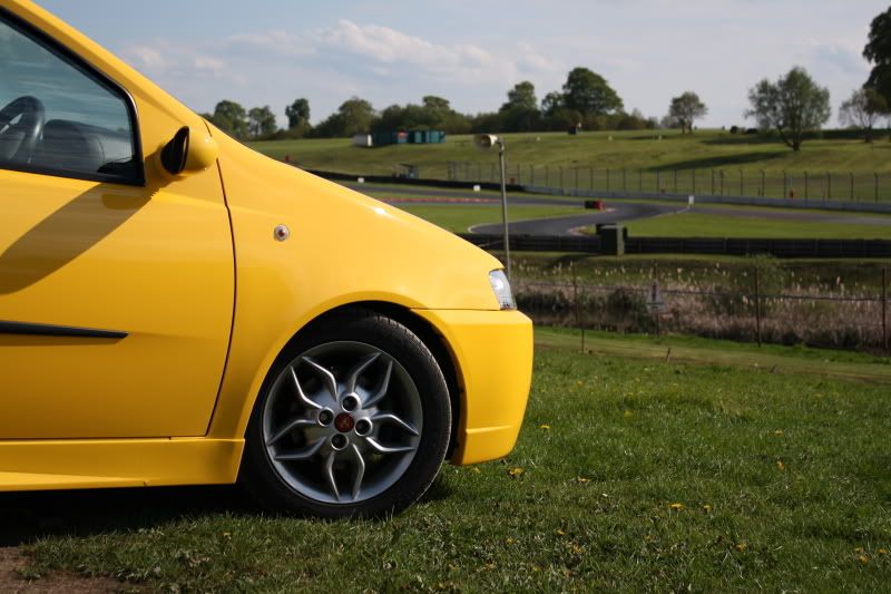

Punto (Mk2/2b) Jonnio's HGT
CAR SPECIFICATIONS:
- Model : HGT Abarth
- Engine size : 1.8 16v
- Year : 2001
- Colour : Broom Yellow
ENGINE MODIFICATIONS :
- None
STYLING MODIFICATIONS:
- VALEO Silencio X.TRM Retrofit Wipers
- Abarth Headlight covers
- New Number Plates
INTERIOR:
- Geniune Abarth Mats
- FIAT logo tax disc holder
CHASSIS:
- Eibach Pro-Street S Coilovers
- Michelin Exalto PE2 Tyres
- Ferodo DS2000 Pads
ICE:
- Standard
FUTURE MODS:
- Powder Coated Wheels
- GSR Induction
- Supersprint Exhaust
- Colour coded handles
