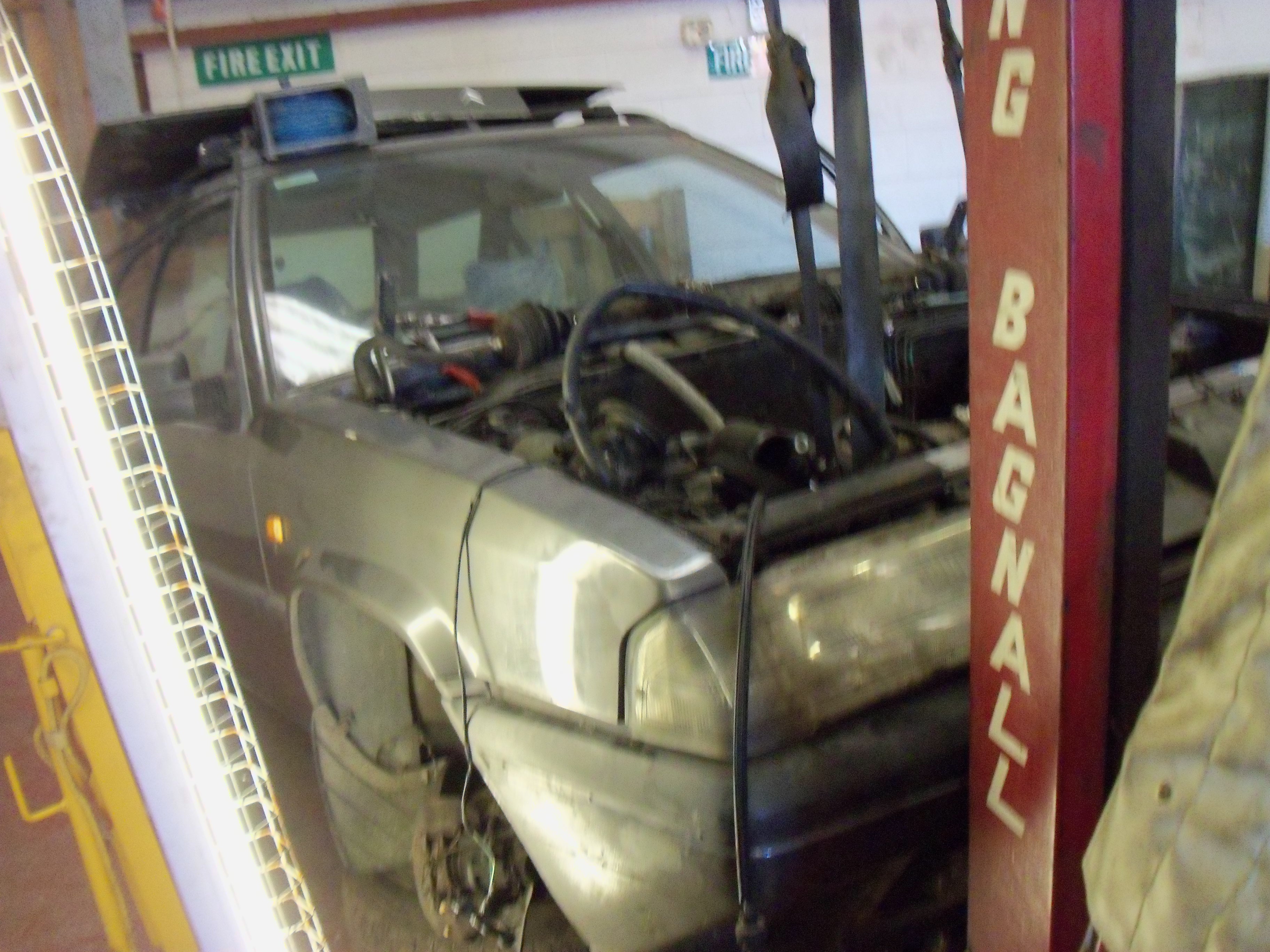

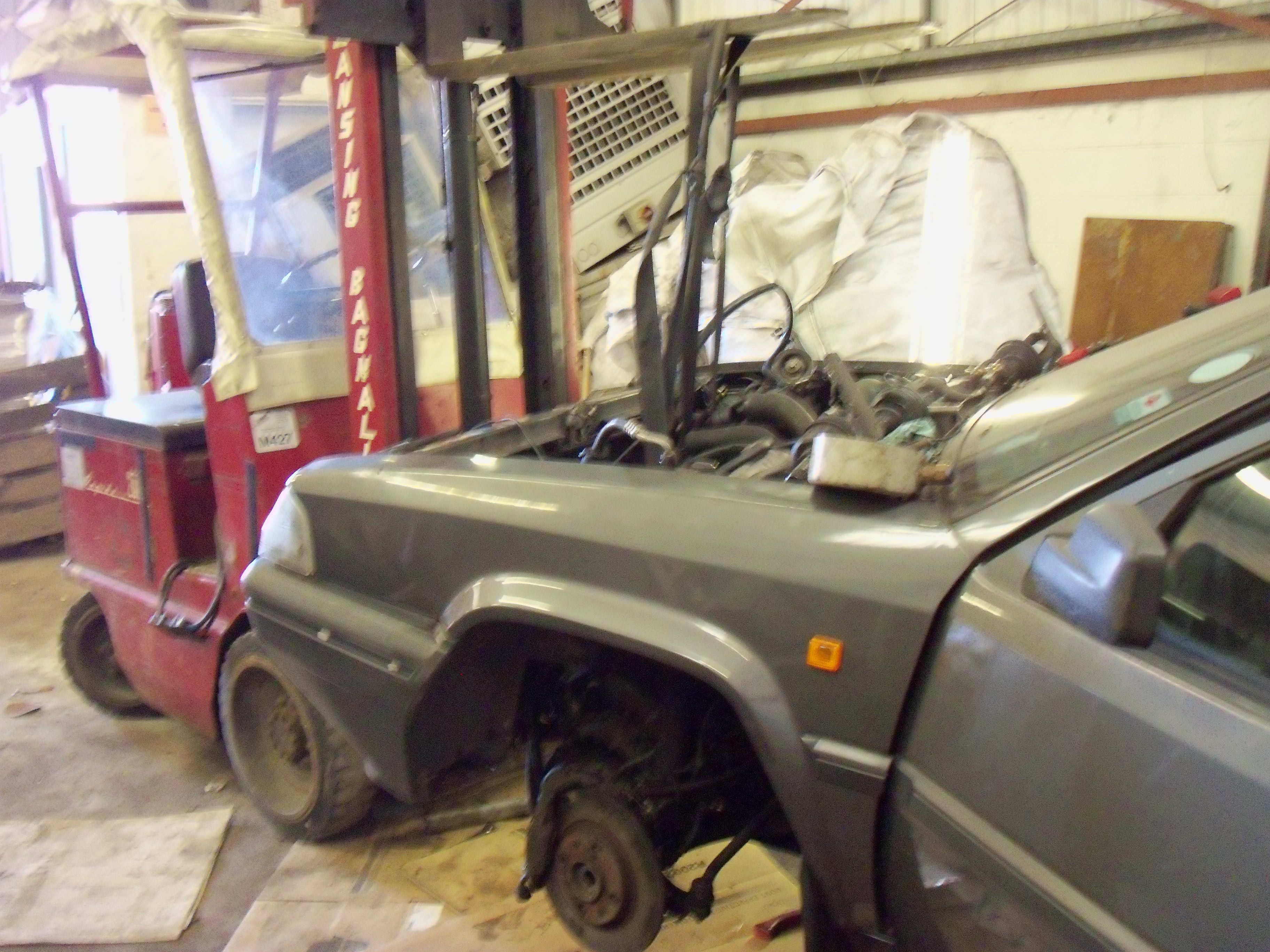

the car is up now. i lifted the front up with the forklift at work and have it sat up on some old tyres. dont worry its safe!
really dont know what way to go about this.
i also want to replace as much of the original steel piping as possible. i have popped a few hydraulic lines just with the stress of jacking it up! well forking it up... i made sure i was not near any too when i did it! guess they have just corroded that much.

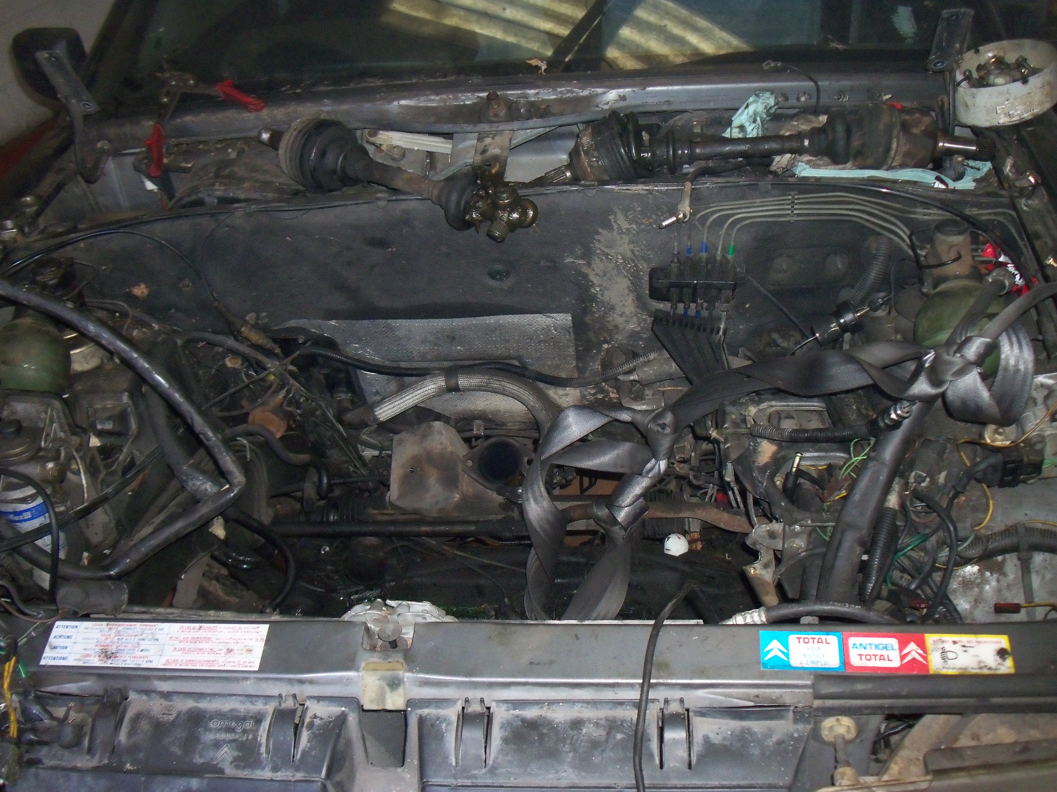

well i have the engine out now. a little bit of damage was done but oh well.. sadly a pipe was left on the engine and has snapped near the heater matrix inside the car. i will figure out what i am going to do with it later on.
here is some pictures and a video!
the video was before the engine came out.
i would not want to kick start it..
