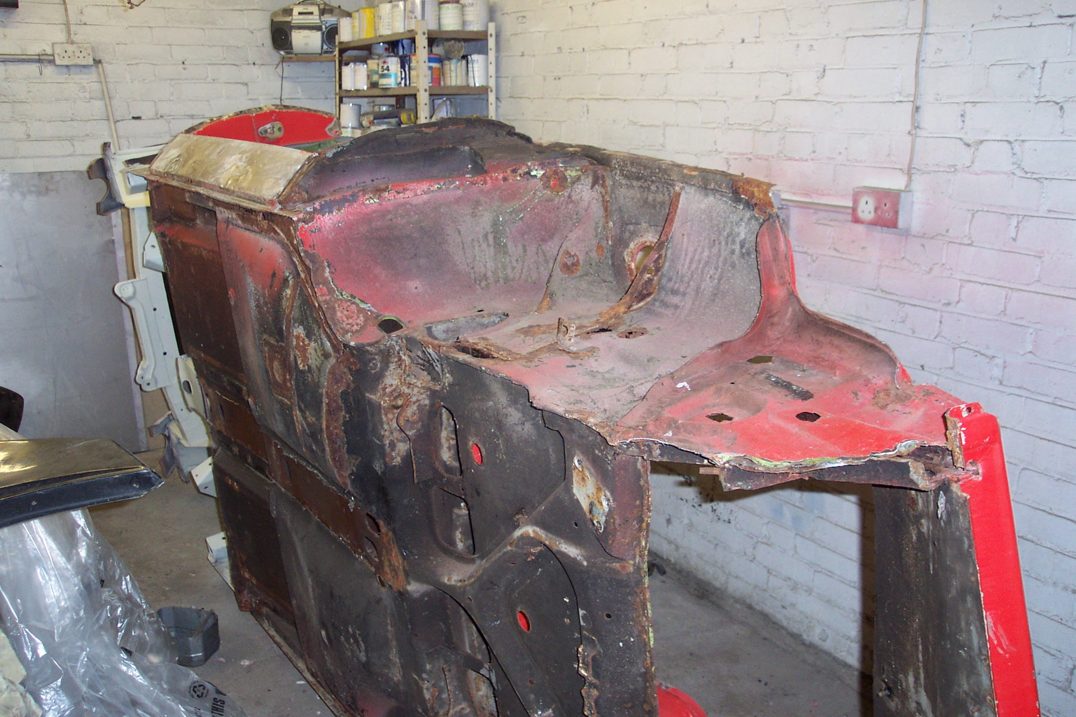

Managed to dig out some photos - I'll try and put them in some kind of meaningful order.

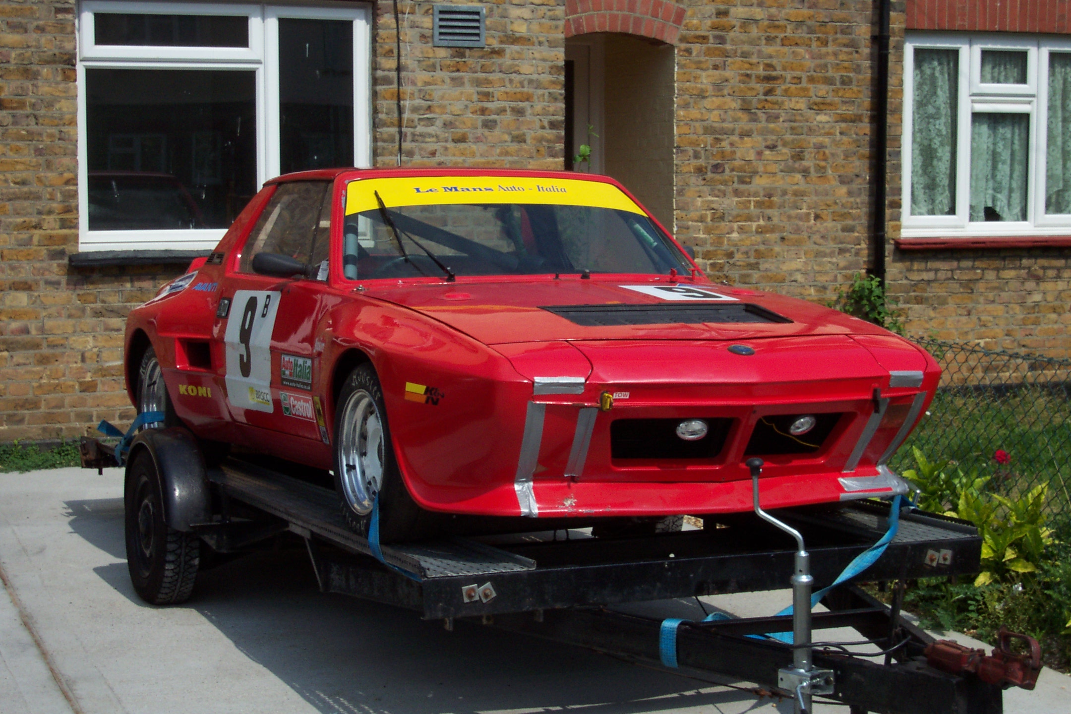

Car #2 first

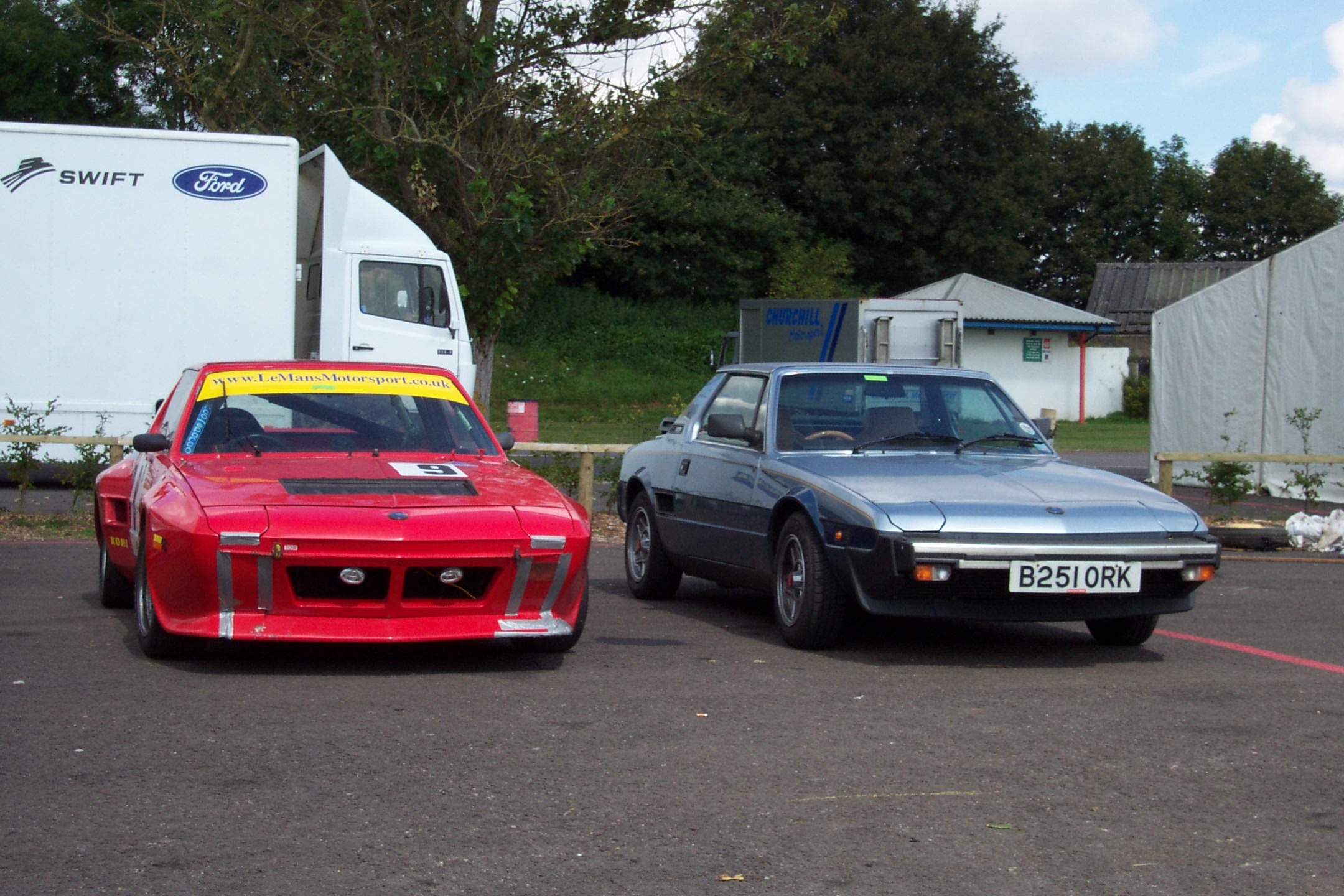

Ready to go racing for the first time!
A day out at Castle Combe for testing

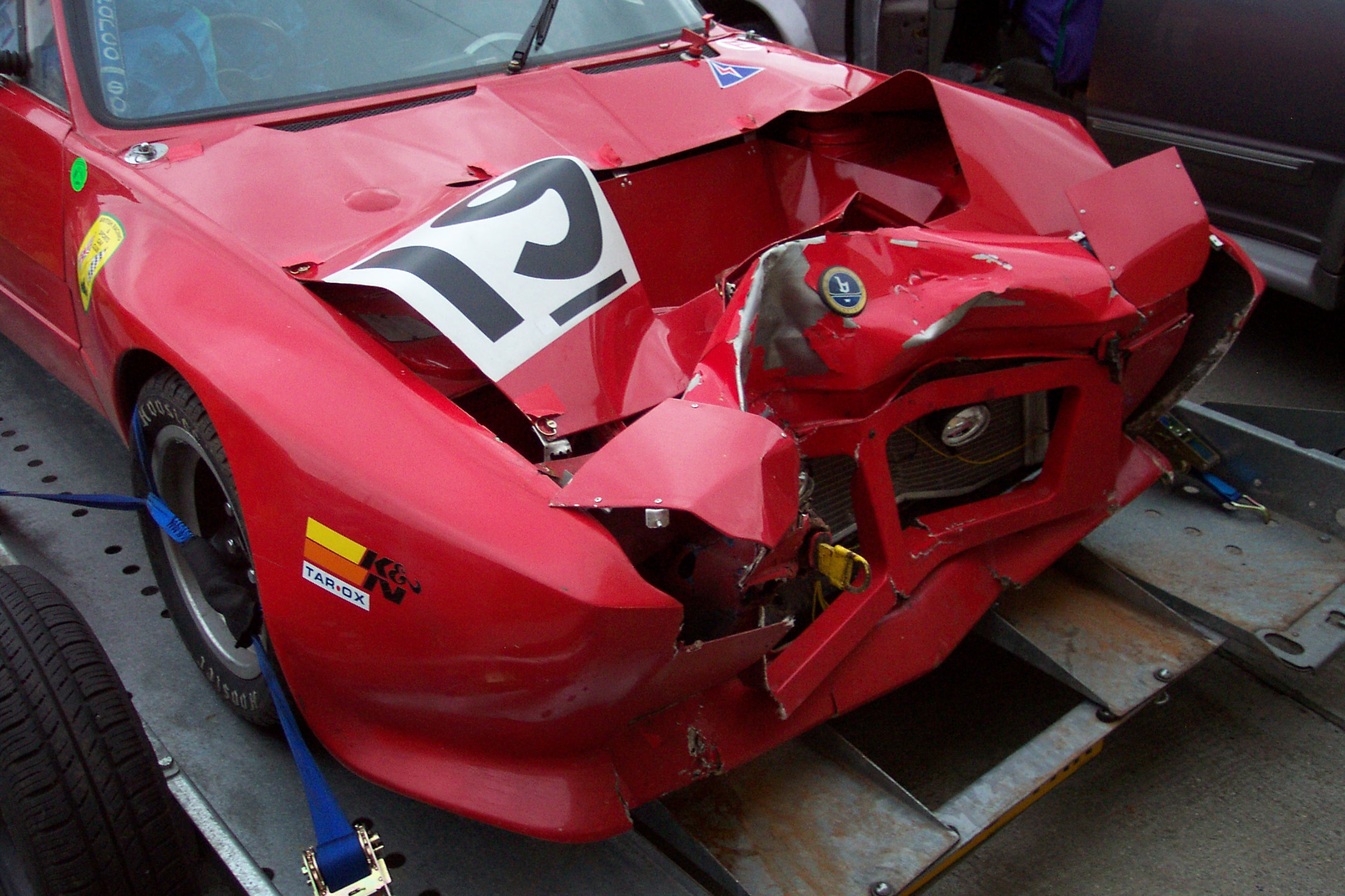

And where it all ended for this one....
Car #3

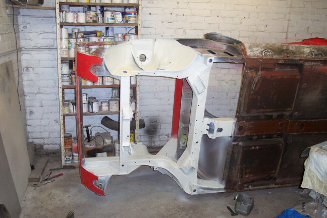

The initial work was stripping the shell back and cleaning it up
Part way and nearly ready for the rollcage

that's impressive :slayer: looks like a top qualty job too (y)
when you said you'd cut off as much excess metal as you could you weren't lying, that thing mst be light? fibreglass panels i assume?
cheers posting the pics, i'll be following your progress

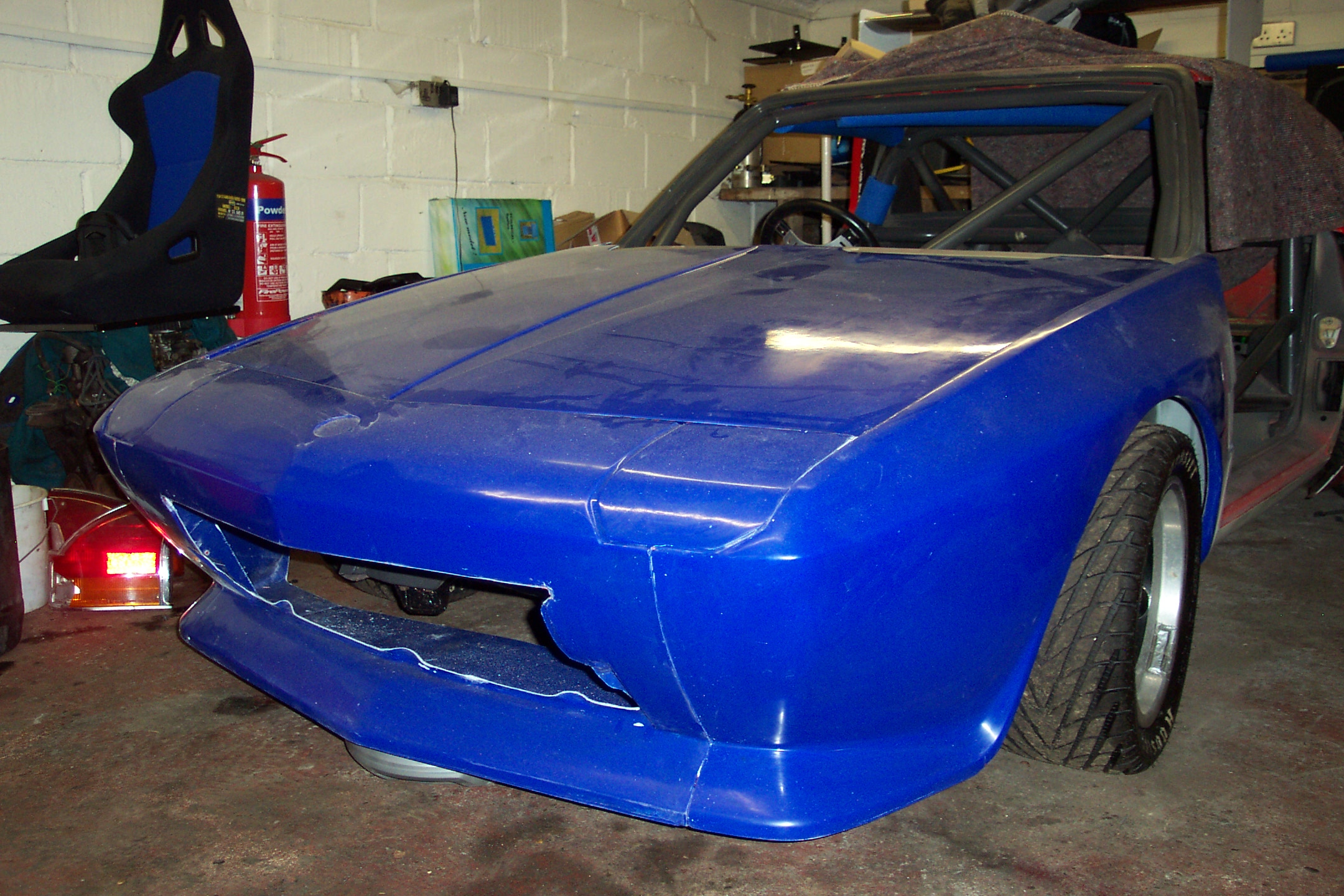

It isn't as light as I wanted it to be but still lighter than the race regulations permit so we have to load it up with ballast and that means we can get a near perfect weight distribution.
The bodywork is all lightweight GRP (scarily thin) but cleverly woven for strength with a bit of kevlar in the mix where there is likely to be some flex.
We did have the option of going for a low temperature carbon fibre set of panels but it doubles the cost and sadly I have to keep the costs down where I can. The beauty is that the entire front end comes away as a single piece and then splits into four parts (2 wings, front and "bonnet"). The rear isn't quite so simple to work with but still comes apart. The rear deck is from a prototipo rather than a dallara, this includes a snorkle to feed the intercooler but this may be disallowed under the silhouette regs despite the historical fitting of such an item to X1/9s in rally but I was allowed to run my old rear deck with kick-up spoiler so I have a reasonable argument to keep it except that I also have an original single element rear spoiler that was appropriated from a real dallara a few years back when that was upgraded to a full gt style affair.
Which reminds me, the inside of the GRP panels need painting - the plan is to use a flame retardant paint that expands when exposed to a fire to smother it and put the fire out. If you've ever seen what happens when a GRP car catches you'll appreciate why it is essential. The chassis is already fitted with a lifeline 360 system but these tend to be of limited use as they only cover parts of the car (typically two sides of the engine bay and the driver). This car is a massive investment of time and money and none of us can afford to lose that investment.
