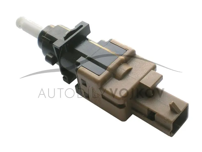

Back to original problem. I had 1,2 8V 2008,156t km, with same symptoms. These are following controls and parts replacemens I did:
- clean and test throttle valve
- control and test accelerator pedal potenciometer
- dog bone engine stabiliser replace, even thoug original was in good condision
- spar plugs replace
- fuel filter and pumpe control
- electric cables and conectors view control
- comlete diagnostic by Bosch diagnostic software during a drive
What's a problem?
1. Accelerator pedal potenciometr was threadbare on first 0-10% of surface, The rotational speed of engine was 1100prm in neutral position → replace by new one, 39€
2. Clutch pedal has lost a small piece of plastic to pushing a clutch pedeal position sensor, so that clutch was virtualy still at "press/neutral" position → fixed sensor position by a butyl-tape at position "non-pressed" clutch pedal :cool:, 0€
Summary→ Problem solved.
Sorry to my imperfect english.
I have had customers vehicles with accelerator potenciometer issues in the past, although more like a "dead spot " in one position when moving the pedal.
Both that and the clutch pedal position sensor etc. will show up using MES Fiat diagnostics and other similar tools.:)
