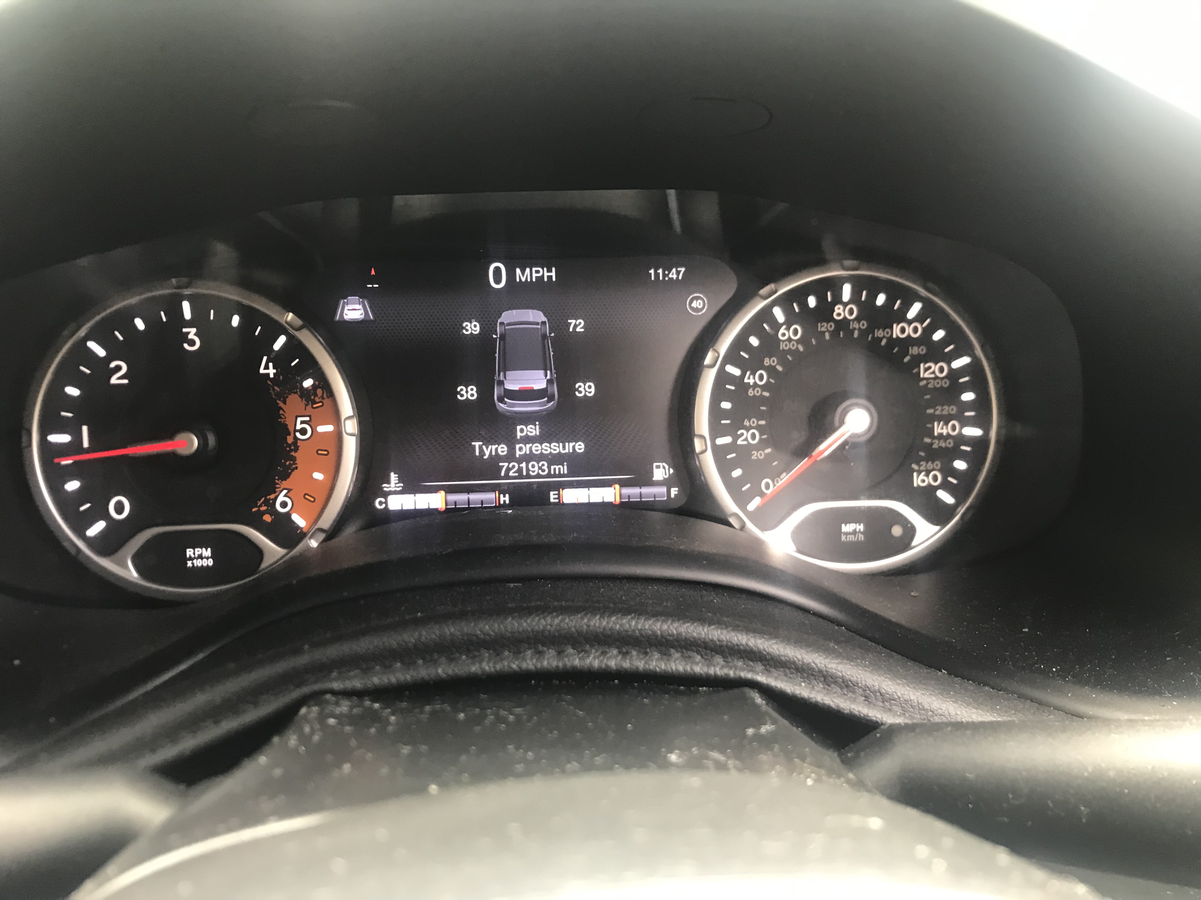

2 Tyre pressure sensors information dropping out ( new sensor purchased as front rh wheel says 72 psi yet all pumped to 37 psi .. other 3 wheels show correct when displaying, … I get the flashing tyre warning first 10 min then solid light at moment) ..

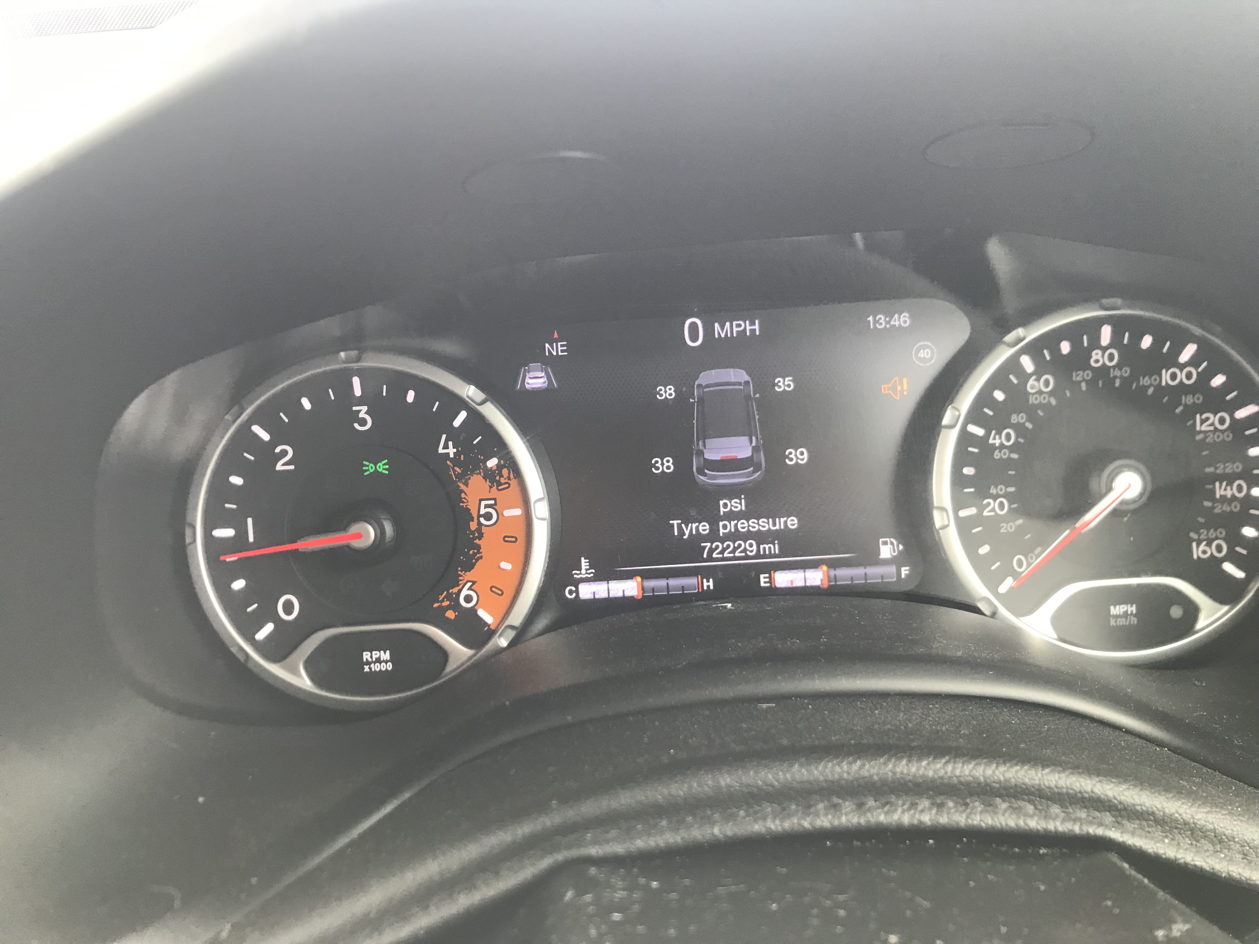

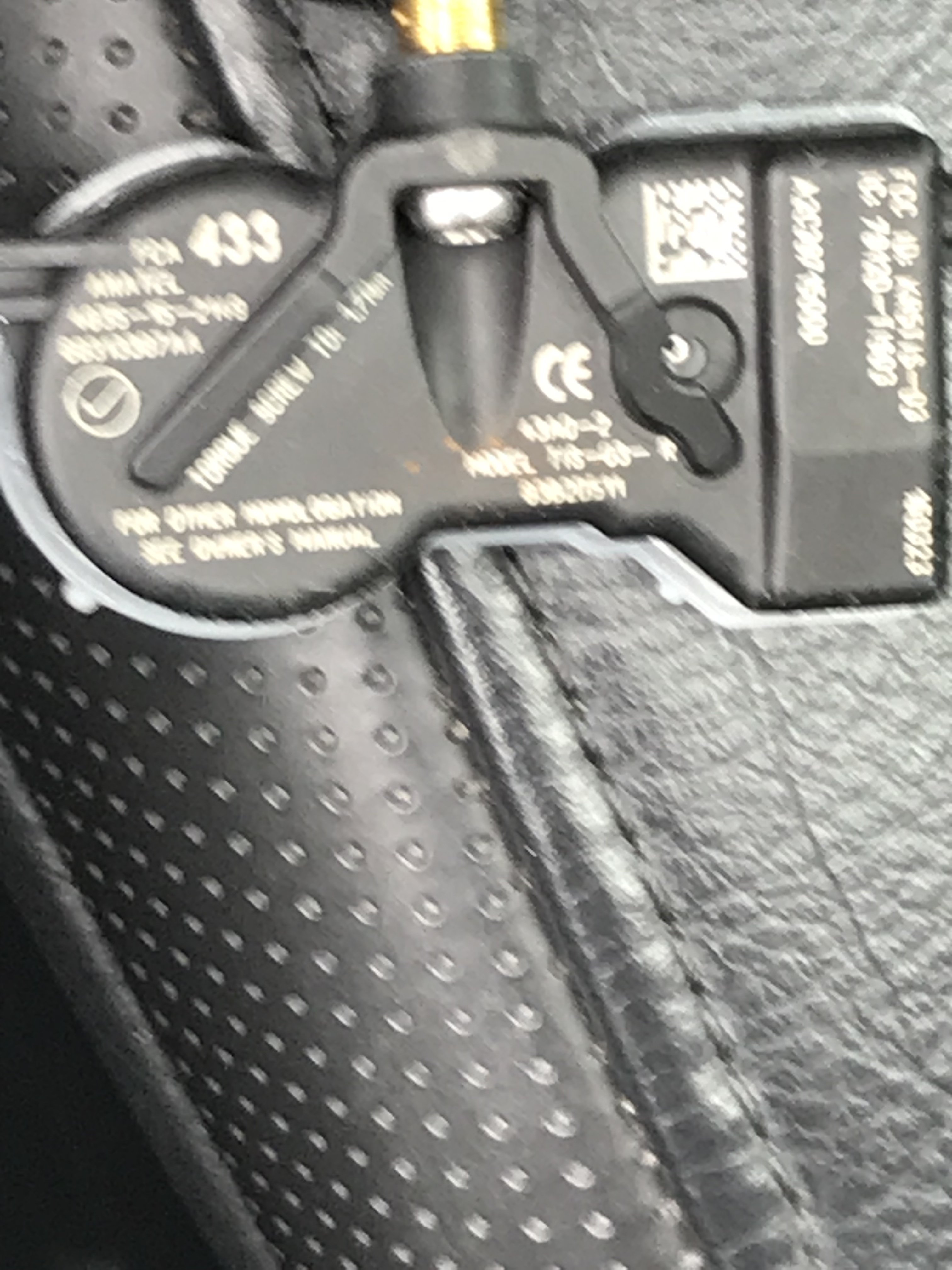

Tyre sensor permanent fix today….. £15 eBay sensor installed to replace the one failed high at 72 psi ..,
System self learned , no special tools or coding needed .. 15 min drive , then correct 35 psi pressure showing..
Pressures no longer failing to —— and warning lights 👍✅
£10 to instal from a palls tyre firm 👍

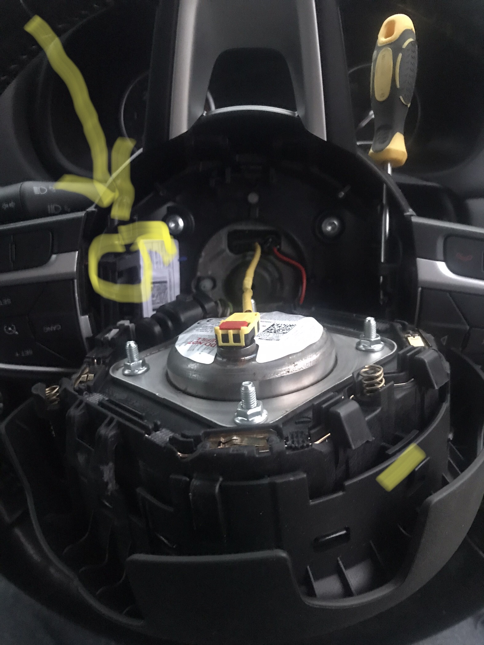

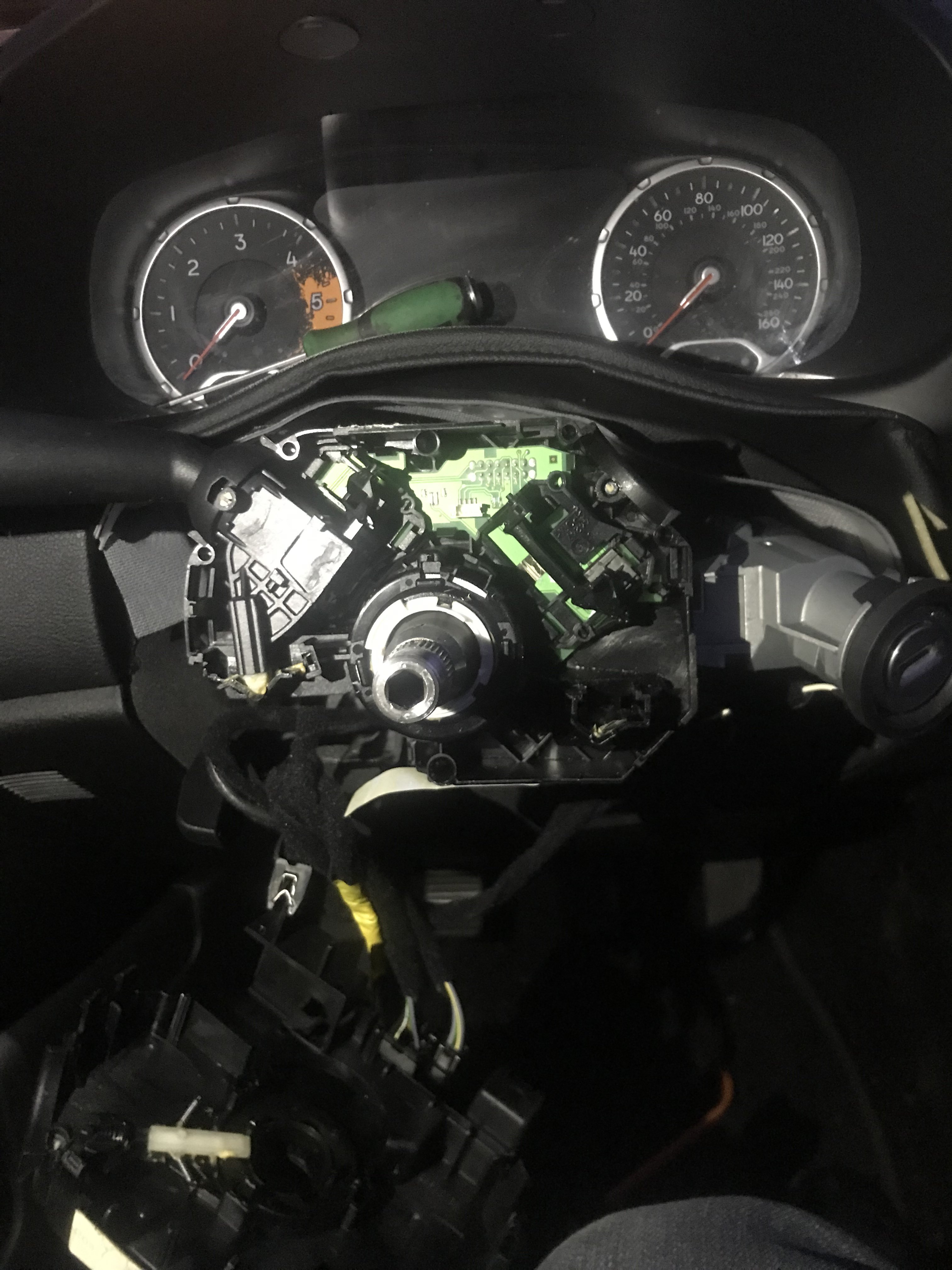

Extra task today was remove steering wheel to change faulty wiper arm (used arm salvaged from damaged indicator combined unit (£15 eBay ) … box clips apart with care , small lead pulls out , no clips …
Plenty you tube clips show airbag removal inserting tool in to access holes on bottom of steering wheel … I find it easier to rotate wheel 180 degrees so I can get my head over to see where inner holes are …
After first clip released, I access the second clip using a different method.. there is an access groove you can see by easing over the rubber to the side of the airbag , so you can easily see where the release clip is ..then insert from front and pops out in seconds ✅
Enjoy 😉

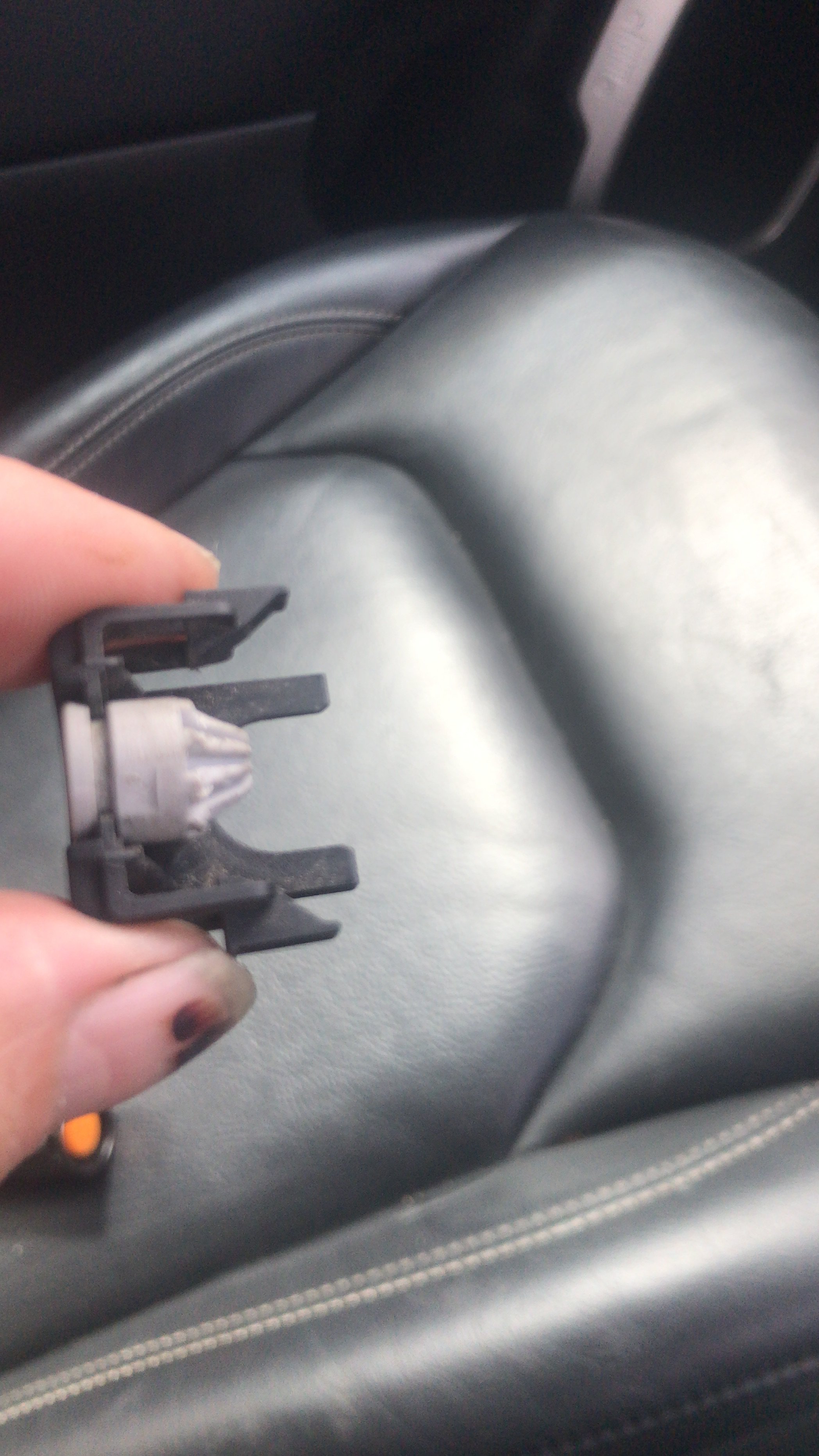

Early start today as re-test on mot , I had to lower beam on lights.. packed mounts as the bottom adjuster had been over adjusted and stripped cogs on both headlights .. fortunately they clip off and can get an Alan key on the now centralised adjustment screw..
Passed ✅
