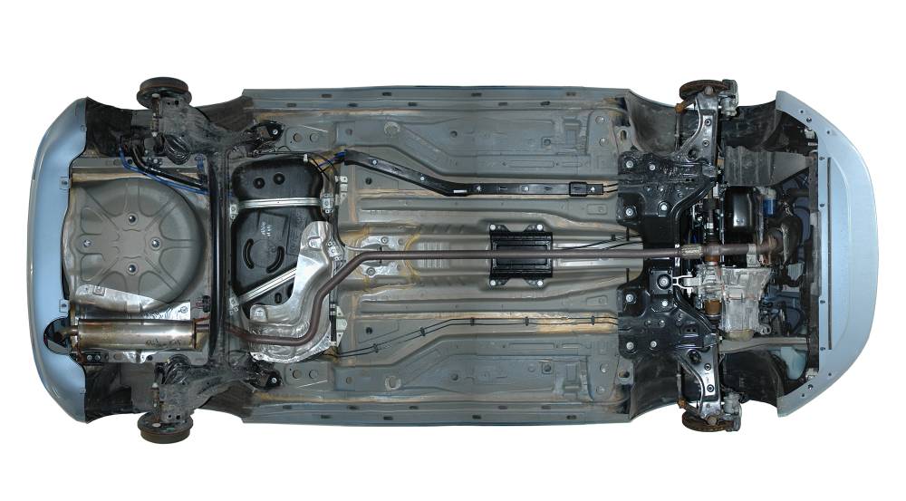

This is the underside of a GP. I'd be surprised if the Evo is any different. I have highlighted solid parts of the floor pan. You should use rubber pads or at least some wood on your jack to avoid damaging the underseal.
Hth, Simon.View attachment 203014View attachment 203015
Great illustration - A picture paints a thousand words - My Favourite points for placing the axle stands are the two rear most points you illustrate and where the front outrigger pieces meet the main chassis box section at the front.

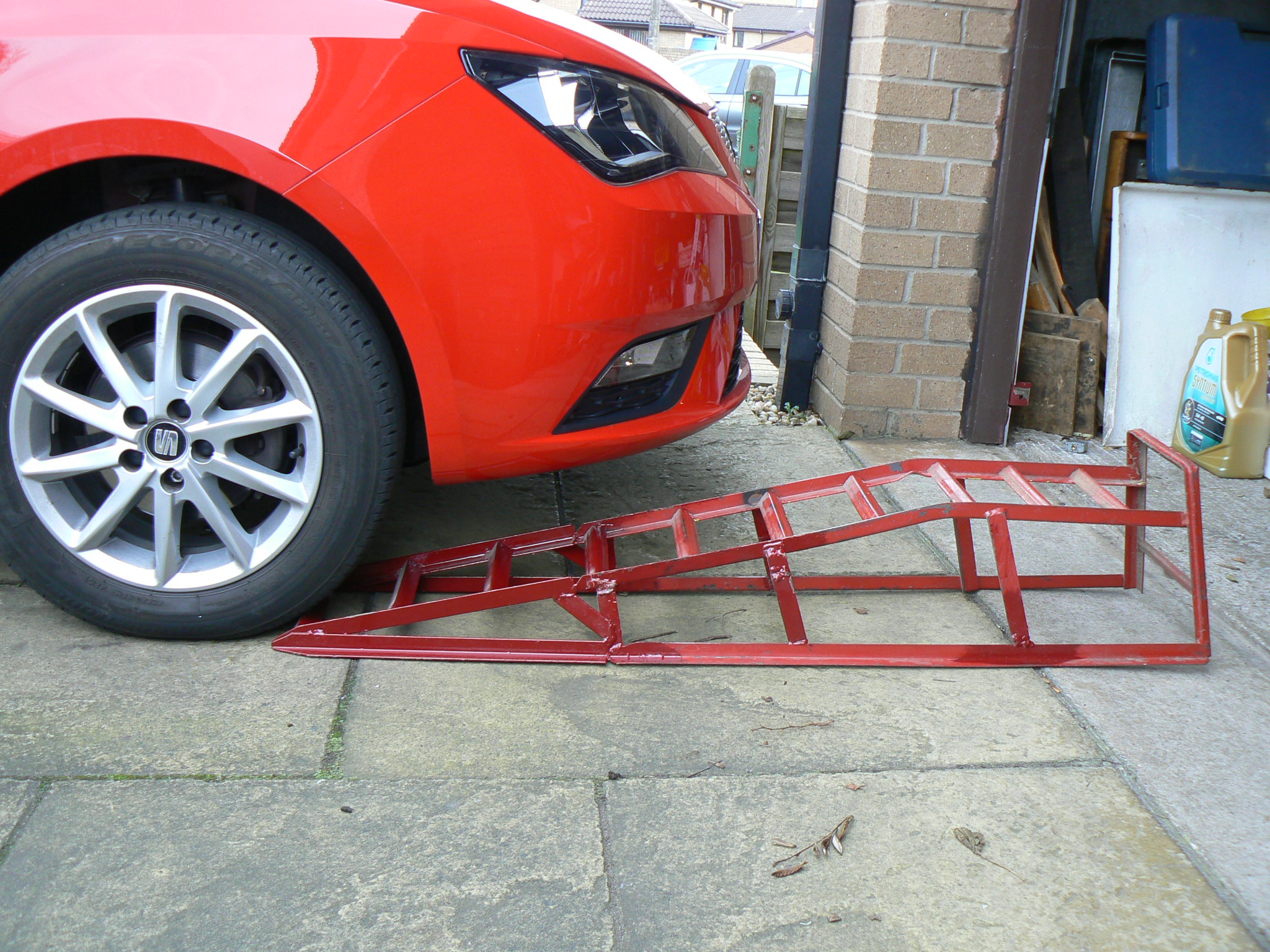

Ramps are of limited utiliy. OK for exhaust and bodywork, but no good for uspension or brake work. Not ideal for oil changes either as car should really be level. Finally most don't fit well under the front skirt of most modern cars, needing a helper ramp to get on.

When I first started working on my own cars at home I decided to go with axle stands for their greater versatility. I'm very happy working this way and would not have bothered with ramps except that I was gifted a pair. I quickly discovered that most modern cars have too much overhang at the front to drive up on them without some sort of "help" (helper ramp) to let them clear the front body panels. So I extended mine:
If you start at Twinkle's wheel and look to the right you will see the new section has been added between here and that first vertical brace. Now they work very well. But, for the reasons stated above, I very seldom use them. They use up quite a bit of storage space in the garage too. Actually, this is not a good illustration of the problem because Twink has less front overhang than many.

I dunno About other EVOs but the whole underside of mine is covered with plastic panels. I believe this was done to improve underside protection from the elements and also for aerodynamics to improve fuel economy for the all important tests back in 2010 (hence why my 1.6 multijet EVO has the same CO2 figures as my old 1.3 multijet punto from 2004)
Anyhow it makes seeing anything on the bottom of the car very difficult, I certainly cannot see the parts of the floor pan marked in your picture.

I Imagine newer models are quieter also for that reason. That's exactly what the underside of my daughter's 07 GP looks like. I'm hoping to pick up a '12 Punto for my wife tomorrow or Thursday. I'll know better then.

my 60 plate evo 1.4 8v looks the same pictures underneath I wonder if its just certain engines/ trim levels that have the plastic trim.
Thanks for the underview pictures.....seems that the 2 box sections close to the rear axle mounting points will be good enough, as well as the front cross member/outrigger areas, load well spread on substantial wood towers etc.......car not with me yet but for armed is for warned etc.....
