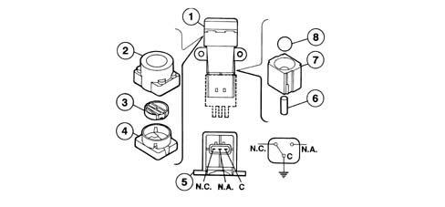

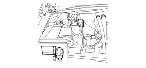

You haven't inadvertently bumped the emergency fuel cutoff switch, which I assume Ivecos would also have, located up on the firewall near the battery on a Ducato.
Should only cutout when there is an impact although I have heard of them activating/cutting out after hitting a large pothole or similar but could be the cause if it turns over ok with the starter.
From the Fiat eLearn -
Safety inertia switch
The vehicle is fitted with a safety inertia switch located on the engine bay on the dashboard wall near the battery to increase vehicle occupant safety during crashes.
The sensor reduces the possibility of fire (due to emerging fuel) by deactivating the axiliary pump that feeds the injection circuit.
Simply press the switch until it clicks home to restore the auxiliary pump earth connection.
If a smell of fuel or fuel system leaks are noted after even an apparently slight impact, do not reset the inertia switch but find and repair the fault to prevent the risk of fire.
1 - Inertia switch assembly. See Picture.
2 - Sheath.
3 - Button.
4 - Upper side.
5 - Engagement side.
6 - Permanent magnet.
C - Shared terminal
7 - Permanent magnet seat.
8 - Steel ball.
N.C. - Normally closed contact.
N.O. - Normally open contact.
