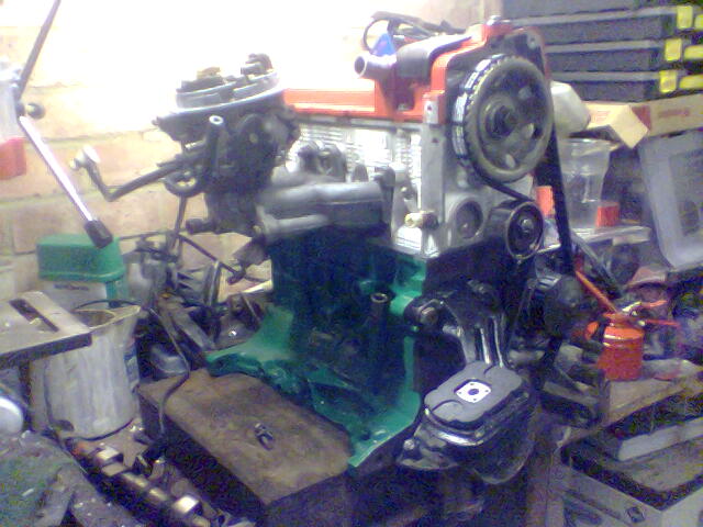

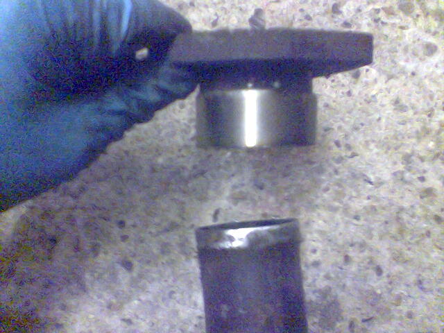

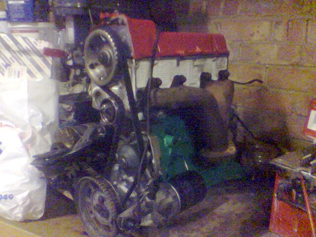

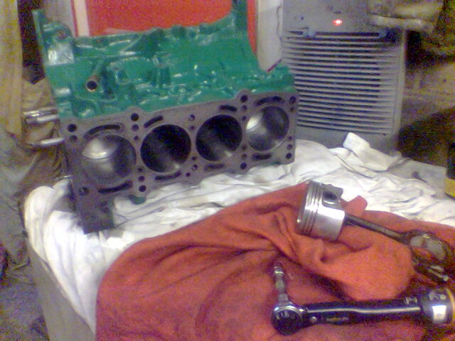

Hi everyone, hope you are all well.
I just thought I would post some pics of the 1242cc engine I have just put in the girlfriends Cinq which we got cheap due to a big oil leak and slipping clutch. I bought the engine from scrapyard out of a a burned Punto 75 about a year ago as a non runner-the sump had been taken and it had been sitting on the ground open to the weather for a couple of weeks. Now its been reborn with all new components and it goes really well The engine has:
Cinq 1108 gas flowed head.
1242 '75' bottom end.
'75' cam.
new shells(mains and big ends).
new piston rings.
new waterpump
new cambelt and tensioner.
3 new mounts
'75' mpi 38mm throttle body made to fit spi unit.
new clutch
painted it italin flag for a laugh really.
Hope you like the pics thanks Rich.:slayer:
