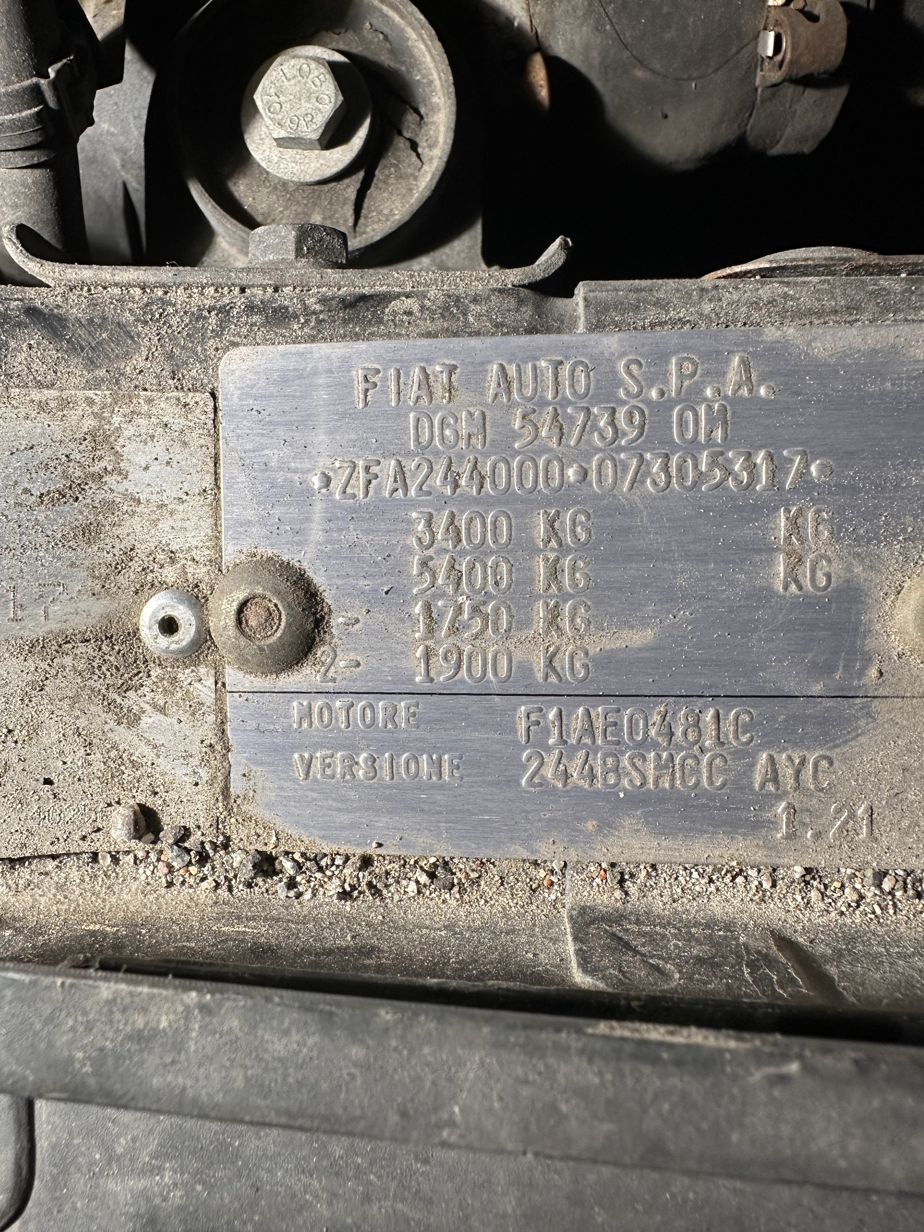

Hello! Maybe someone had these same issues?
Had a Ducato 2.3 2004 mod (chassis 244) for 2 years now, no trouble. Went to neighbour country Sweden last weekend, filled the tank with diesel (almost empty) and then stopped right after. Minus degrees and the car wouldn’t start. Then a real problem sound, and we stopped. Red check engine lamp on. Tried a few times, then the lamp disappeared. Drove about 300m to the ferry. Well back in Norway we drove about 30 mins.
Tried diagnosis at home, P0191. At first it said injection fail, then pressure unit control and a problem with the ECU at one time. The diesel filter was loose, and full of water! Think we filled water that last gas station. And with the cold, can something have frozen? Checked the FRP sensor, nothing seems wrong with wiring. Could it be those sensors on fuel filter? Or maybe the injector? I don’t know. It seems like with 1500 rpm it just stop. But with 3-4000 rpm it seems good.

2004 mod 2.3 (244 chassis)

2004

120000
