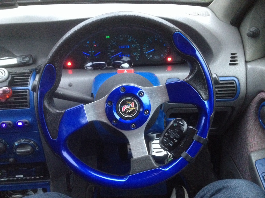

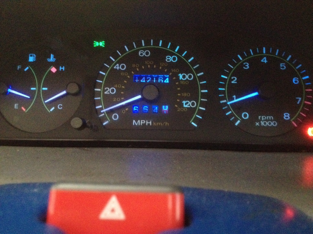

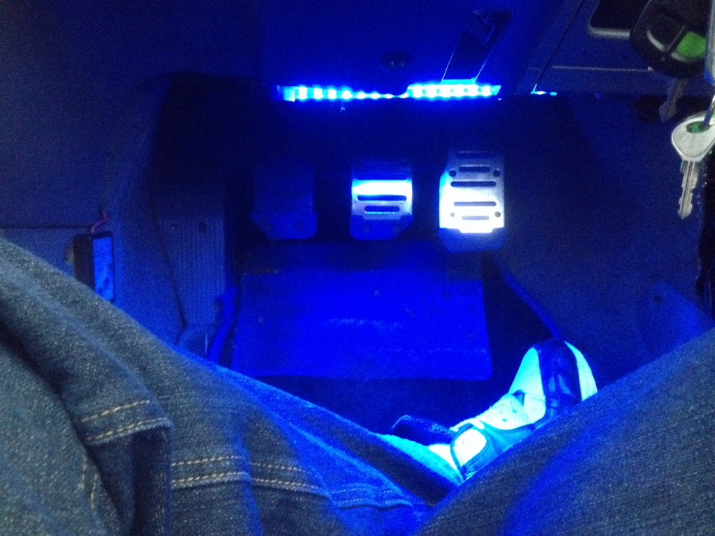

Buy some led bulbs that go into the back of the dials I think the bulb holders on the back are brown colour I bought some t5 LEDs and pulled the bulb out if holder and replaced with these only use smd LEDs they last a lot longer then standard or high bright ones avoid china only uk bulbs I you change all the brown holders with blue LEDs your needles will light up blue aswell
This how it looks apart from it wasn't very dark when photo taken better at night

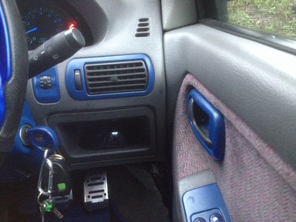

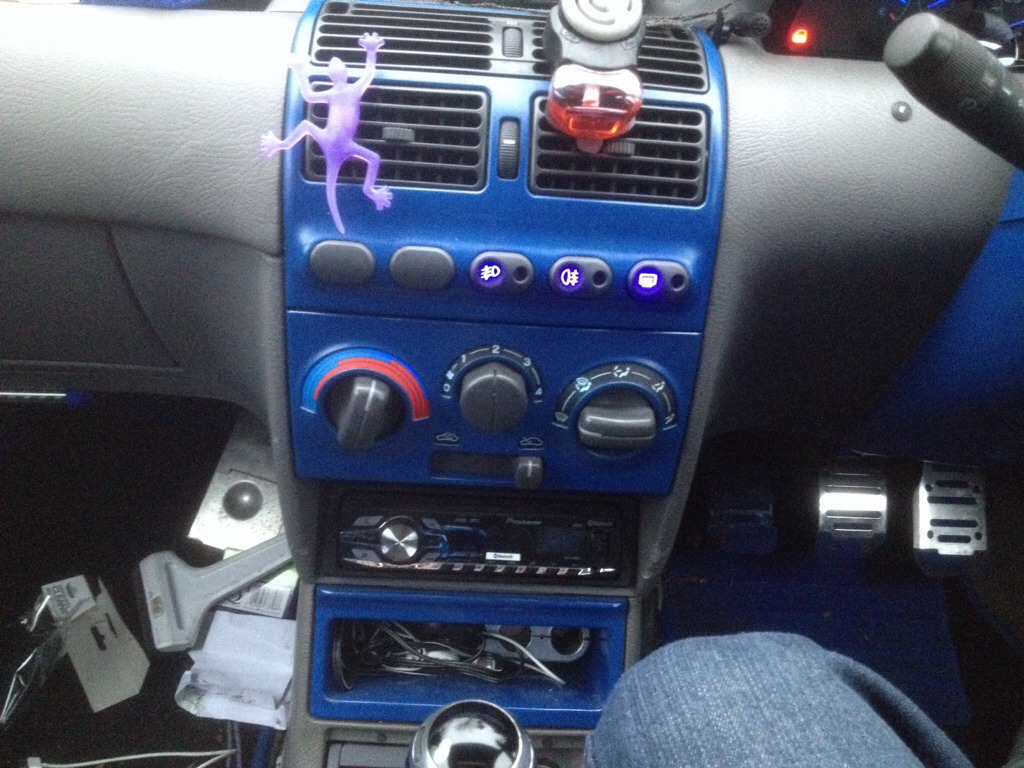

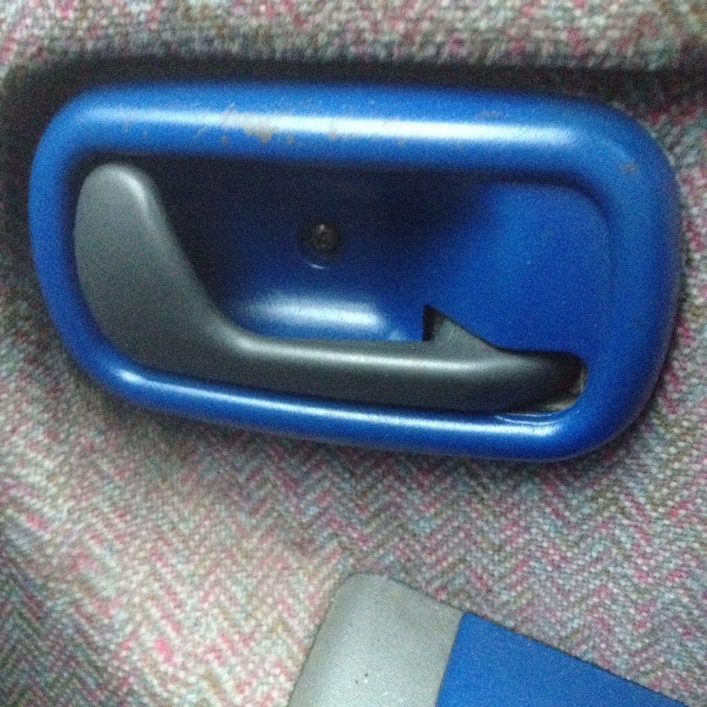

Have you painted your plastic around the hazard switch as well.

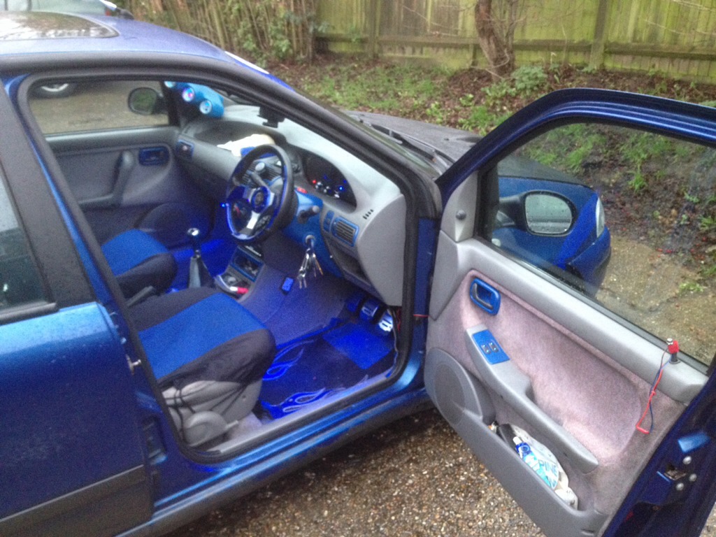

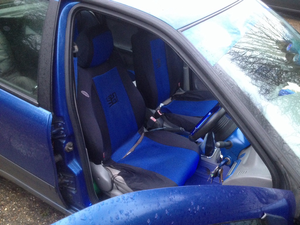

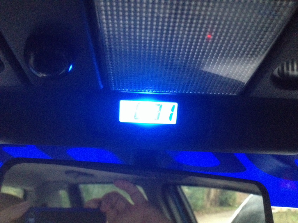

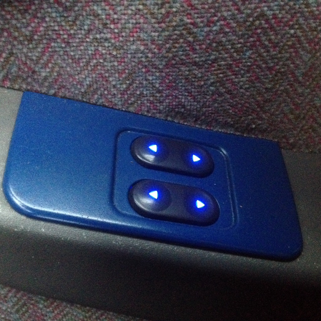

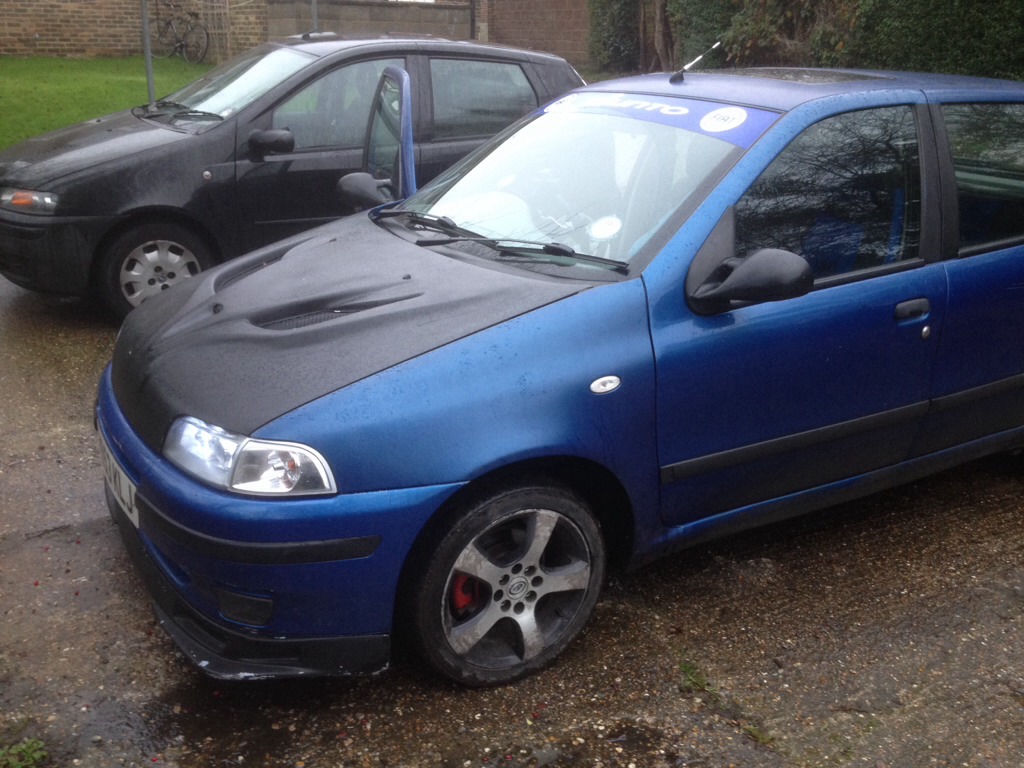

Yes I have sprayed plastics with some paint I bought for a £1 a can from delboys shop will show the the other bits I've done to ? shortly

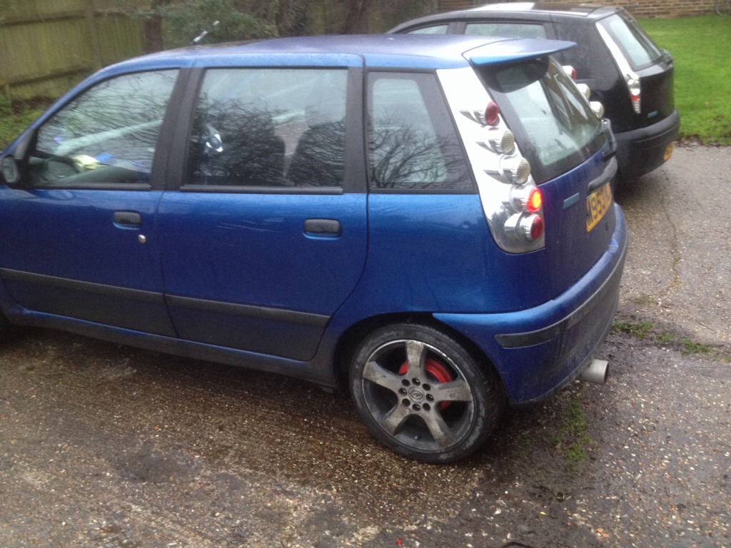

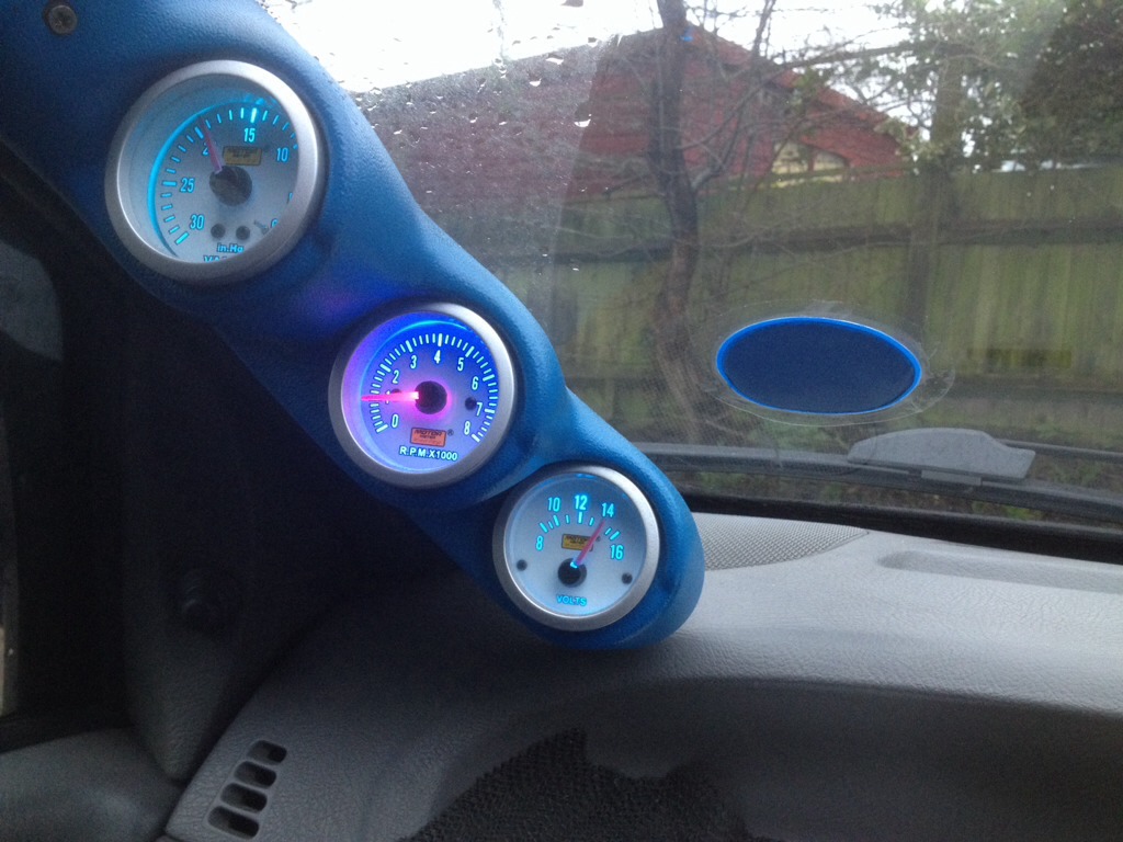

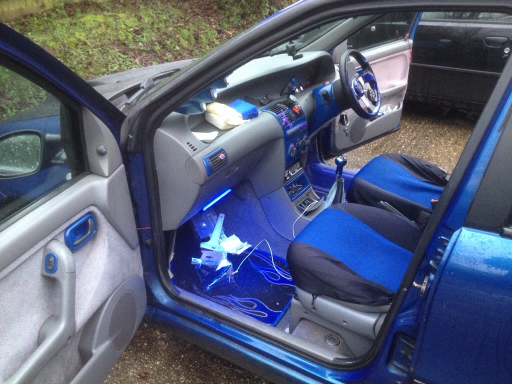

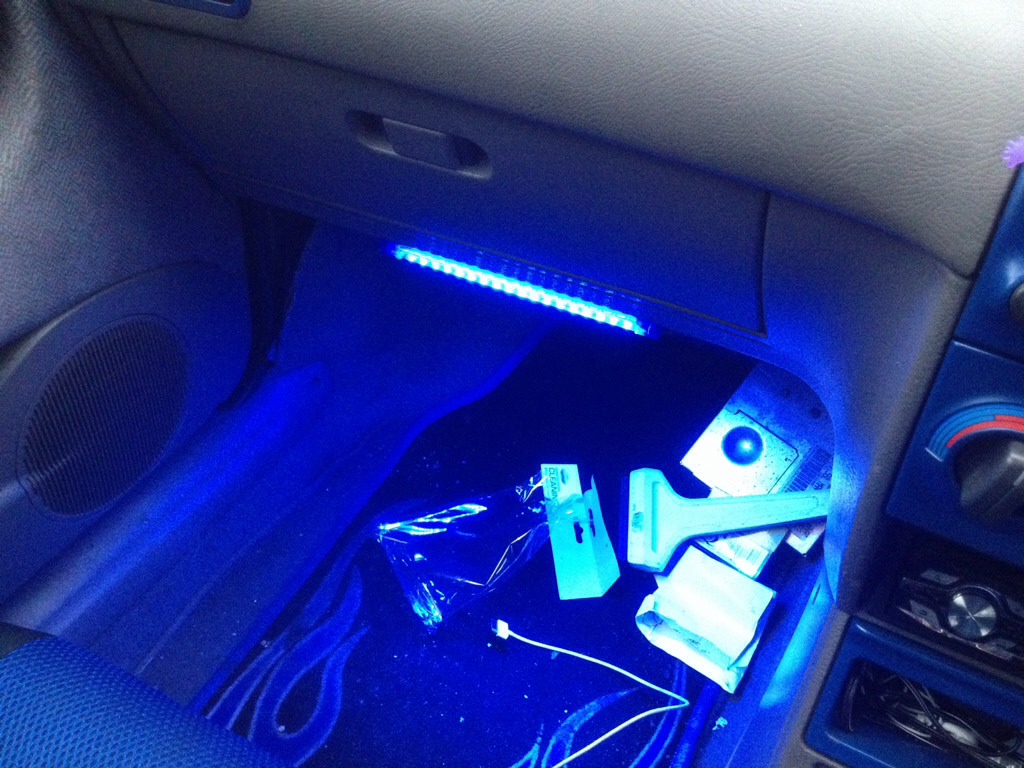

These are pics of my project car hoping to get it resprayed soon also will be spraying dash from grey to black and putting gt side skirts on it and a set of Punto alloys
ImageUploadedByFIAT Forum1387096941.334398.jpgImageUploadedByFIAT Forum1387096955.754841.jpgImageUploadedByFIAT Forum1387096967.840467.jpgImageUploadedByFIAT Forum1387096981.625943.jpgImageUploadedByFIAT Forum1387096996.542155.jpgImageUploadedByFIAT Forum1387097020.798007.jpgImageUploadedByFIAT Forum1387097033.974593.jpgImageUploadedByFIAT Forum1387097048.595967.jpgImageUploadedByFIAT Forum1387097058.417478.jpgImageUploadedByFIAT Forum1387097070.079466.jpgImageUploadedByFIAT Forum1387097084.979488.jpgImageUploadedByFIAT Forum1387097096.512431.jpgImageUploadedByFIAT Forum1387097126.105019.jpgImageUploadedByFIAT Forum1387097139.901267.jpgImageUploadedByFIAT Forum1387097153.025312.jpg
Would GT skirts fit 5 door without drilling holes or anything?
They can be silicones on but I'm going to put proper fittings on by drilling the holes and yep they do fit 5 door
