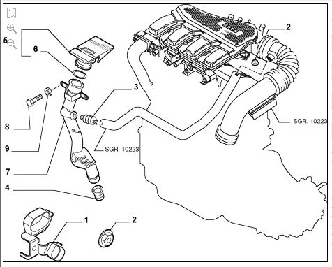

Item #3 on this diagram from ePER is the 1.6 flame trap filter.
It's not shown as a seperate part for any of the larger engines, so either they don't have one or it's only supplied as part of a pipe.
