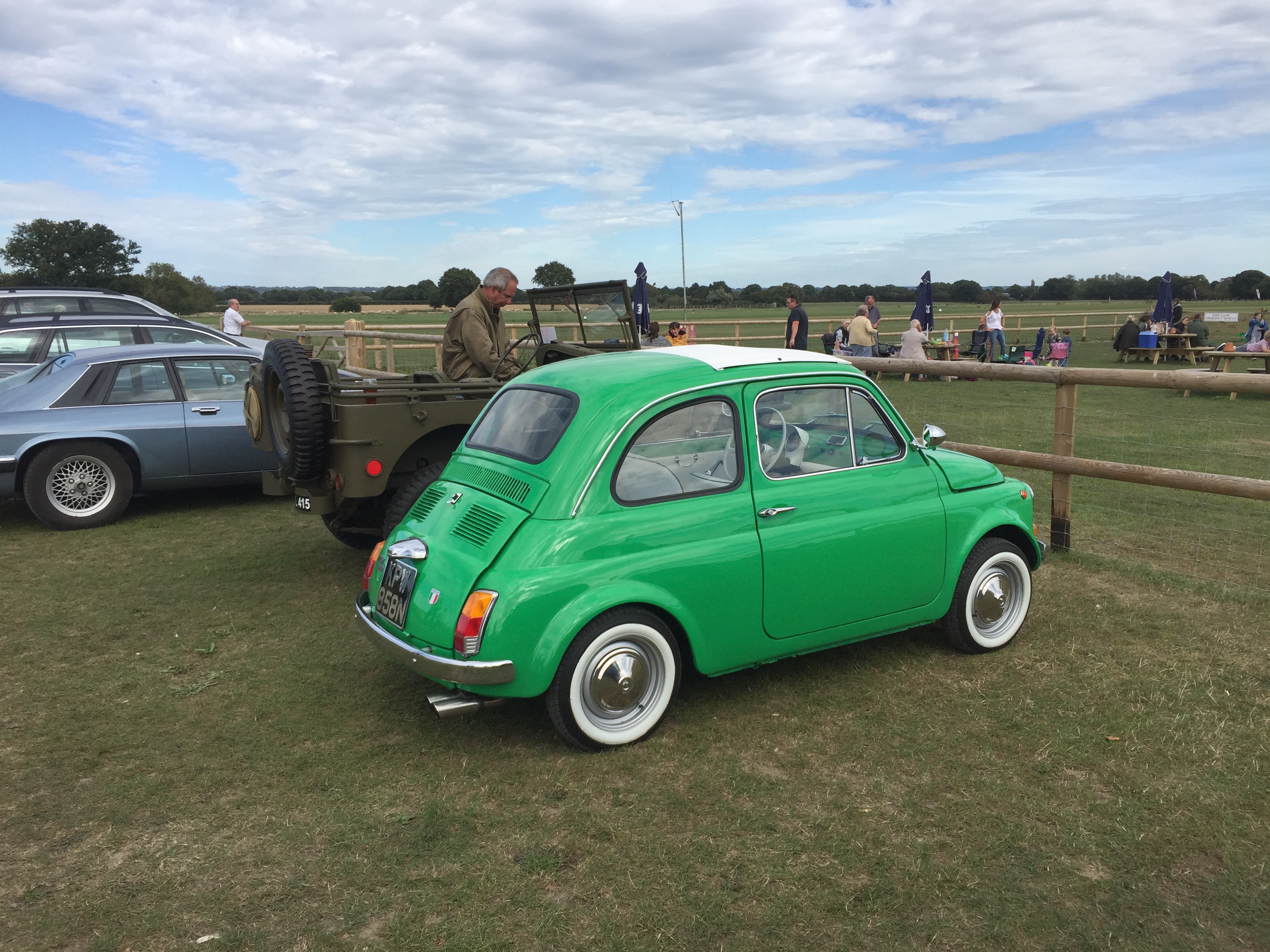

Understood. When I restored Val, the hardest part was which external colour to go for. I wanted green and spent hours researching various colours. When I had decided, I brought sample (touch up) and painted them onto fresh piece of scrap metal. Then looked at in all light conditions I could.
In the end we found the "one". I'm not ashamed to say it's a Porsche colour as well. So you are in good company!
R

Aah awesome! Would that be Viper Green? I think my local paint shop got bored of me ordering samples. I must have tried 10 different ones. Very happy with my choice now though, it was worth the trouble :)
Hi and no, not Viper or even Signal green, it's got the rather fetching title of "grün 2D8" as seen on the sexy GTRS models. Which, if anyone would like to buy for me, I would be very grateful :D
The paint looks different in different light conditions.Few pics as below.
