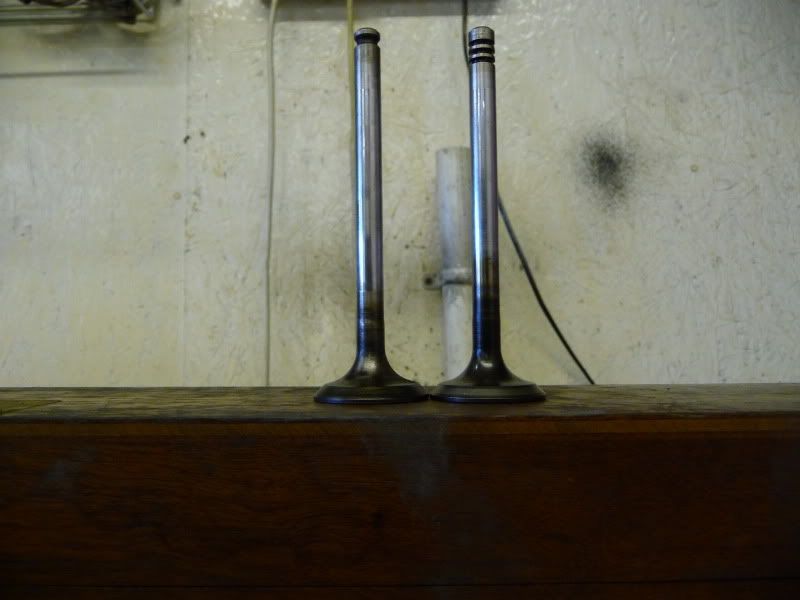

Also when the later 87-88 heads are all put together the top of the valve sticks up higher above the spring retainer.

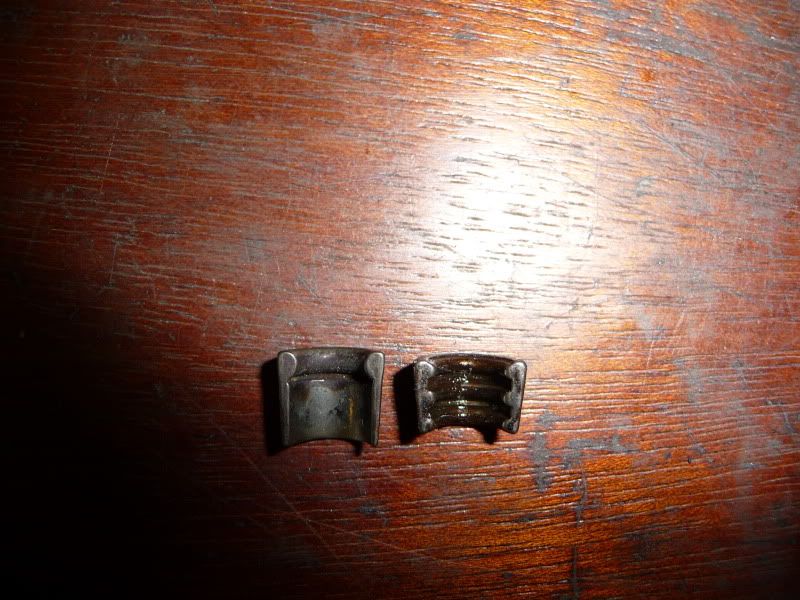

Also on the 1985 heads valves they only have a single groove for the collets to lock into where as the later heads have 3 grooves for the collets to lock into.
The design of the heads of the valves are also slightly different which will also affect the flow in and out of the engine.

There were 2 different turbo valve designs AFAIK, one had a longer stem. But all turbo valves should have the double retainers. You may have an injected NA head. or someone may have fitted different valves at one stage. All heads should have the same valve spacing too.

The valve head is the same size but the back of the valve head is a slightly different design.

The spring retainers are also different, and like mentioned above so are the collets and the mounting grooves in the top of the valve for the collets.

Ok here are some pics.
All the numbers on the front of the heads are the same except for a 1988 head that i have? (not pictured)
Also the pic of the exhaust valves is a bit crap but there is a difference in the head design of the valve,not quite sure about inlet valves maybe a very slight difference.
The 1985 head parts are always on the left the other head is a 1987.

Inlet valves
Exhaust valves
Collets
