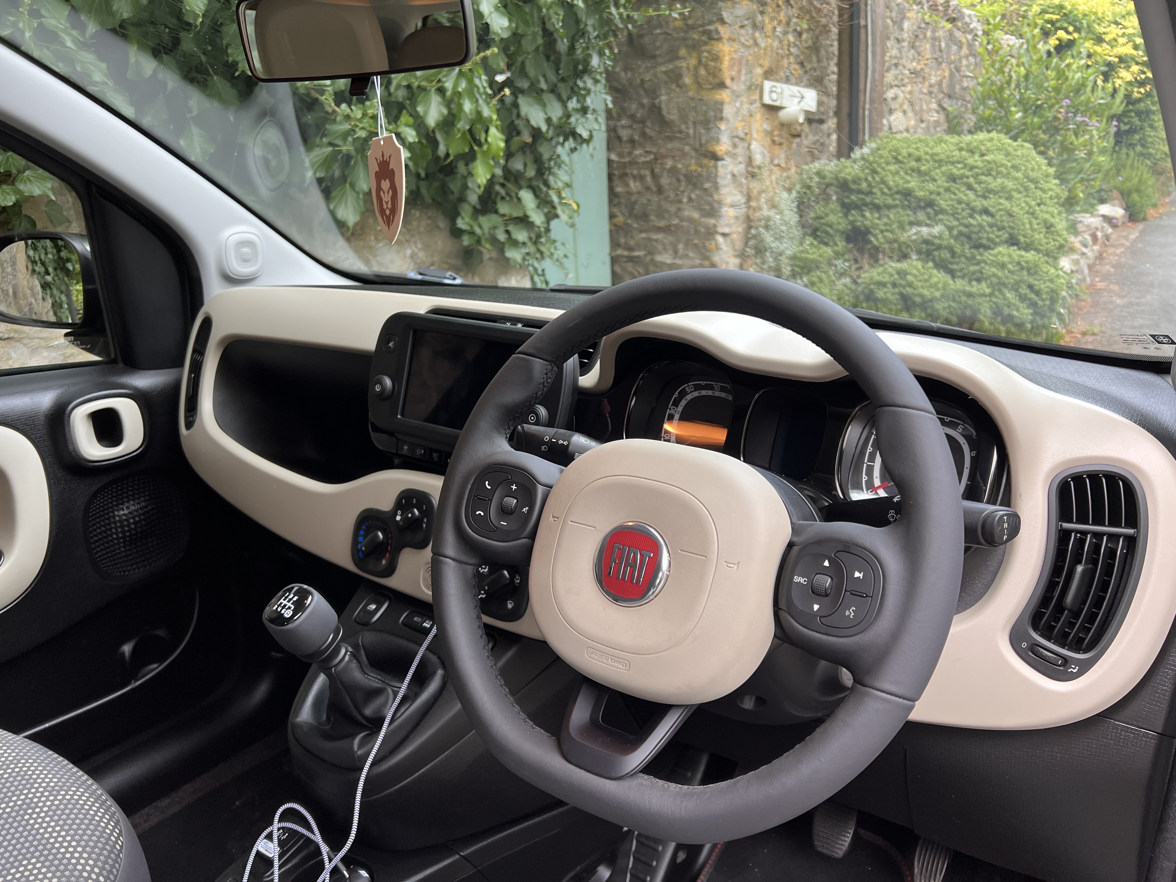

All interior upgrades now complete. The only difficult one was the steering wheel because I struggled getting the old air bag off.
Jobs done:
New leather steering wheel
New leather gear knob
Install of Uconnect 7 inch OEM
It feels like a totally different car!

The car play is an OEM unit and only has wired CarPlay but I’m happy with that because it charges my phone at the same time:)

The car interior looks fantastic can I ask was the stereo plug and play or was it coded were all the plugs the same even the Ariel
The stereo was completely plug and play and the connectors were exactly the same as the original. I purchased an additional DAB Ariel and GPS antenna (both had plug sockets on the back of the new stereo) and they were self adhesive and I just stuck them inside the dash. They were just off Amazon. The original Ariel plugged into the new stereo as well and gives me the FM signal, although I find with the luxury of DAB that is all I’m using and considering I stuck it inside the dashboard the signal is perfect. Not dropped out once.
Nothing needed to be coded. The new stereo did come with a code but it never asked me to enter it when I installed it. And no flashing odometer which I was expecting.
The only bit I haven't yet done is the microphone. The 7inch uconnect does not come with an integrated microphone. You can buy one with the stereo as an extra but I want to use the original integrated microphone that is in my light cluster. I need to unplug it from my old blue and me module and pull the wires back up to the dash and connect to the new stereo. I do have a diagram of where it needs to be connected and it’s just two wires so should be pretty simple. I’m going to save that for a rainy day because I rarely take calls in the car anyway.
If you are not fussed about a microphone then the rest of the job is 100% plug and play. No adaptions needed, no wiring stuff. Literally unplugged the old one and plugged in the new one and it just worked. It took me about 3 minutes. I don’t think you can beat this unit. It has no lag, it’s responsive, everything works and it’s genuine fiat. Apple car play is seamless as soon as you plug your phone in, it just works.

No I bought it off Facebook direct from Italy. Here is my other post with the Facebook link https://www.fiatforum.com/threads/new-head-unit-on-2013.510574/#post-4764001
I would like to replace my rear lights with those as well. You can buy them direct from Italy too on the same Facebook page. I got everything off there. Pays to try a few different sellers as they sometimes vary in price
