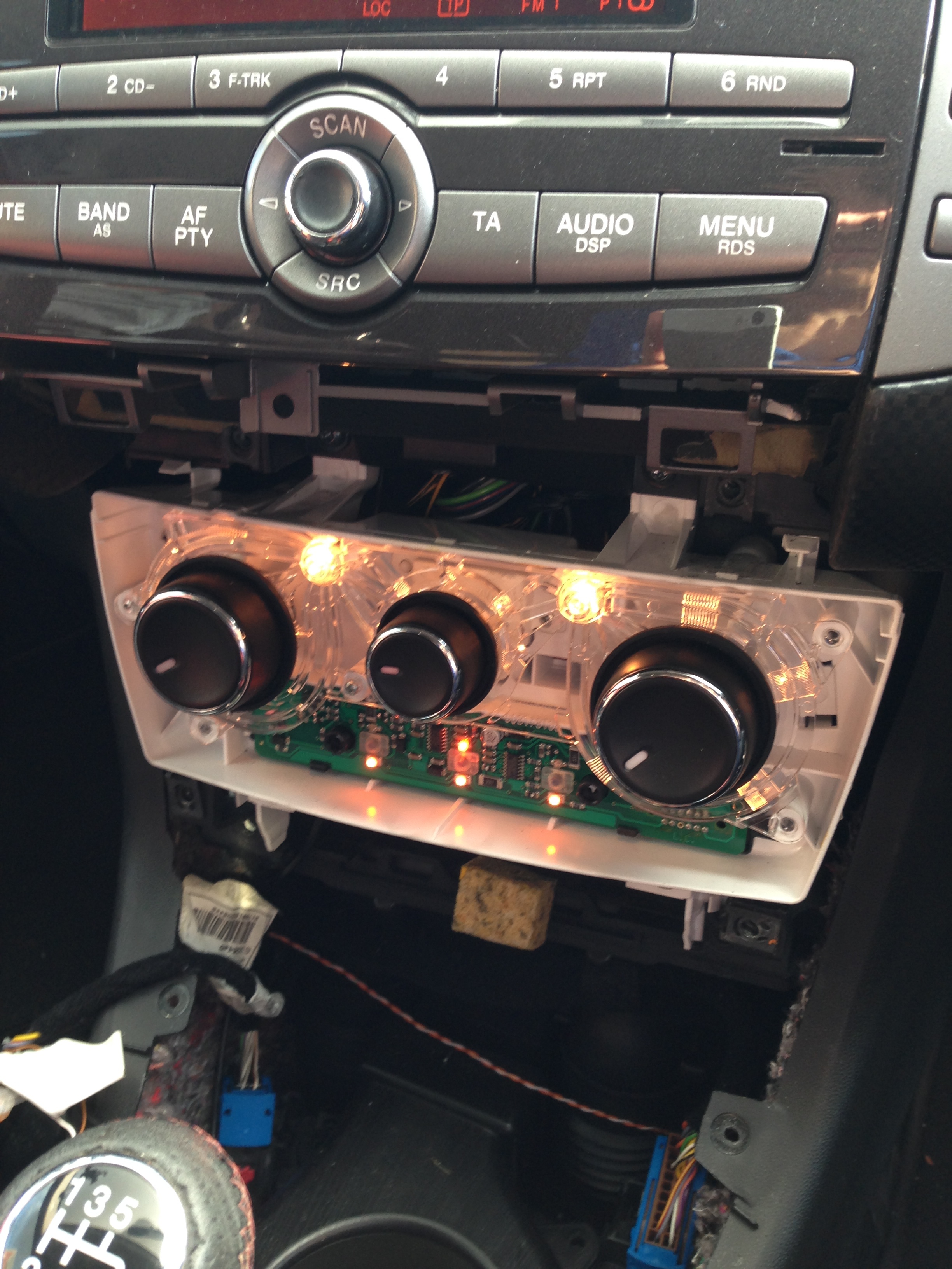

Hi mate ,can i ask how u removed the heater controls for the bulbs ,mine are gone ,i tried a while ago ,had everything above them and everything below them removed ,car in pieces and still couldnt get to them , thanks
Course you can its actually easy once you know how to do it basically you take the panels off thats between the radio and heater control panel then pop the gearstick gaitor off and unscrew the carbon effect surround then unscrew the cigarette lighter tray and then unscrew the heater panel and change the bulbs then just do the reverse to refit it all again :)
Cheers for that , i think thats what i did last time but couldnt get the heater controls out ,think theres clips or something holding it in and i think my controls might be riveted in not screwed ,was there rivets when you done yours, cheers
No problemo mate and nope no rivets just screws t25 torx to be precise and yip once all screws are out then just at the top theres 2 white clips jst push down on them and tilt the controls out

Two tiny little bulbs, not sure what they are, heres a pic:
Theres like an orange film then which im gonna change to red if i can.
Then there's 3 orange LEDs on a PCB for the aircon, recycled air and rear heated windows
If that's what you're asking.
