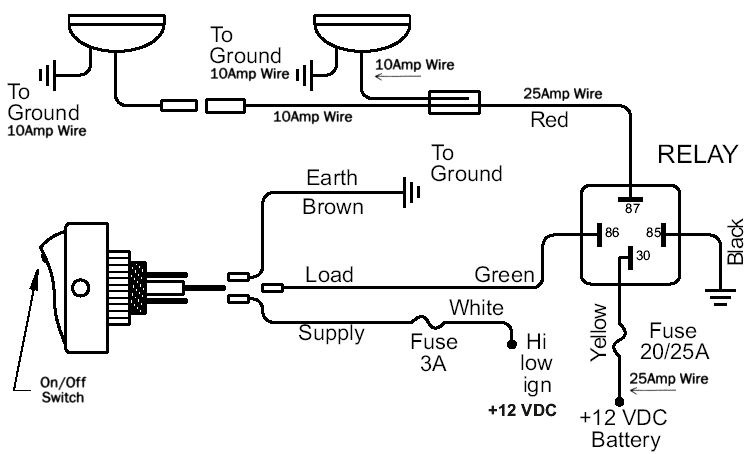

Hi i have no experiance of the 500 but basic wiring principles will apply
its "only" 21 watt im not sure on the wiring harness and capacity so would play it safe and power it from a automotive relay
Pin 30 is fused (+) supply from the Battery
Pin 85 is Ground (-)
Pin 86 Is live supply from switch (your fog light live via a switch)
pin 87 is To the reversing light
this shows a diagram for front fog lights but its essentially the same all you need to remember is you need a smaller fuse
http://www.offroaders.com/info/tech-corner/reading/relay-diagram.gif
so what you will need to do is
locate the relay near your fuse box run a fused live supply to it..... (pin 30)
locate the live supply from the side light circuit (the wire that powers the parking lights on the left of the car) and tap into it using a scotch lock or solder a wire to it, and run to where you are having your switch, From the switch you need to connect this to the relay (pin 86) (you in the UK must have a light telling you the fog lamp is turned on) so the switch will have a 3rd connection to Ground to power this light when turned on
connect Pin 85 to ground
run a wire from 87 to the back of the car and connect to the (+) terminal of the fog lamp and connect the other side of the lamp to ground
hope that helps :)
for 21 watt single bulb you should get away with a 5A fuse
