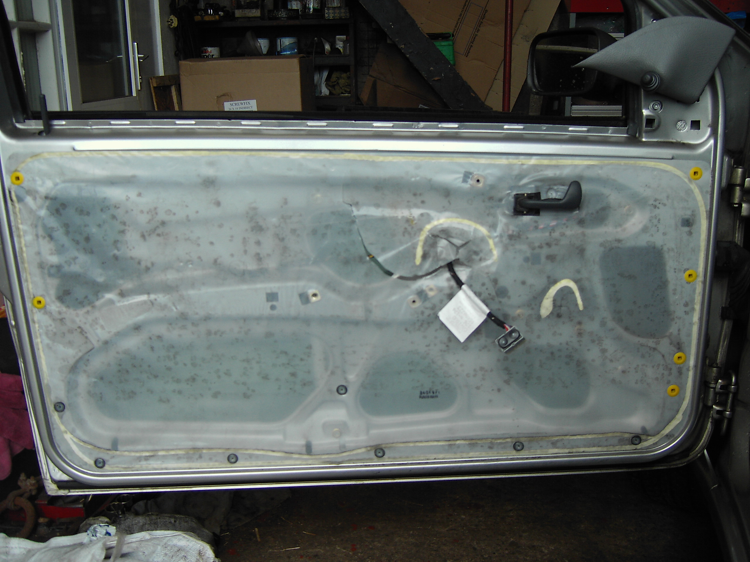

well this is what you will see at least on the passenger side, drivers side will be much the same, its a common problem for the passenger side to go, the runner are a pretty naff design (one) and you can hardly get in at them -
With mine the mylon runner at the bootom of the window was worn so i jammed jum stuff under the side closest to the window to level it out and then just lubricated the window seals with sme silicone base spray, this makes les work for the motor and it goes up and down a hell of alot easier
Note - when taking the door card off, ensure that the little plastic wing mirror adjuster piece is out of the way incase yu accidently crack it.
