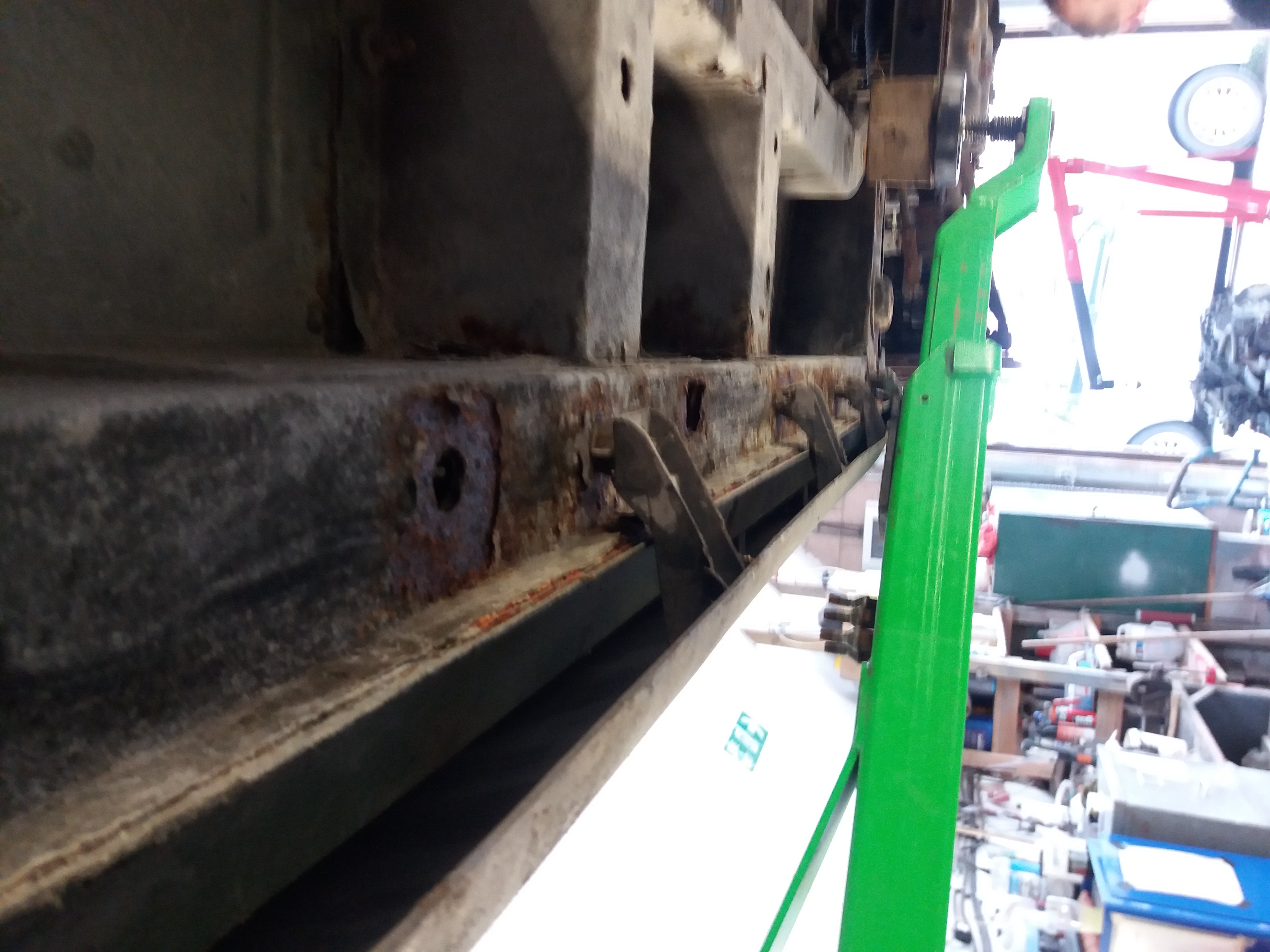

The worst part of the car seems to be the under side of the outer sills where the plastic sill covers bolt to and the handbrake cable bracket at the back - these are nearly rusted through the full length especially where the sill mounts and existing body holes are. doesn't look like a massive welding/panel fabrication job but just wondering if anyone knows if you can buy prefabricated sections? otherwise it all looks pretty solid.

Pictures of the sill corrosion, called it inner sill but its really the outer chassis box section. Shouldn't be a major job I hope!?

Two years later and its still on the road, got some steel sections and mate welded it up, lots of cavity protection sprayed in after. Rest of body work doesn't seem to suffer any corrosion issues, 20 years old and still going.
