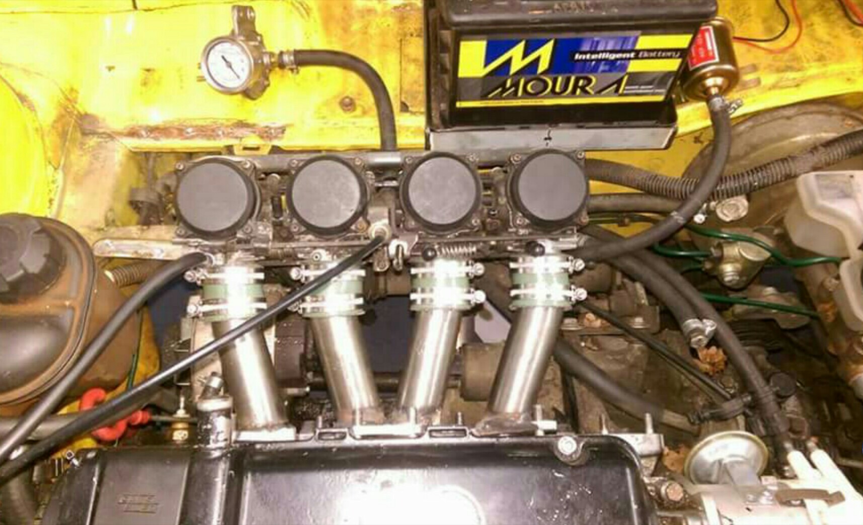

Hi, yes I've fabricated my own inlet manifold to fit bike carbs on my Cinq.
1200 bike carbs will be far to big, look for 34mm carbs from a 400.
Ah wow! Thanks for the pics, guys!
So I spoke with a company called 'Bogg Brothers Fabrication'.
They've also told me to buy K5/6 GSXR750 bodies, rail & loom and they'll fabricate a manifold based on the gasket.
The Jixer bodies will enable them to keep the manifold short so I don't have to loose the heater shroud.
Will probably go Emerald for the ECU and pop in an aftermarket fuel pump to the spec of the bike injectors.
