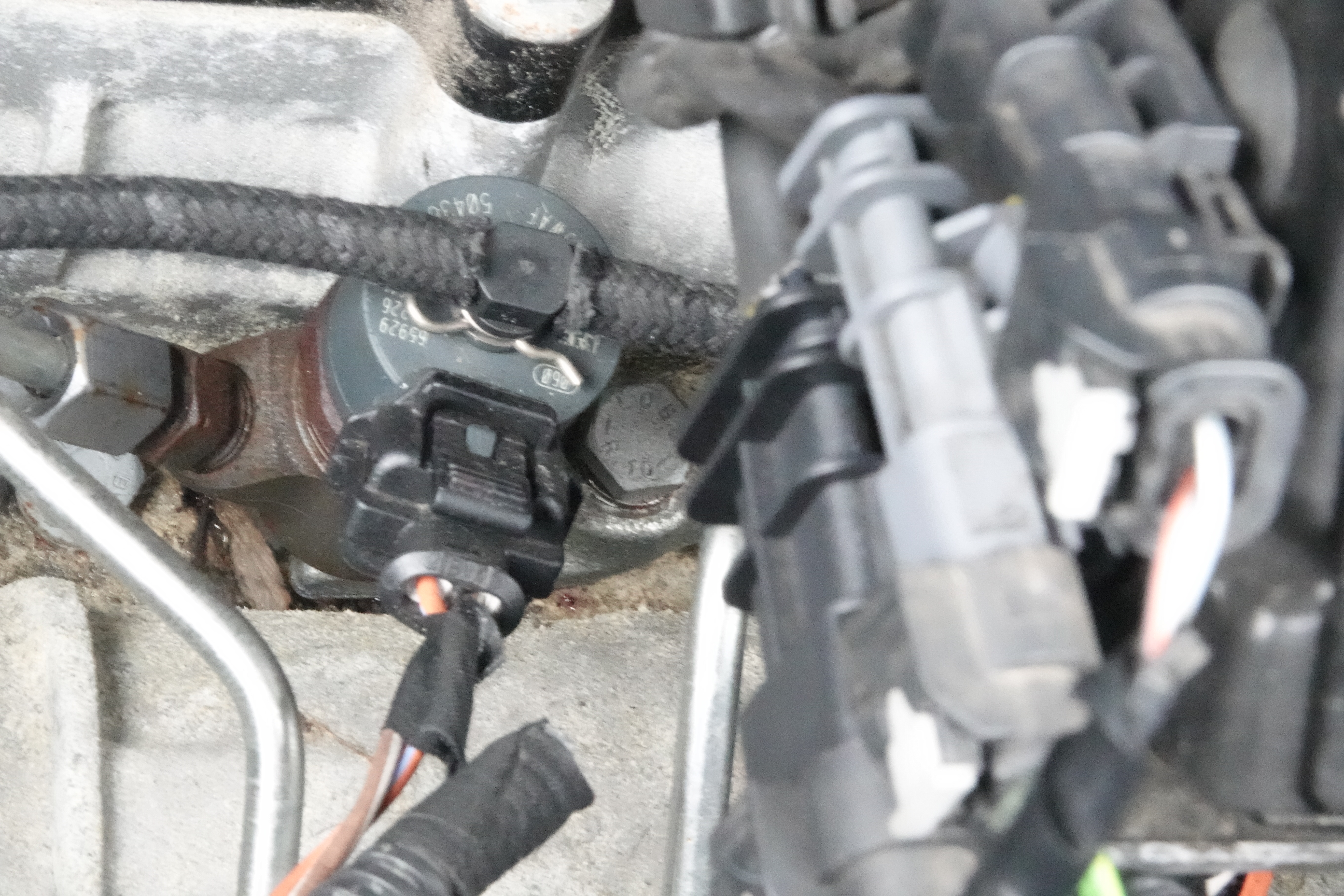

A while back i did a leak off test and decided that i will renew one injector. Since then ive read all sorts of gloom and doom about replaceing injectors.
Here's offending injector. Do i apply plus gas or any expensive penetrating fluid first (24 hr wait) seen one on amazon £30 a bottle is this required/ advised.
Is there a specific puller reccomended? or type to be avoided. Its a Motorhome and not really used in winter just monthly 30mile warm up. so im not in a great hurry. is it just the one bolt in centre holding the clamp down. should i take van for a run before adding releasing fluid? what is typical cost if done by a diesel specialist?
