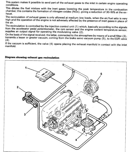

first thing to do is check your pipe arrangement agrees with the attached image.
then check each pipe for blockages or leaks.

I removed the pipes last night and blow and sucked through them, and found no noticeable blockages or leaks.
Then I removed the Borg Warner value and blow and sucked through it and gave it a good shake.
I noticed that the small connection at the bottom of the unit that sucks in air is missing a filter.
After reassembly the car is running better with no warning light and the unit appears to be turning on and off at tick over when I rev it.
The only thing is it still sucks in air when I turn the engine off, I guess this is normal as there is still some vacuum left.
To hazard a guess, the filter has come off the Borg Warner and been sucking in dirty air and getting clogged up. So I think I will get another Borg Warner with filter and put that on.
