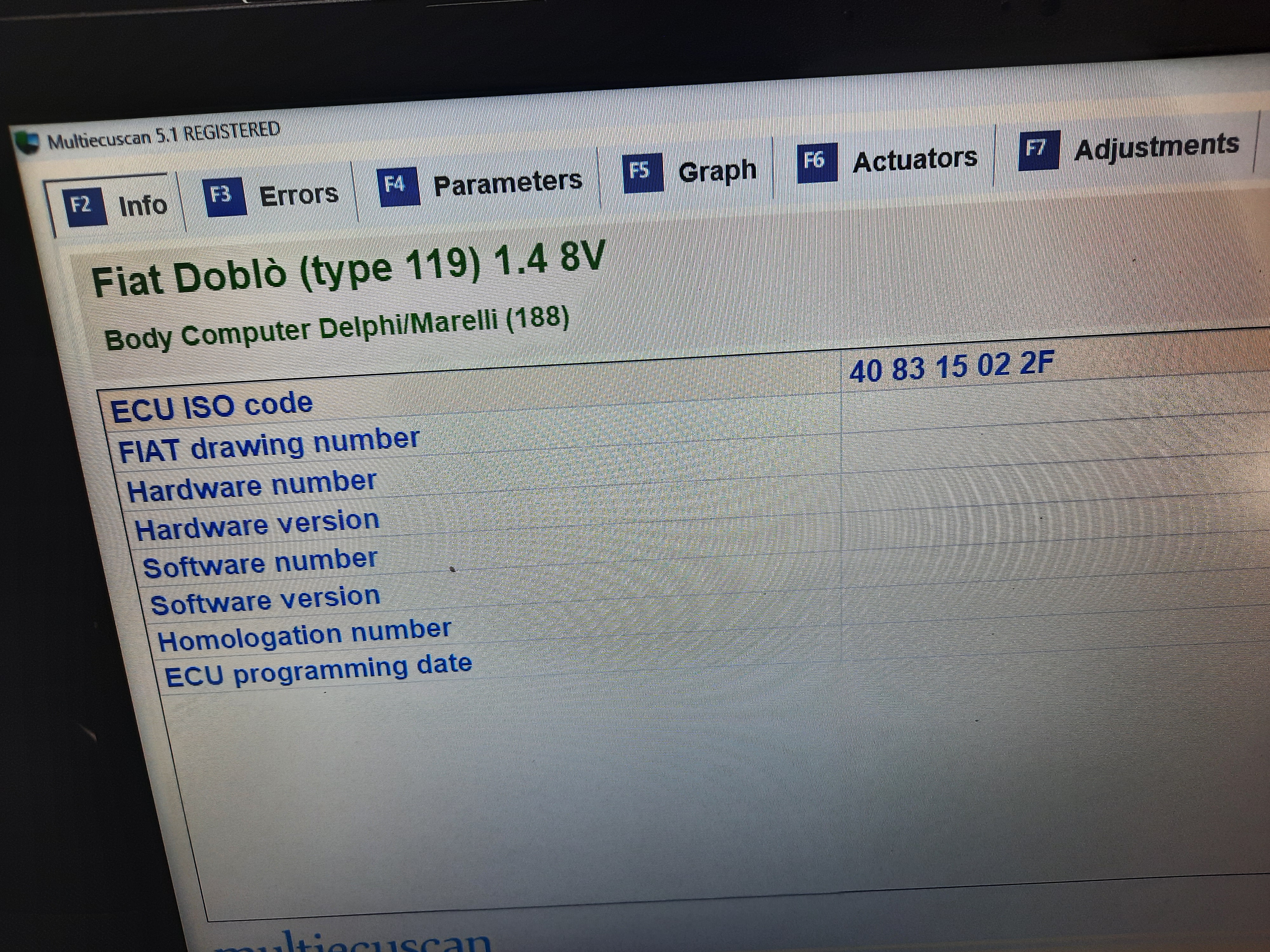

Bought multieuscan and all that came up was u1601 on the body computer, Can bus error.
Interestingly no software info or any other information apart from iso number shown.Attached pic. Also unable to connect to engine ecu.

I think that communicating with the ECU is paramount. If the ECU and BCM cannot communicate, how are they going to interchange messages and allow the BCM, which has recognised your key, to unlock the ECU?

Thinking the body computer as engine ecu is refurbishid/cloned. Also the fact that no software or programme data is showing when multieuscan plugged into body computer.
