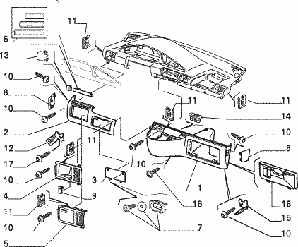

ok remove the screws holding the keypad in and with the engine running thats running very important pull the connector from the rear if i remember there all black and in one strip the unit is now disconected ,there is a little cubby hole you can get from fiat that fits in the hole where the unit was i paid £10 for mine about 4 years ago .the reason a lot of people disconect it is with opening and closing it causes the wires to brake causing a visit to fiat and ££££££££££££££££££:eek: (y)
exloded view i hope left hand drive but you get the idea
