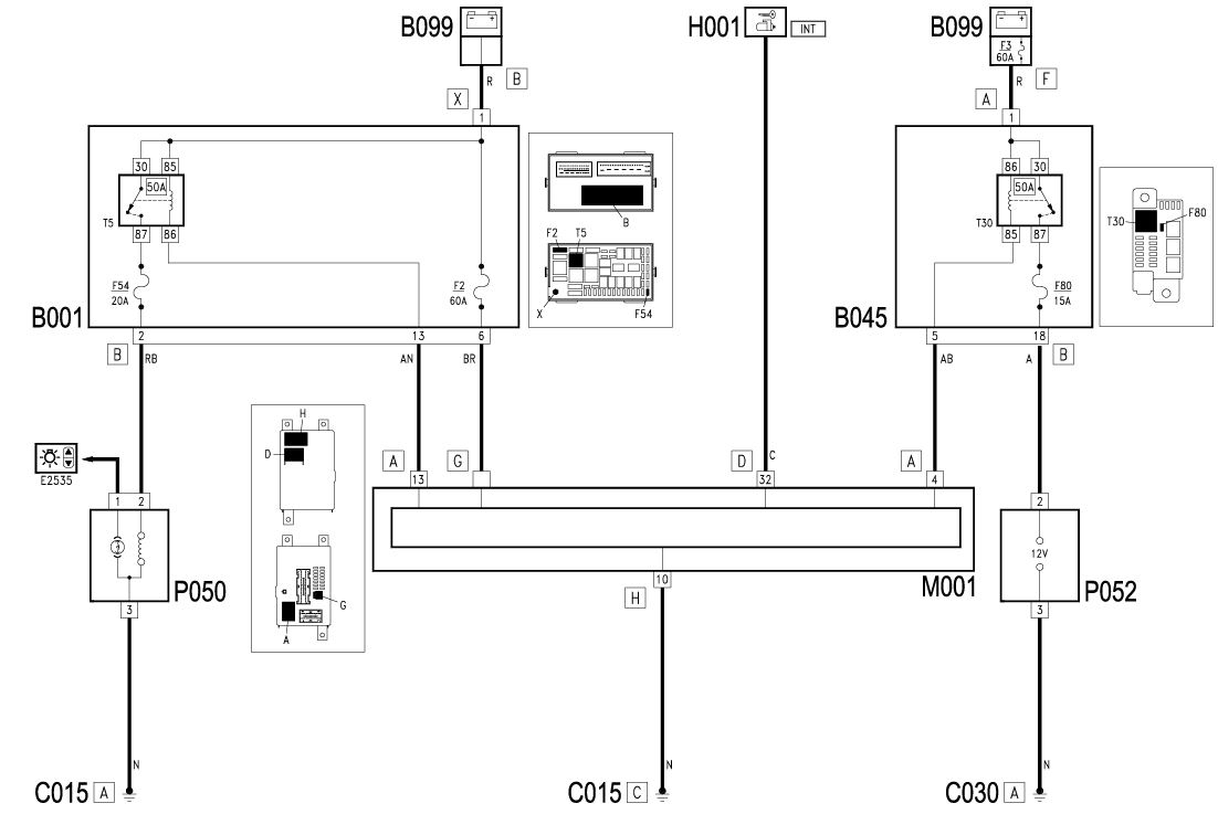

I've been looking for an ignition on fuse to tap into for a dash cam. It doesn't help that Fiat think my fuse box is on the other side of the car, but regardless. I've been poking around with a meter and I've yet to find a suitable fuse to tap into.
I didn't want to run all the way to the 12v socket if I could get away with it as the glove compartment seems ideally located to hide away the adapter, has anyone managed to power a dashcam from the fuse box in the glove compartment?

I'm coming round to this being the best solution. Just frustrating when there's an entire fuse box there but no suitable circuit :mad:
Is the best method to trace the wiring back from the cigarette lighter and then tap into it somewhere under the dashboard?
Here's the related drawing,
as one can see the cigarette lighter P050 is powered via Fuse 54 by RB (Rosso/Bianco = Red/White) wire, when contact is ON ...

Bernie, I am once again in your debt, please add it to my tab :p I have forgotten most of what I ever knew about electric diagrams but I hopefully remember enough not to fry myself... I think fuse 50 may be hidden away somewhere, it's not in the glove box so it's definitely a wiring job.

Hola Mattyo,
you're right it's not in the glove box ; fuse 50 is located in B001, which is the engine bay distribution box...
BTW: one should NEVER connect wires by 'tape' method ! The best is to cut, stripe, solder and insulate (shrink tube BEFORE welding).
If you can't do soldering, use a 'derivator' : kind of plastic stuff you'd crimp on the existing wire AND the wire to your new device...
